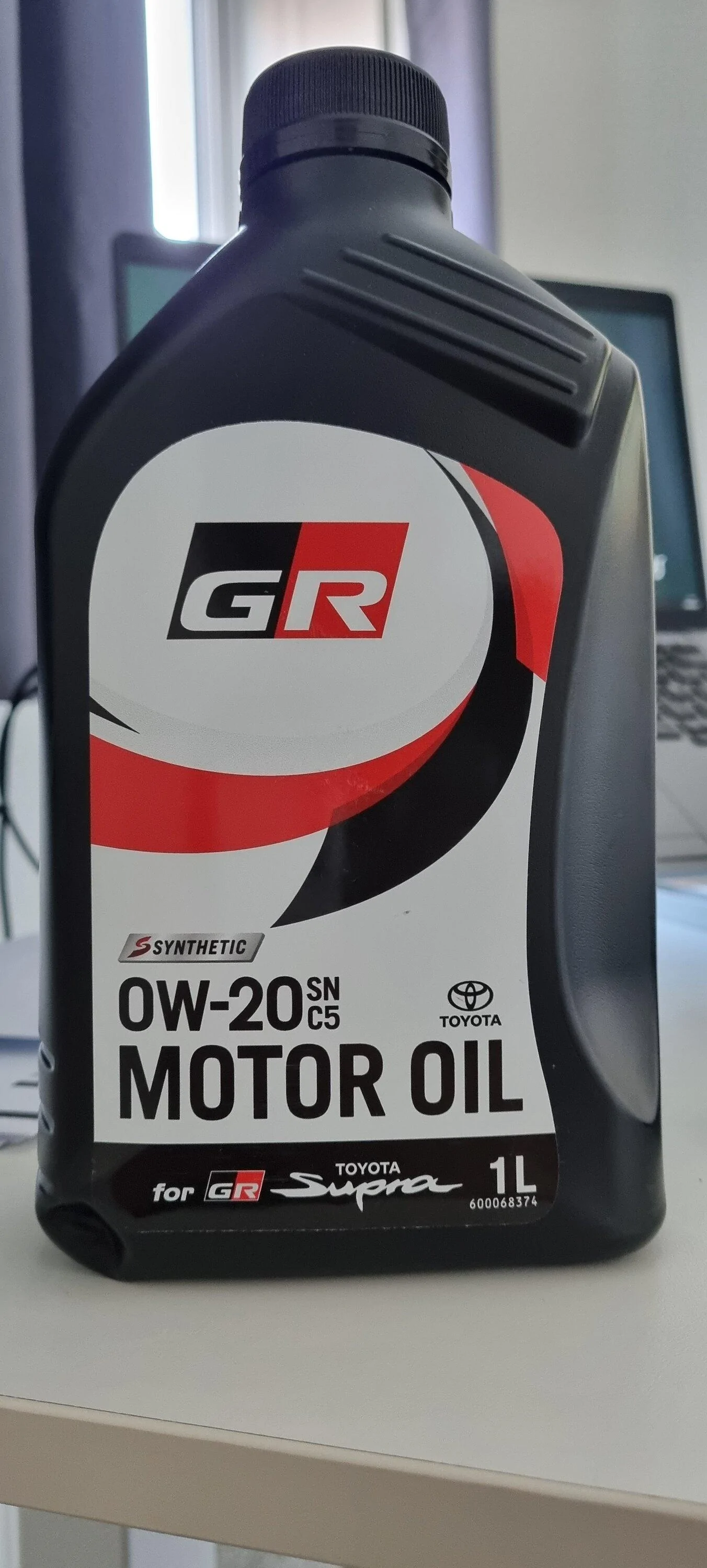

Hi everyone,
my 2022 3.0 Supra is due for oil change. It is all stock at the moment and was wondering what oil is everyone recommending I should use. I currently work at BMW dealership would anyone recommend the OW 20 they use here?
would greatly appreciate feedback and recommendations!

Oil should be thin as possible, and thick as necessary. For street driving, I would stick with the factory GR 0W-20. For the the track, I would switch to a 0W-40 or 5W-40.
In the grand scheme of things, SN Plus or higher is more important.

Iā€™m just so confused about the oil to put Iā€™ve had my Supra serviced at Toyota and had to top off after a month or so. I daily drive my Supra in California I currently only have catback exhaust do i switch over to Liqi Molly 5W40?
If you daily/street and have no special requirements or extreme weather, just stick to manufacturer's and you can't go wrong, see my photo post above šŸ‘šŸ»
