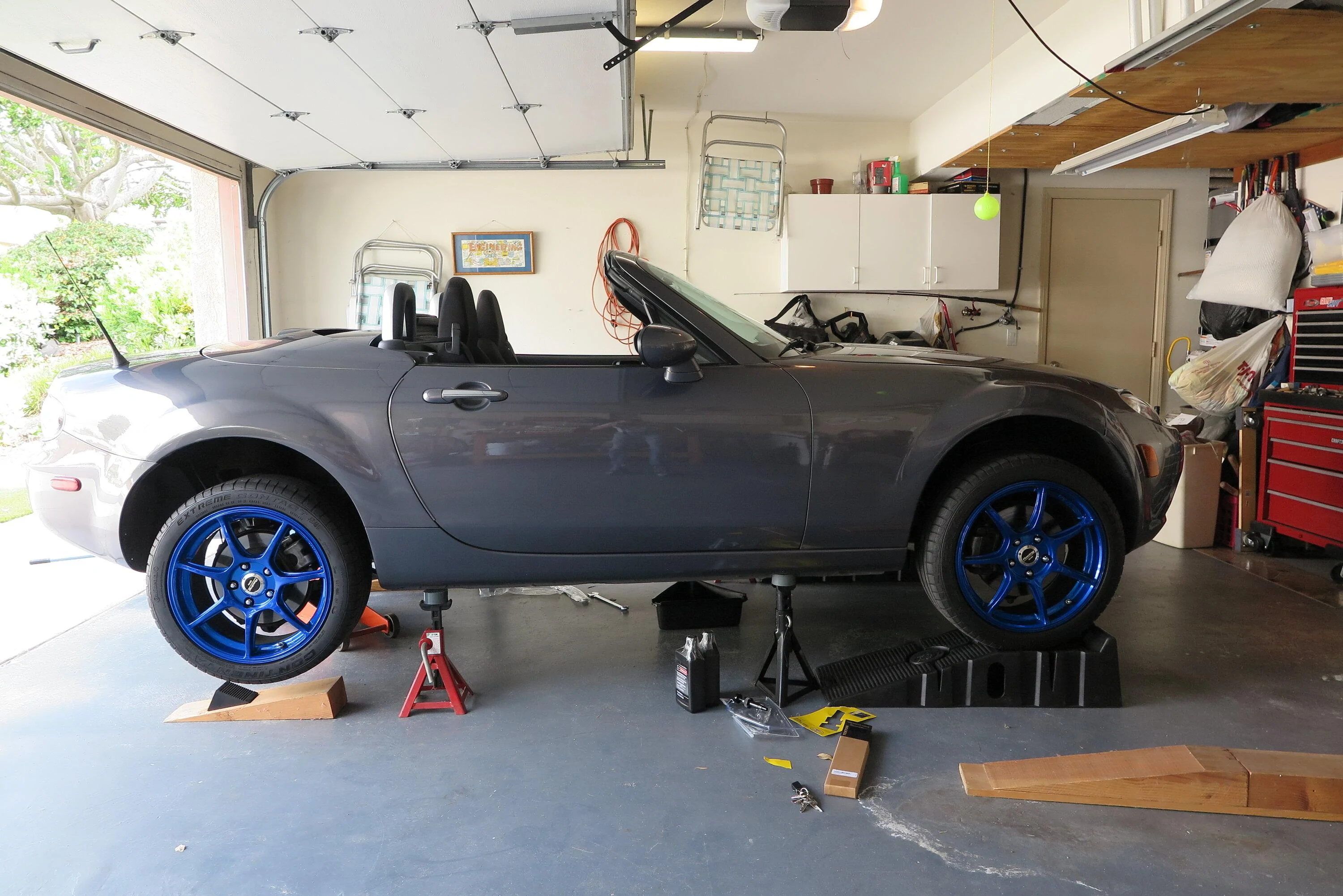

When I changed my C5's oil and MX5's transmission and diff fluids, I'd drive up on homemade wooden ramps, then use my hydraulic floor jack to raise the front, then rear. Rhino ramps were placed under the front tires, and jack stands, front and rear. The HFJ was left at the rear as a backup.
