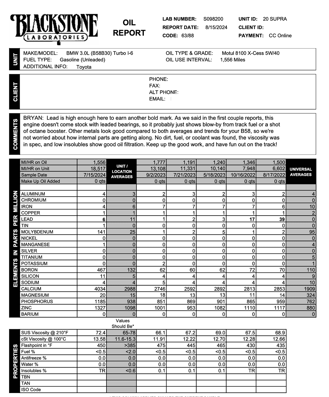

Soooo....how often do you change your oil? I'm also gonna guess that you send yours in for lab anslysis? I should've figured you'd run eBlend.
8,817
17,303
My Supra I use mainly for track although I do drive to/from all tracks and also drive it on the street for pleasure drives and datalogging/tuning.
My last test at the end of last year is after 5 track days with some of those events seeing 270F oil temps. The test in 2024 I just had done had 5 track days.
All of these are on E30-E40 and since the beginning of 2023 the car was running 470-520whp or so, depending on what map I was using.
The lead spikes are from using 100 octane in the E40 mix at some tracks. I noticed a trend that VP 100 has some lead in it, either the actual fuel or the tank had leaded gas in it at some point

The first thing I looked at was what kind of oil and the viscosity you use. Thanks for the data points.
