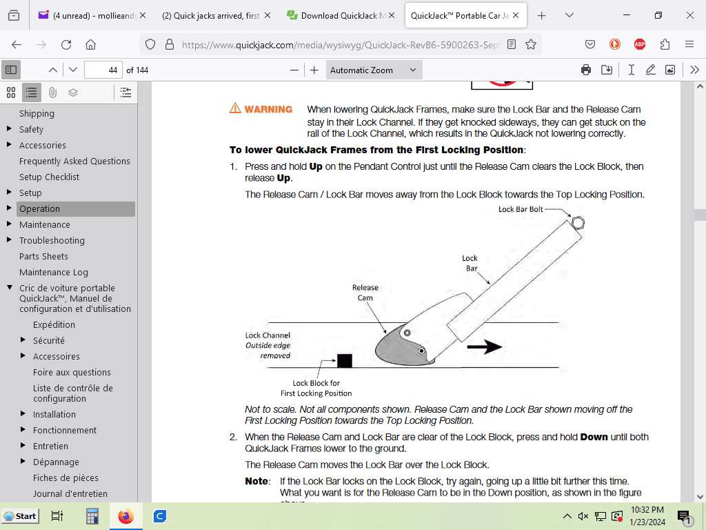

You need to lift the locking bar when lifted to its maximum height only. On the lower height pushing the raise button to slightly raise the vehicle and then pushing the down button lowers it.
If yours does this something is seriously wrong. You should always have to reverse the locking mechanism before it will lower. That’s the whole point of mechanical locks.
8,675
17,007
on the lower lock, if you raise it the lock bar flips the lock mechanism and then if you lower it can lower all the way. It is by design. Try it out.
I can make a video too if it doesn’t make sense.
Perhaps you should read the instructions.
Interesting. Perhaps I’m doing something wrong then. When I raise it from the lower locked position it does not flip the mechanism. I have to physically flip them every time before I can lower it. Unfortunately I’ll probably forget about this thread before I need to use them again but if I do remember I’ll play around with it and see if I can get it to do this.
? Great reply! I actually did but I may not have caught this and at my age asking me to remember what I read close to three years ago is a losing proposition. And besides, when I raise mine from the lower locked position it does not flip the mechanism and I’m fine with that.
Well then, as you put it, "There is something seriously wrong.", with yours, or you are not doing it correctly.
And no one asked you to remember what you read close to three years ago. But if your memory is not reliable when dealing with something as serious as a 3,400lbs car on jacks, you probably should not be giving incorrect advice.
My advice was to purchase the 7000 model instead of the 5000. What I was incorrect about was an observation. My apologies.
