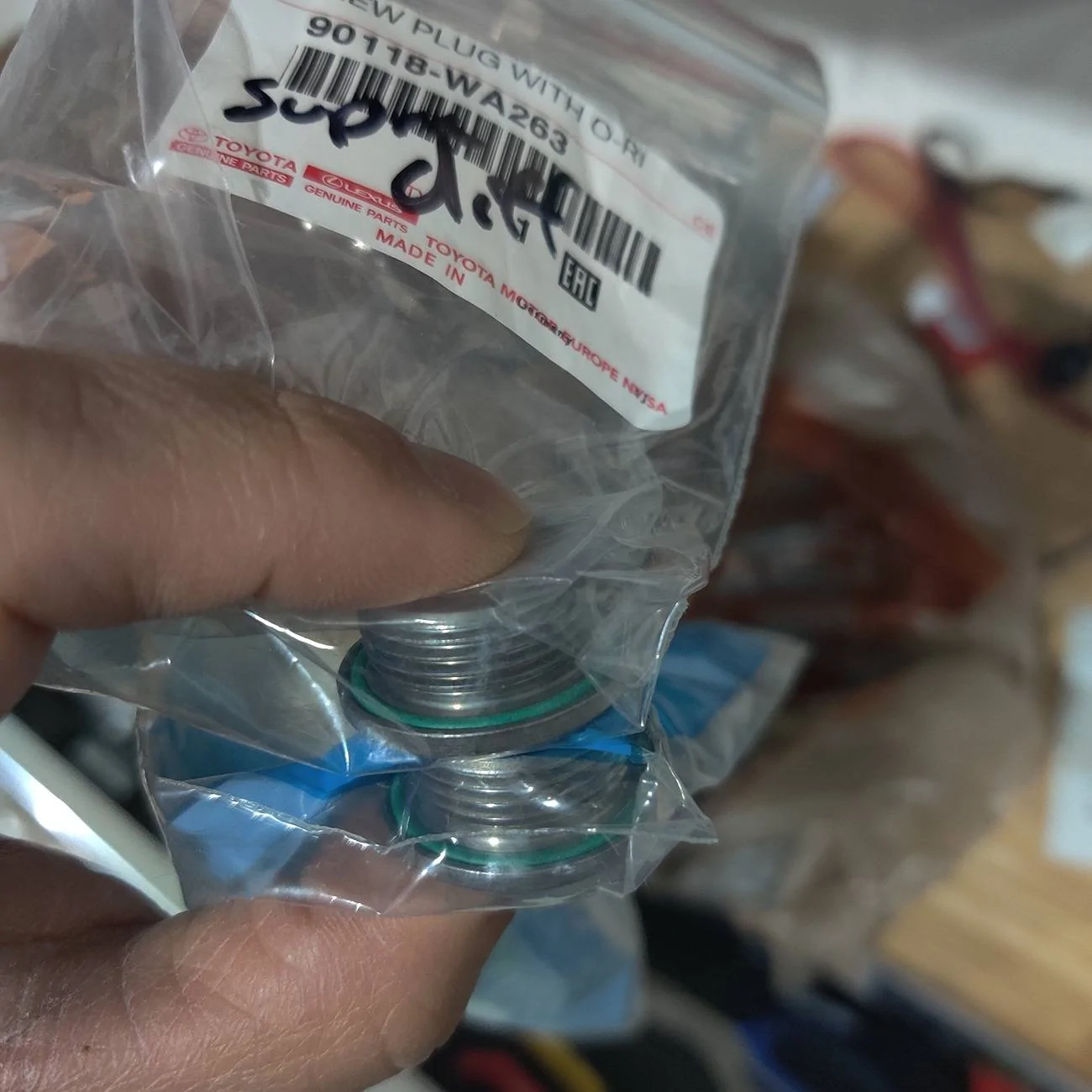

Any chance you know the size of the crush washer needed for the drain plug?
Setoville
Andrew
Jan 1, 2024
San Jose, CA
2022 Toyota Supra 3.0 Premium
I don't remember the exact size, sorry. I just compared the existing crush washer against the kit I have here:
https://www.amazon.com/maierke-Aluminum-Assortment-Automotive-Washers/dp/B0DC9YMCLT
If I were to do it again, though, I would just buy the diff drain plug for $3.85 and have the peace of mind. "Screw Plug with O - RI".
https://parts.lakelandtoyota.com/p/toyota__GR-Supra/Differential-Drain-Plug/16070765/90118WA263.html
i3igpete
May 16, 2022
48
1,325
1,623
Chicago
2023 3.0L 8AT

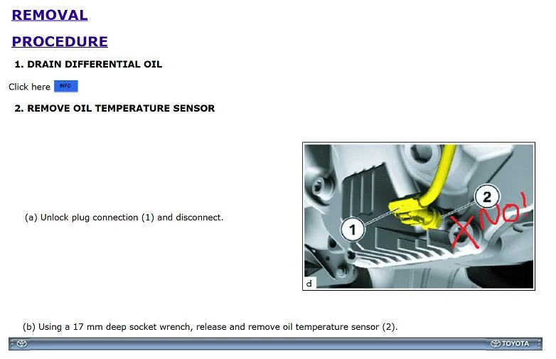

Out of curiosity, I ordered both the Toyota 90118-WA263 "Screw plug with o-ri" and BMW 33117525064 "Differential Drain/Fill Plug". Both of them came with a pre-installed o-ring, and neither of them had a crush washer. ?‍♂
8,775
17,216
I think he was talking about the sensor, which is also the drain plug. It has a washer but it's captive, so not sure why he added two washers.
The big fill plug you bought have an o-ring built in. Which is why it's good to change it out for a new plug each time.

Oh I'm dumb, I thought the diff cover bolt in the service manual screenshot was a drain bolt this whole time.
8,775
17,216
Hahah would make it easier. Getting that plug off the sensor is always such a pain in the ass. I've done it five times already and I still swear each time. lol

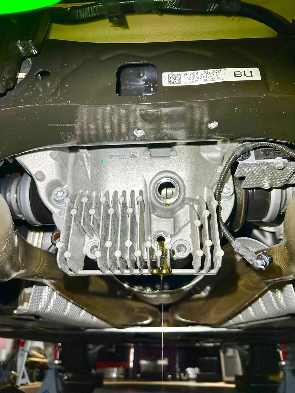

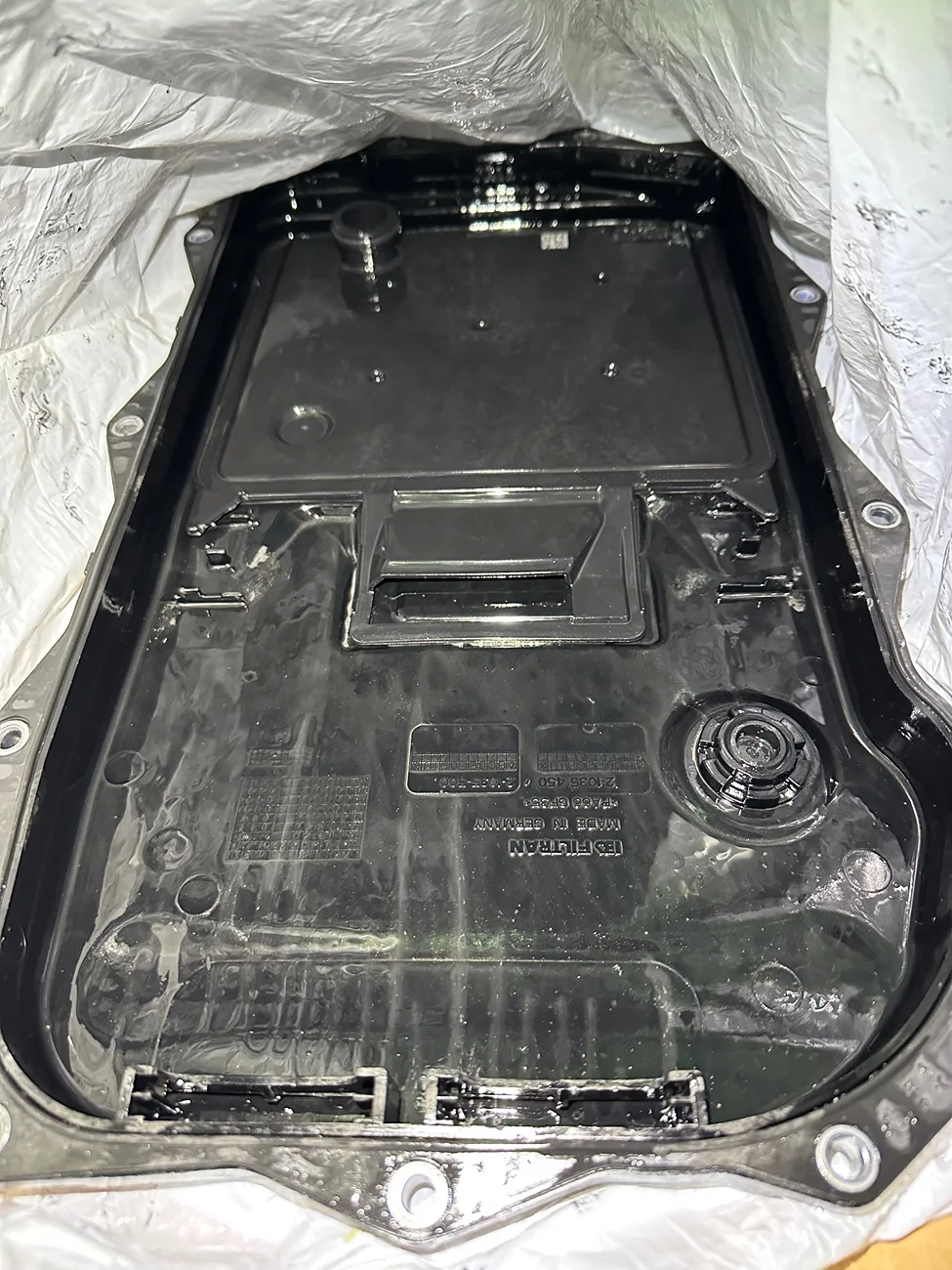

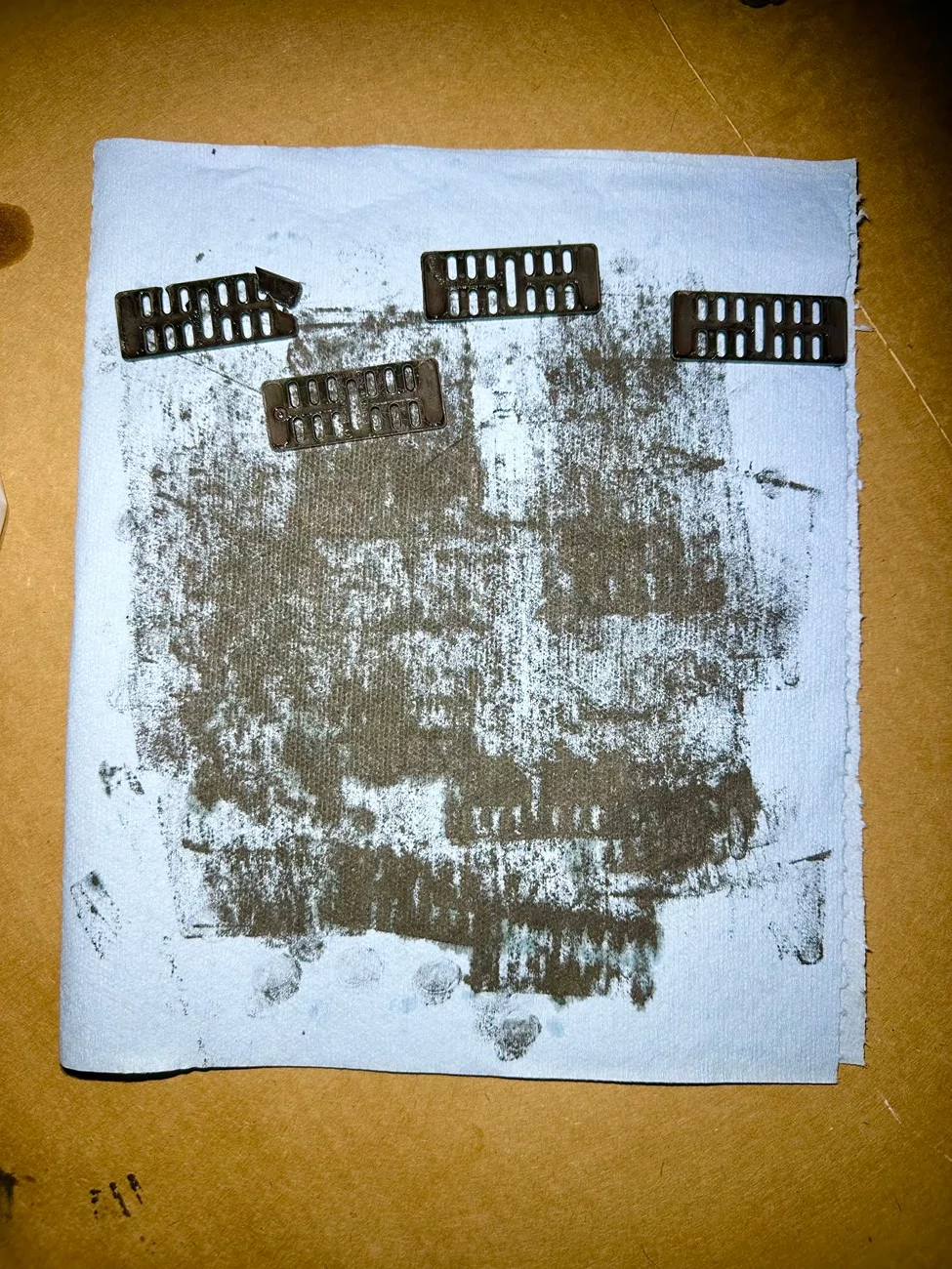

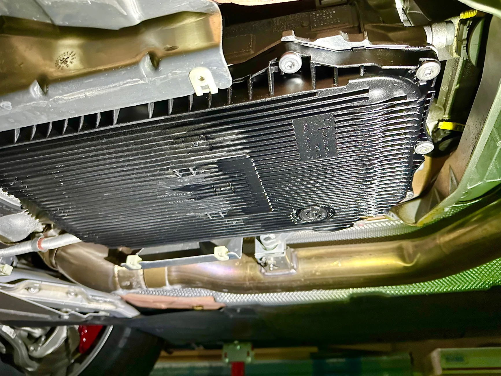

Here is my contribution to the thread. I recently changed my differential and transmission fluid @12k miles.
The differential fluid wasn’t bad overall but it was darker and had particles floating in it.
The transmission had more wear than I would have thought for only 12K miles. The 4 magnets were coated with metal and the bottom of the pan had metal sludge.
Also the pan was leaking as several have noted on the forum. It appeared to be coming from the fill plug. It must have vibrates loose after 4 years. I removed 6.2 L and filled 6.3 L so I was missing about 100mL from the leak.
