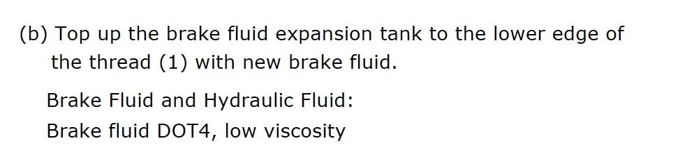

Since our brake fluid is DOT 4 higher temp fluid, that should be changed at minimum every 3 years. I like Castrol’s SRF brake fluid. I know it’s a lot of money for brake fluid. But love knowing its boiling point is higher than most other DOT 4 fluid’s dry boiling points. I don’t do that on our other cars, since we shouldn’t be threshold braking in town on a repeated/regular basis, lol.

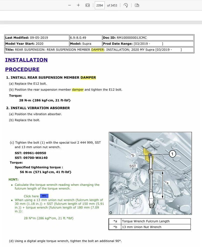

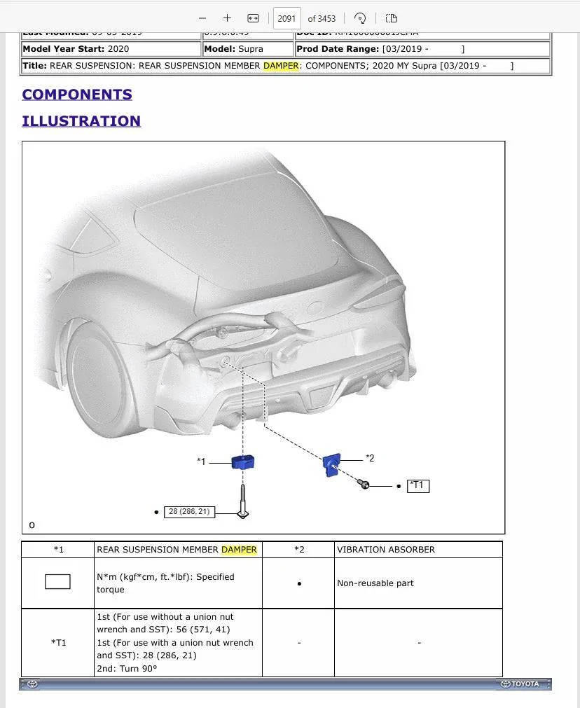

What are you guys doing for the bolt that holds that damper which is in the way of getting to the plugs in the diff? Looks to be 28Nm / 21 ft lbs, but says to replace it (there's a dot by it in one image, and step a for getting it back together says to replace it). I find that odd. No way it's stretched or anything.
Elsewhere I'd mentioned that the rear subframe bolts didn't get replaced on BMW's but the Supra manual said they should be. Toyota seems to love to replace bolts?

These days the "replacement required" isn't necessarily because of TTY considerations but because the std bolt comes with a thread locker already applied from the factory. In other words the manufacturer doesn't trust the dealer techs to apply thread locker or the correct thread locker.
