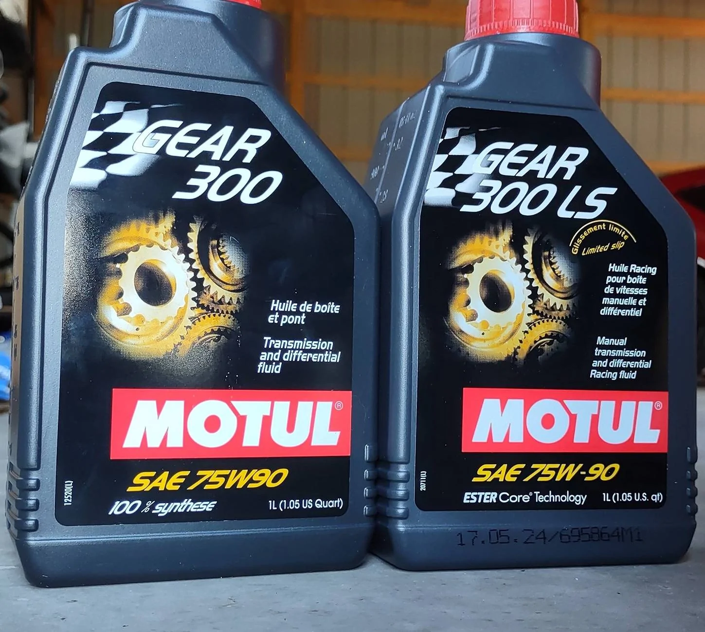

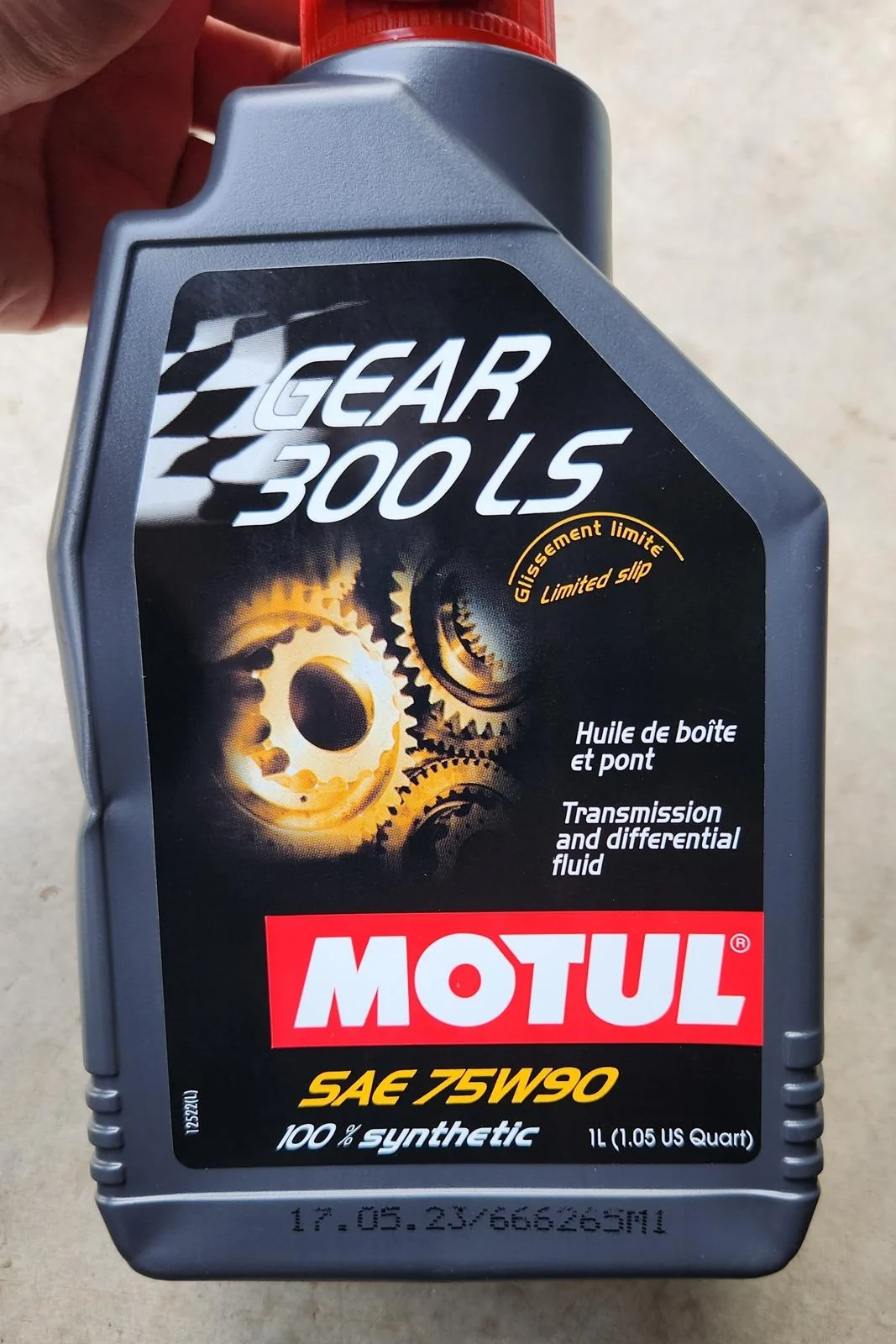

Motul 300 75W90 has two versions, the regular 300 (105777) and the 300 LS (105778). Which one do we use?
Motul's website recommends the 300 LS for the Supra. However, the 300 LS is a GL5 while the regular 300 is GL4/GL5.

Should I use this one?
The LS version is for Limited Slip diffs. I'm suspecting it's for the old/original style LSD's to prevent the chatter some used to have and speced an oil additive in addition to the base oil. I'd go with the std 75w90 for the Supra style electronically controlled diff but I'm open to other views on it.

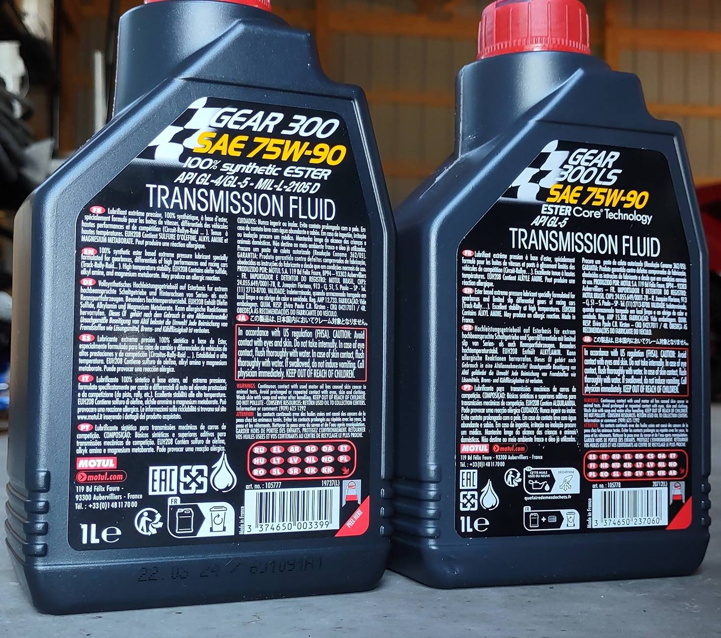

Is anyone more familiar with fluid API standards able to answer this question? Both fluids are GL-5 rated so I assume either will be okay, but are the extra ratings on the GEAR 300 (non LS) beneficial?
I am guessing the "MIL" would be a military specification. Possibly a higher change interval.
Yup. It’s U.S. military specs for gear lubricants. So they can meet certain performance requirements set by the military, allowing them to sell to a bigger market, as long as the testing is done. Smart on their part.
The extra specs on the NON-LS aren't beneficial for your diff, and generally the LS additive is never a bad thing to have in any differential with a clutch pack (whether dynamically or electronically activated). Plus, the GL-4 rating on the NON-LS points to it having less Extreme Pressure additives, which is definitely a negative. If it were me, I'd use the 300 LS.
