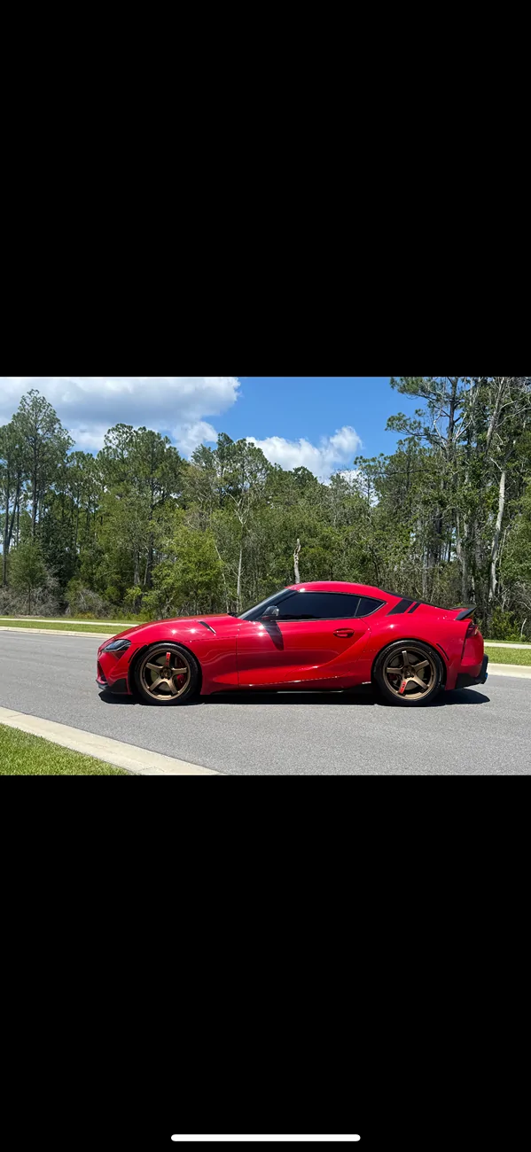

Hey guys do you think I’d be able to fit these tire specs on my soup?
Michelin ps4s
Front: 265/35/19
Rear: 285/35/19
Im on hks adjustable lowering springs and 13mm front and 15mm rear spacers, Will I rub?
Below, is a picture of my car right now with Goodyear eagle exhilarate tires,
255/35/19 - 275/35/19

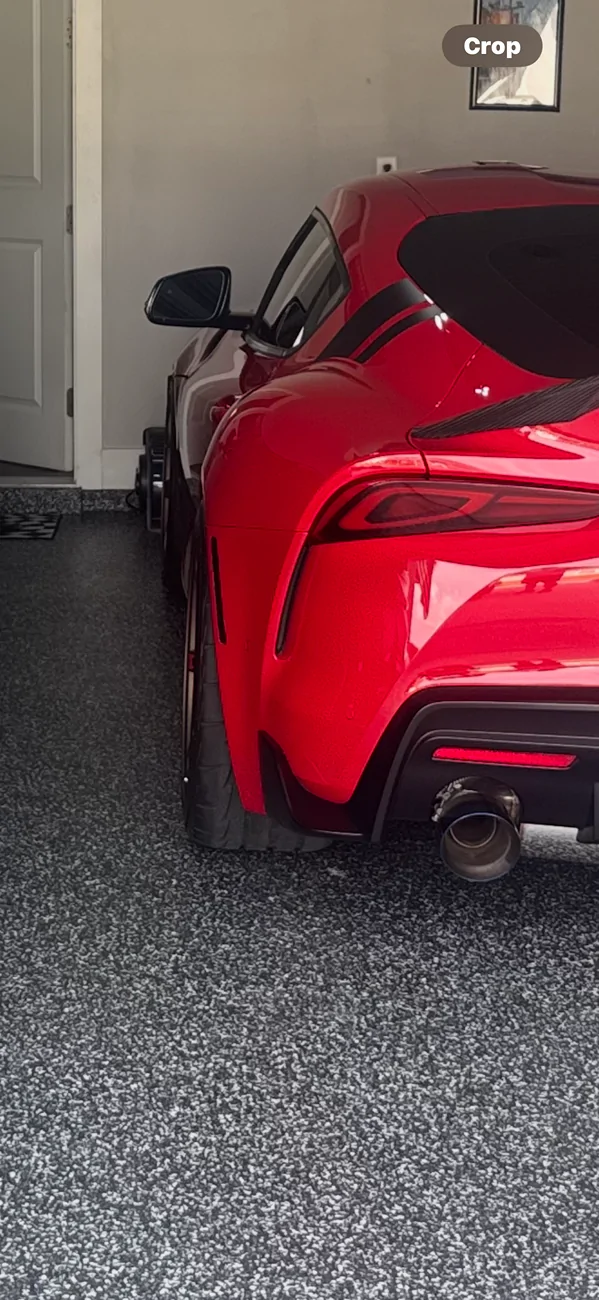

I have the same spacers but H&R lowering springs and I just put 285s no problem on rear.
Just put 285s on as well with H&R springs and get rubbing under heavy compression. Gonna try 10mm spacer in rear. Kumho Ecsta Sport S.

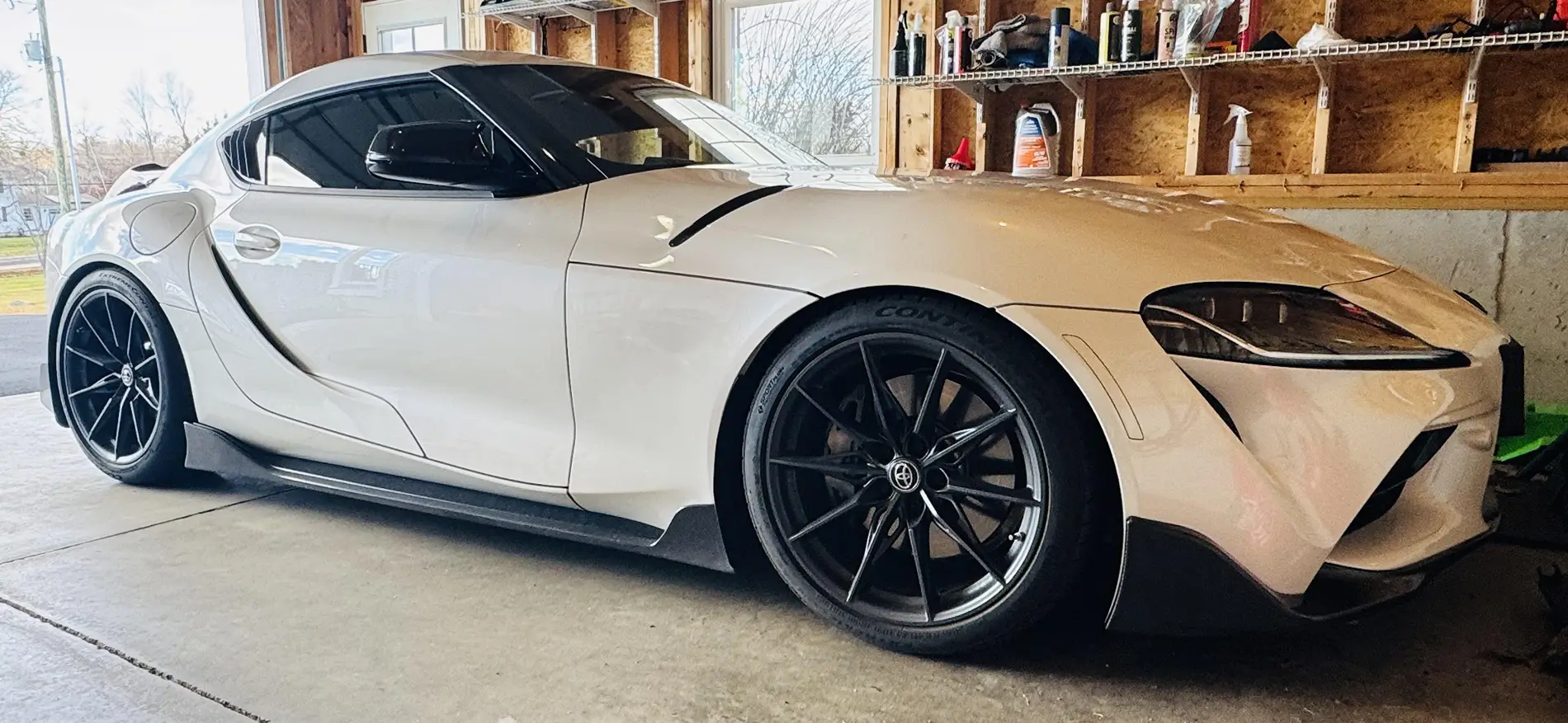

Whiteline, 13/15mm, OEM tire size
