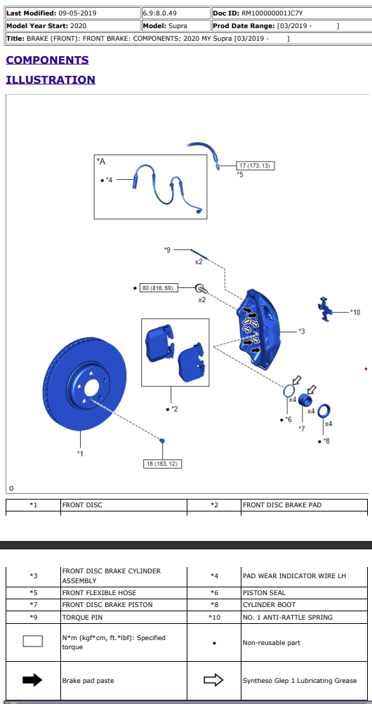

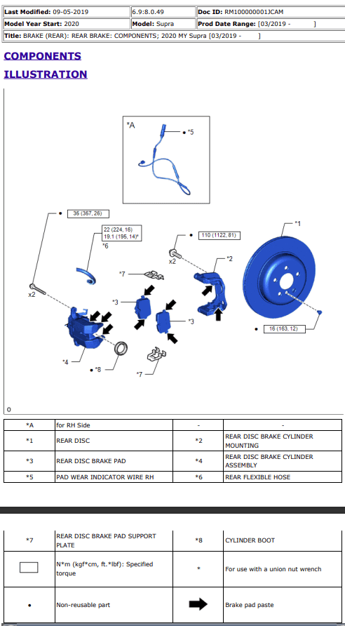

Torque specs for front and rear brake rotors / assemblys
