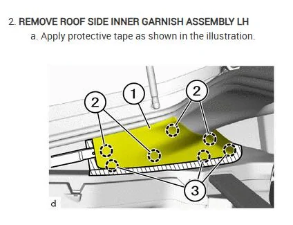

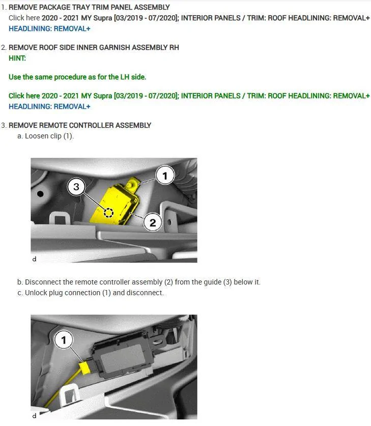

Anyone know where the tpms receiving antenna is?
Gabe
Gabriel
Feb 19, 2024
676
1,237
Miami
Passenger side quarter panel. I am on the phone. But at home I have the maintenance manual will get you a screenshot

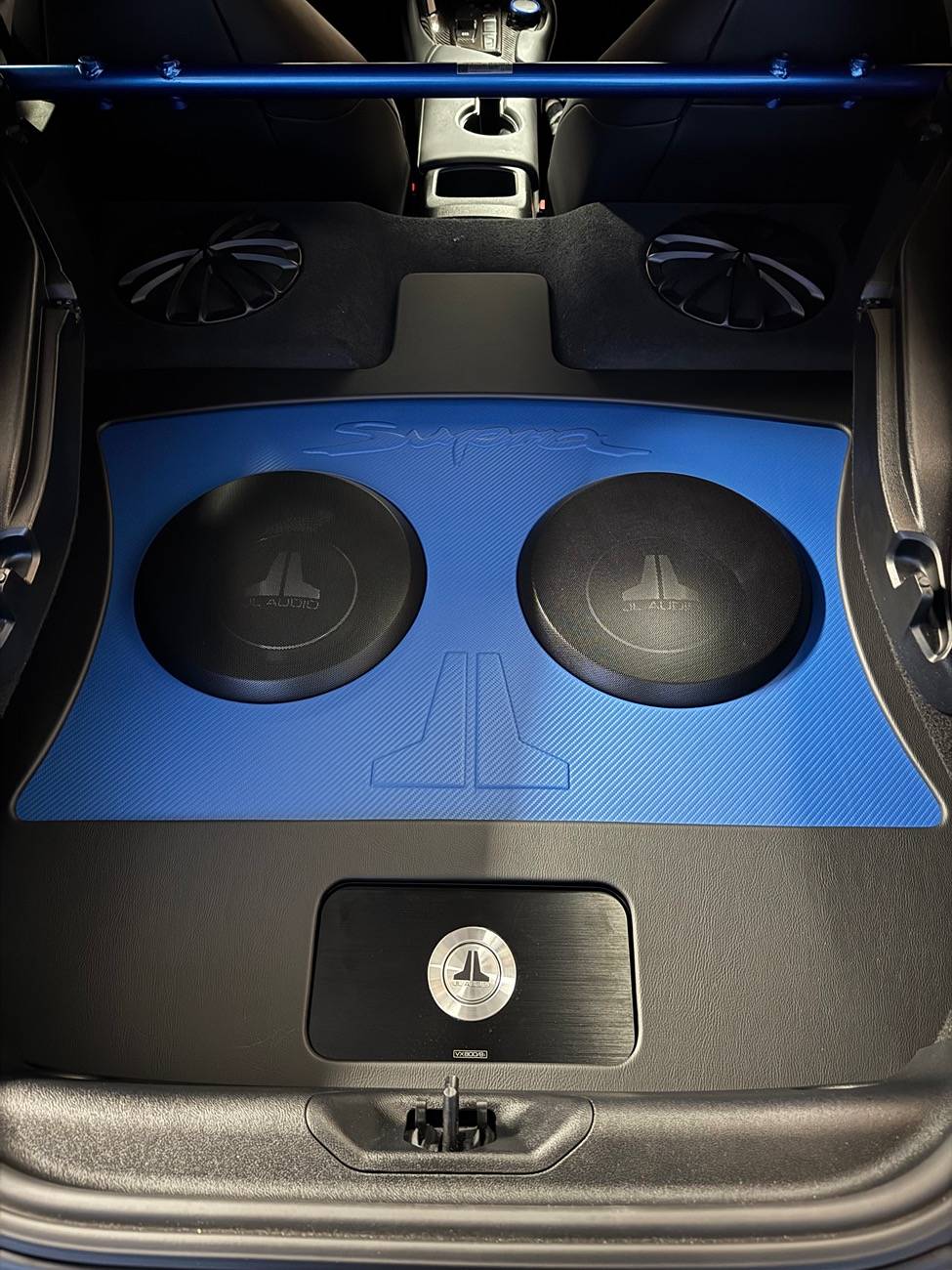

did you have this info, after installing a new sound system my TPMS will no longer connect to the tires stays in malfunction and when I try to reset stays at 0% thinking it's blocking the signal or possibly got disconnected.

Thank you!
NP and my loading screen was frozen so I fixed it and got rid of the extra 3 pictures it loaded. Also realized it didn't have a picture of the interior piece in question and added that as well (it only shows left hand piece but obviously it's the right hand side)

awesome, again appreciated. We did a custom install and my TPMS stopped working and the key FOB signal is terrible. Going to relocate the FOB receiver as it’s under my subs so I’m sure that’s the issue but not sure why TPMS stopped working maybe got unplugged by mistake.
