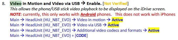

I know this thread is old, but I'll post this anyways, I managed to get the video in motion to work perfectly, you need to use BIMMERCODE (needs a paid license) to code in the function as it is turned off by default. You also need to enable the "Additional video codecs and formats." for the part where it "only works with android phones" it is referring to the video in motion VIA the screen mirroring feature, as iPhones do not allow this due to (I assume) carplay.

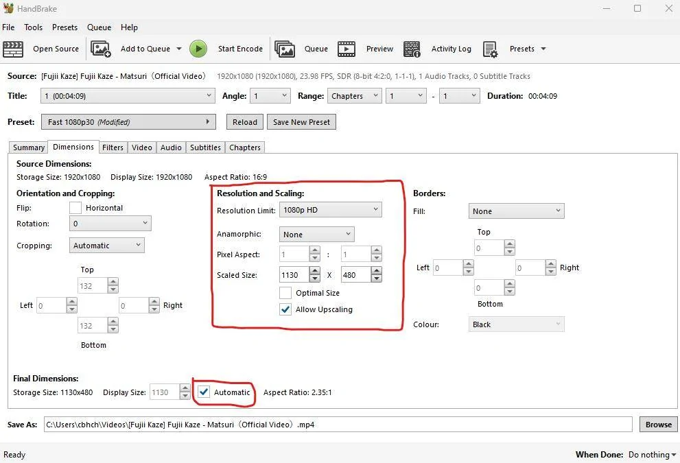

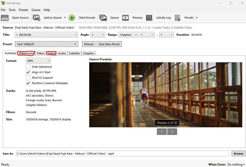

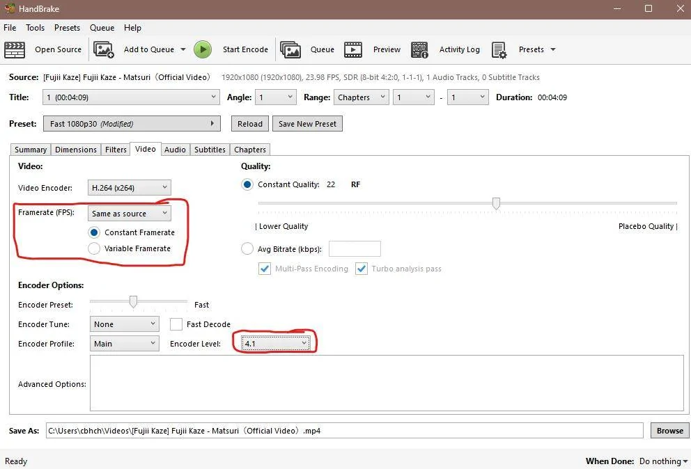

Like Jediyogi said, (IF YOU ARE USING A USB) they need to be video files in x264 codec, and 480p resolution. You can use a free software called handbrake to encode the video files.

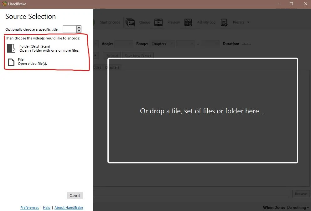

Just copy these settings and export it onto a USB stick. For the dimensions, only put in the 480p on the right hand side, and then just click on the left bar and it will automatically input the number required for the same aspect ratio.
