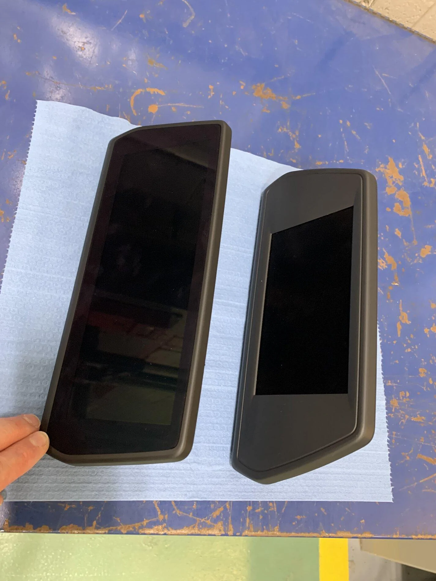

Yeah I’ve seen it somewhere on here (hence the photo i saved, it caught my eye) Toyota was silly for putting that small screen in

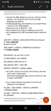

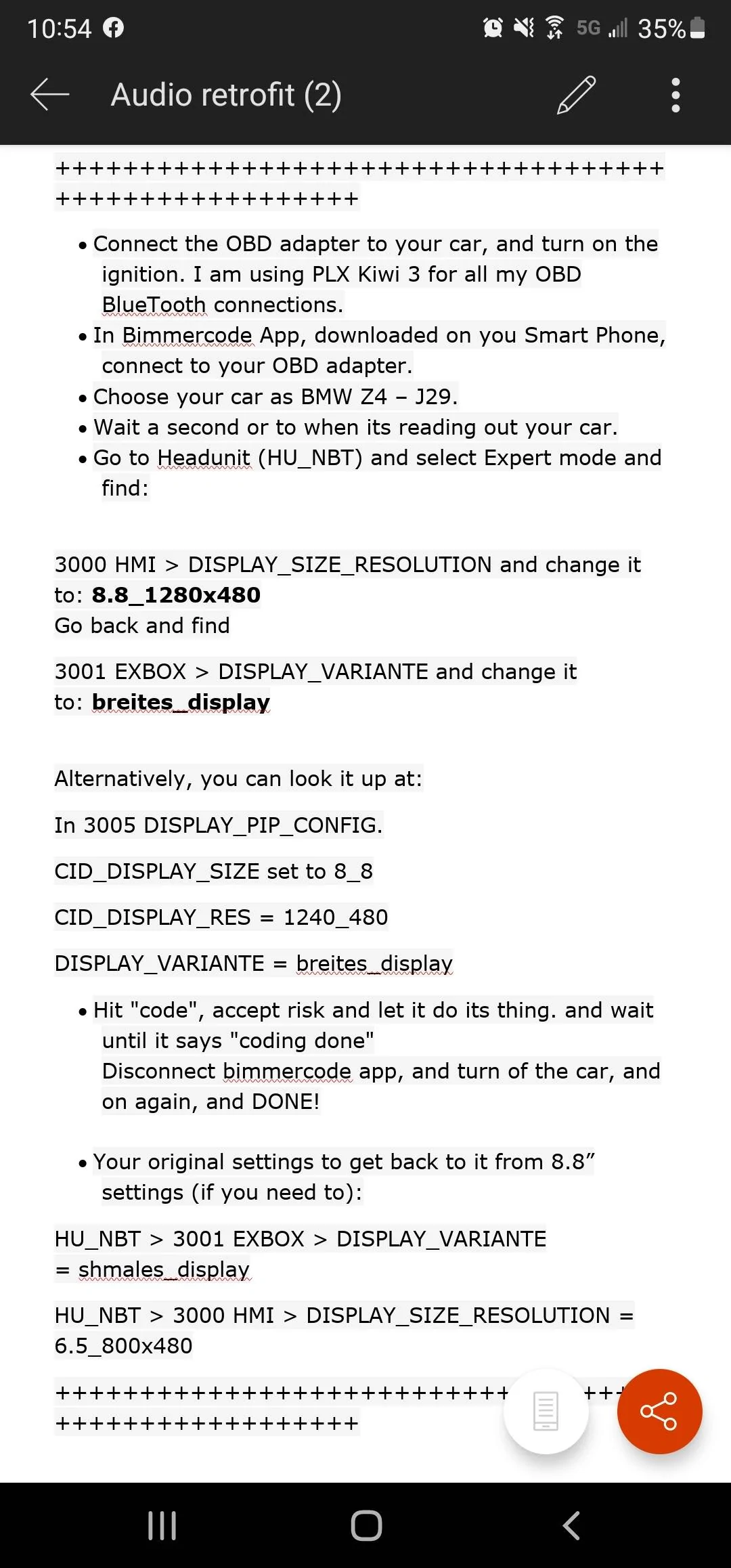

Yea I bought a screen from eBay it's coming from Australia and it should be here tomorrow. Here are the instructions that received.

Thank you for the coding instructions! I’m going to be trying it as soon as my obdlink mx shows up.
