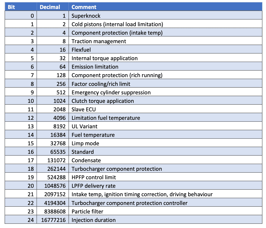

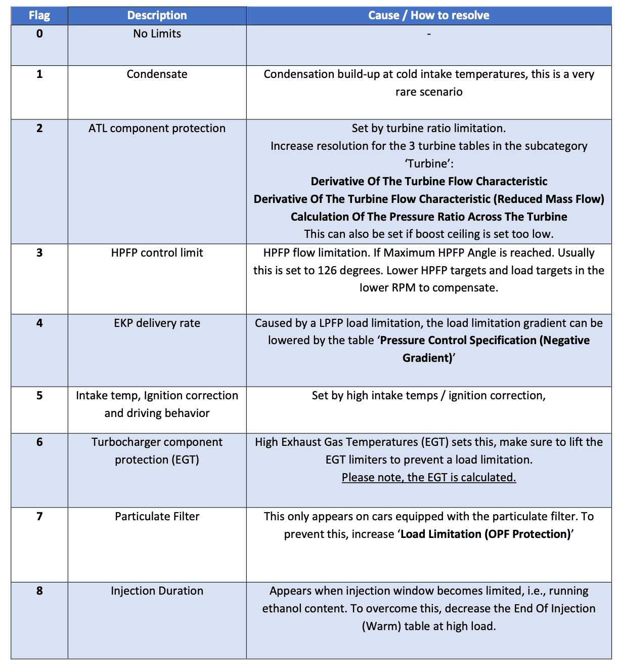

Yea. Here is a handy dandy chart with the Relative Fill Limit Flag and Torque Limit Flag meanings:
