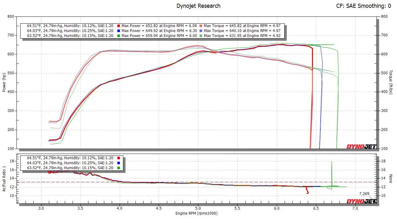

Corrected DynoJet
Pull #1 653/646 whp/wtq
Pull #2 649/640 whp/wtq
Pull #3 660/631 whp/wtq

So lean at tip-in, leaving spool and power/tq on the table from 3k-5400 looking at your graph.
Only making 550 is brutal on a pure800 but you are at elevation like you said. Any fuel mods?
Edit: I see now you're on stock fuel. Well you know what to do from here...

This is bound by the stock HPFP currently. It’s right inline with what it should be making. Approx 580-600 at sea level.
