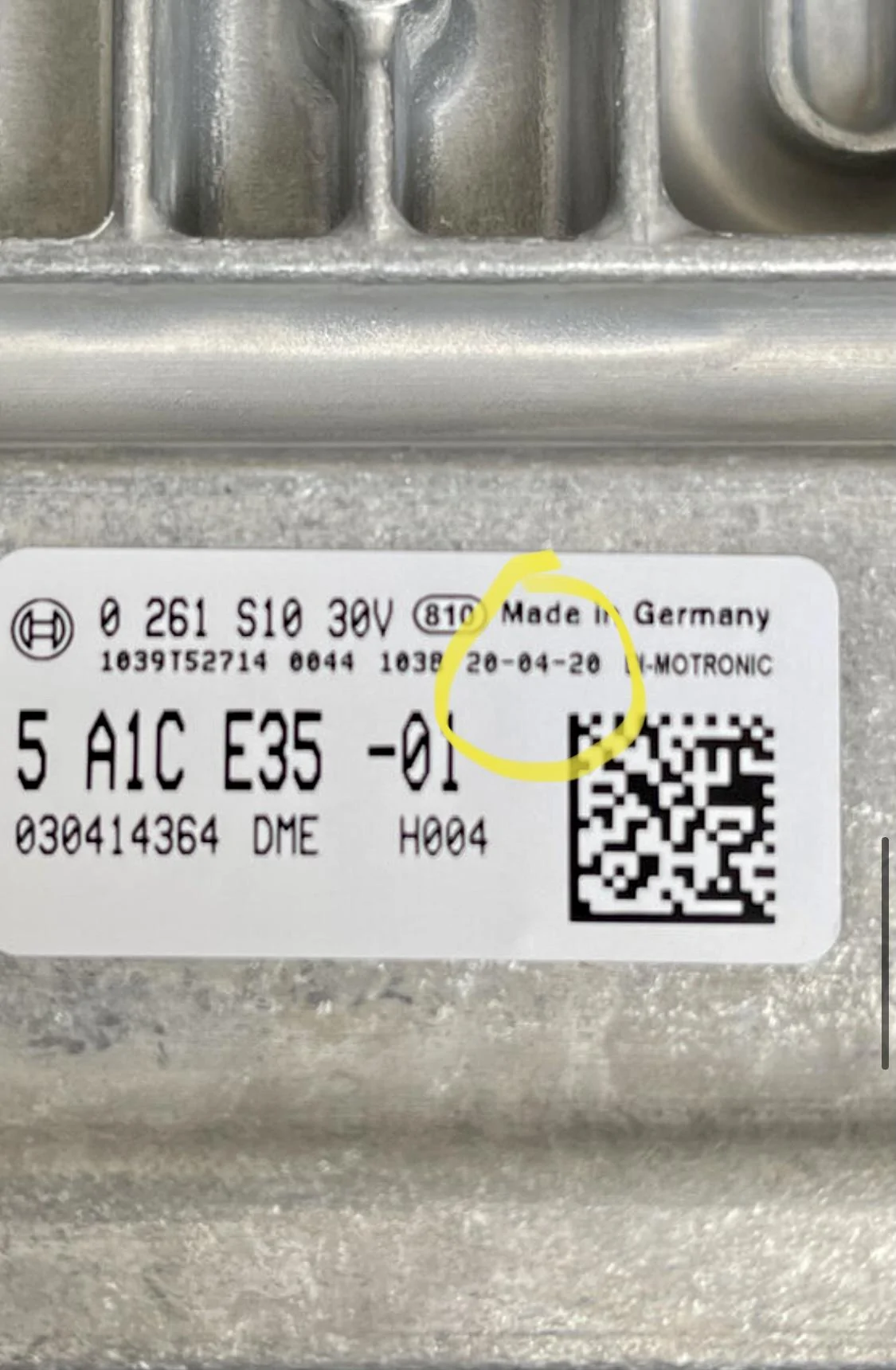

Early 2020 manufactured MY2021 Supras are tunable. The deciding factor is the ECU date of manufacture. If it’s before 06/01/2020 you’re one of the chosen ones. ??

literally having this same issue but bootmod caught it. Crazy thing is ive hit up everyone from @Titan Motorsports @Kies Motorsports @AMSPerformance an 3 others about getting this thing unlocked an sadly not one single response. I know its Monday an you have stuff from the weekend but I mean a sale is a sale. So far @protuningfreaks says they do it for free (id imagine you have to have already purchased bootmod3 to get it for free) but more worried about sending to Canada then anything else because god forbid anything happen an im screwed with just a 3800lbs paperweight in storage. I hope the 20-4-20 is a date...if so then I hope all they did was just a reflash because bootmod did say I did need a bench unlock so I hope that means it. Never dealt with this when I worked at a Toyota dealer from 06-2016 so new rules I guess.
Just a waiting game now guys an man it really sucks that Toyota/BMW/Bosch did this dirty like this.

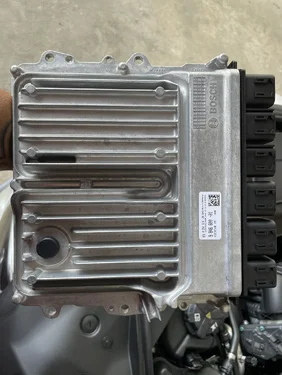

Oooh, I just took a photo of my ECU today too. How do you tell the production date of the ECU?
