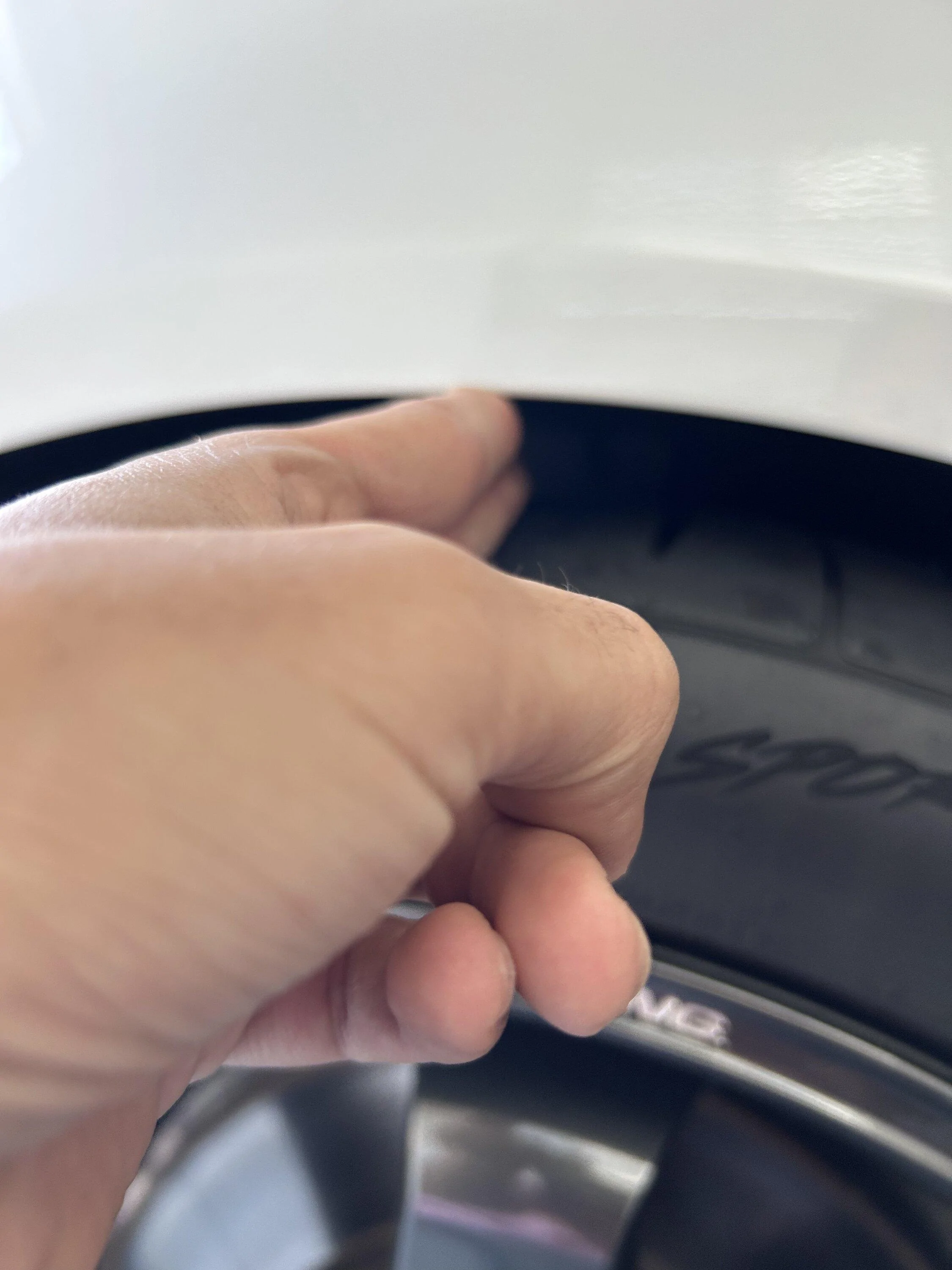

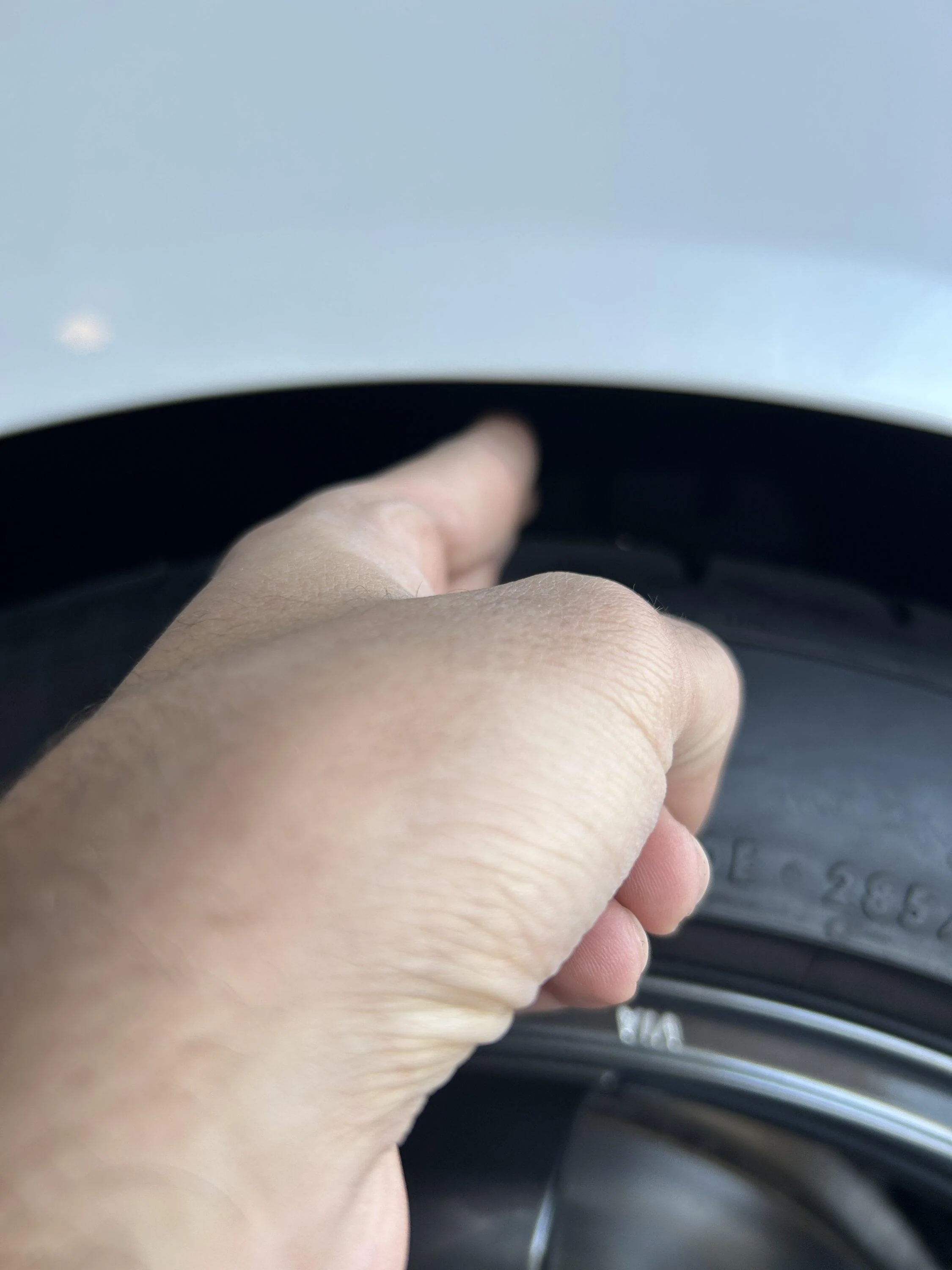

Hey guys, looking for a bit of insight. I’m running h&r sport springs on 295/35/19 tires with te37s.
my left rear sits higher then my right rear and it’s noticeable to me and kinda annoying. I usually install everything myself but the only thing I didn’t install were the springs which is why I’m looking for some insight (lesson learned). I just want the wheel gaps to be even. Left rear noticeably sits half an inch to an inch higher I can’t even jam two fingers into the right rear.
the bigger wheel gap is obviously the left rear. I’d also like to add I have a buddy on the same setup who isn’t having this issue, seems like others have this issue without noticing, I’ve gone thread diving and I see it on others cars too.

none taken, the shops an hour and a half away from me so I’d like to make sure I have a general idea of the issue before I March back and ask them to fix it. They’ll hit me with the same old “nothing wrong” or nobody would notice excuse.

Car was aligned, also as an update the side that sits higher conveniently isn't spun into the perch correctly for the bottom. It's off by 3/4-1 inch. Most likely gonna take it back to the shop just for the sake of realigning it after they correct it although they claim ride height will not change even if they spun it. Annoying af as they're clearly trying to get out of work, even if ride height would not change which I'm sure it will, I want the job done correctly.
