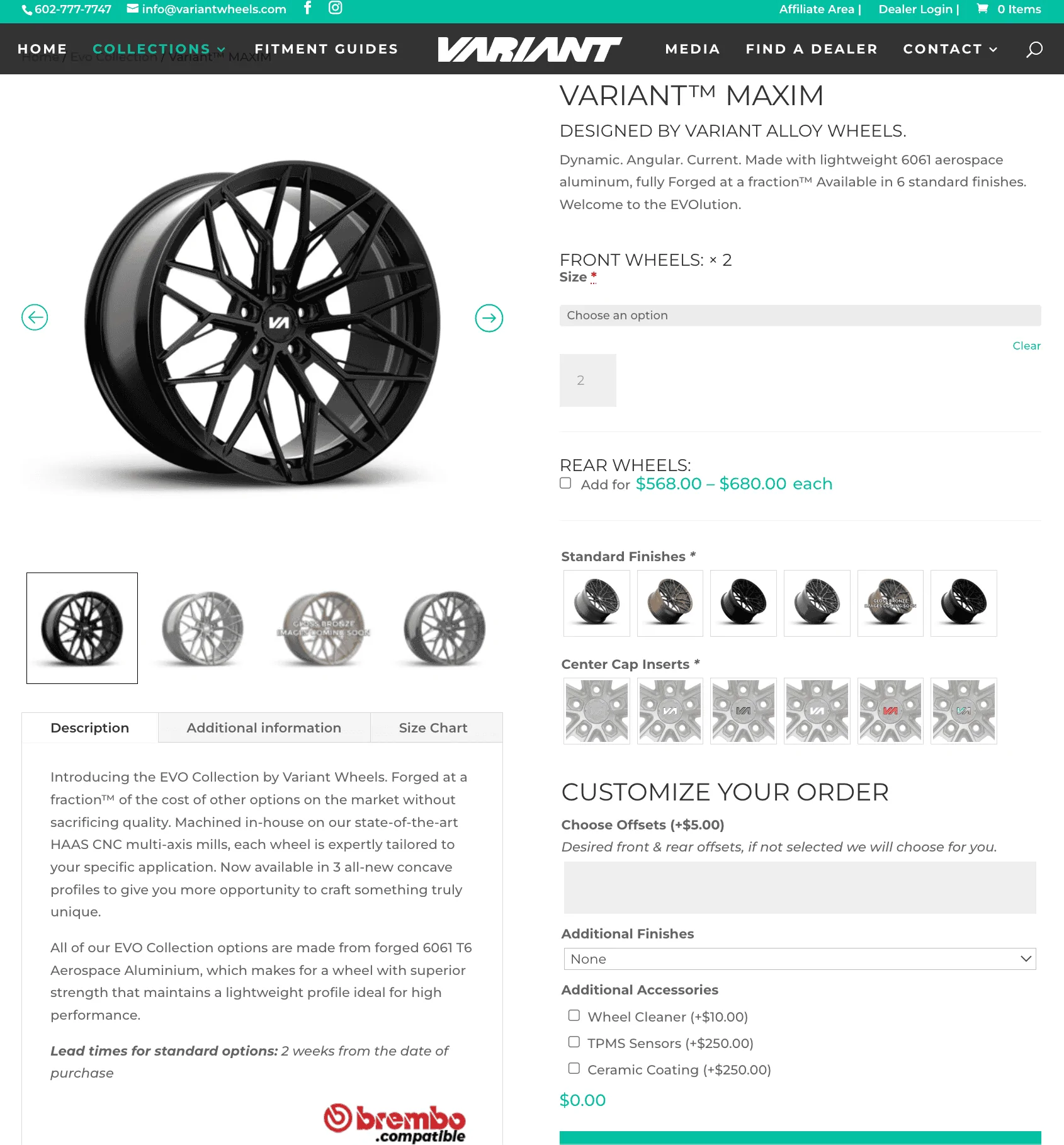

Hey all,
I decided to pull the trigger on a set of 19" Variant Evo Maxim wheels in Satin Black for my Supra.
19x10 in the front, 19x11 in the rear.
Their EVO line is a brand new, yet to be released, monoblock fully forged line of wheels.
Wanted to let you all know because they are currently offering 20% off for preorders so I jumped on that deal. I just happened to stumble upon these while looking at wheels online last night. Less than $3k for a set of fully forged wheels is kind of hard to find. The mesh style design isn't everyone's favorite for this car, but I personally love the design of the Maxim. It is exactly what I've been looking for in an aftermarket wheel.
Emailed Mike in sales this morning and eventually spoke to him on the phone later in the day and I could not be more impressed with the level of customer service and enthusiasm.
This is my first set of aftermarket wheels I have ever purchased for any car, so needless to say, I am VERY, VERY excited and can't wait for them to arrive and get mounted on my Supra!
They also have a bunch of their cold forged styles on sale right now too and the prices are insane (some of which are 50% off). If I didn't want a set of fully forged wheels, these are great options to consider, especially right now with the discounts they are offering.
https://variantwheels.com/
https://variantwheels.com/evo/
https://variantwheels.com/product/maxim/
https://variantwheels.com/cold-forged/

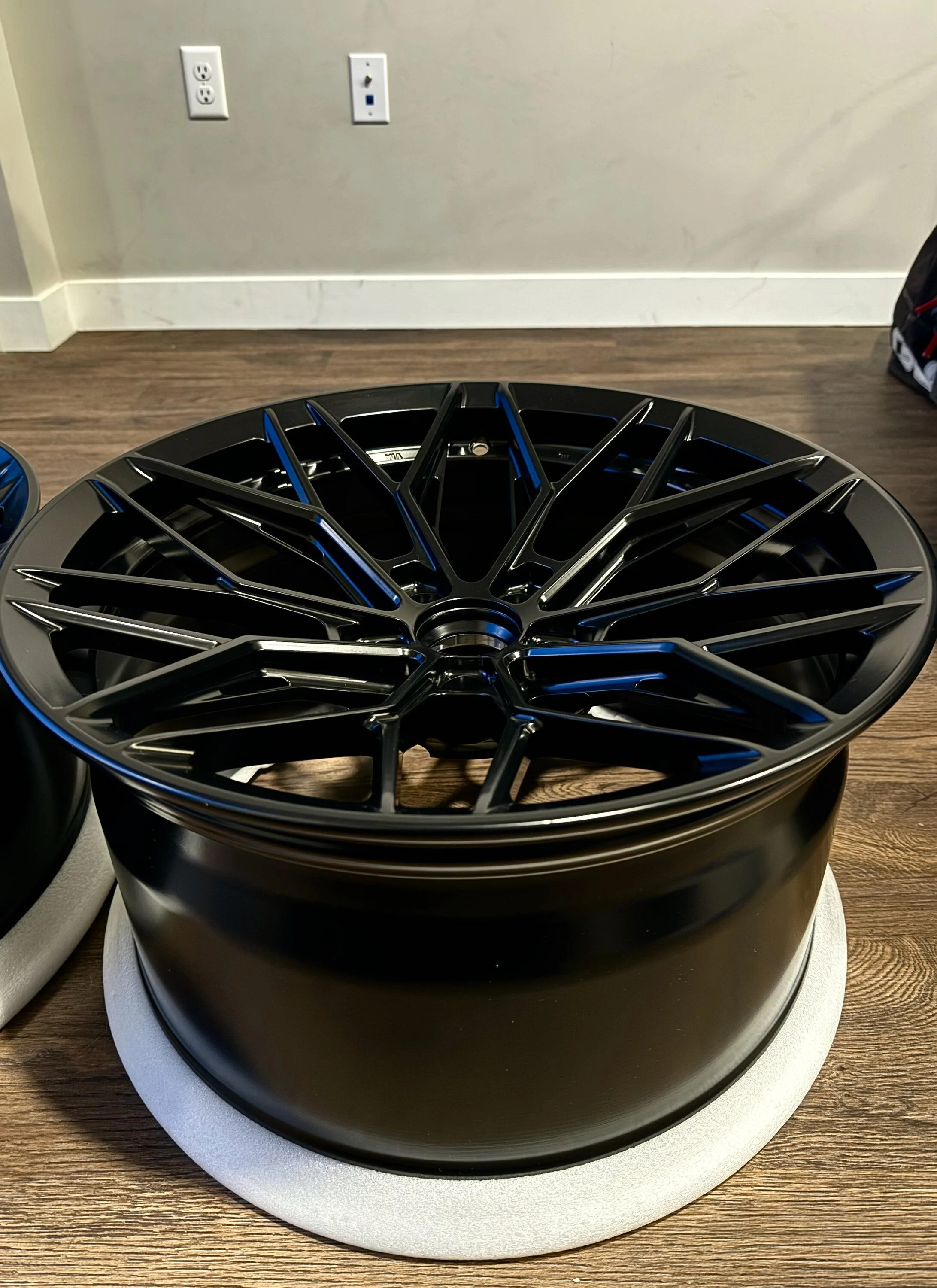

They’re finally here! They look better in person. The pic makes them look shinier & brighter, they’re a nice, dark satin black. Excited to get the tires on them and get them on the car!
