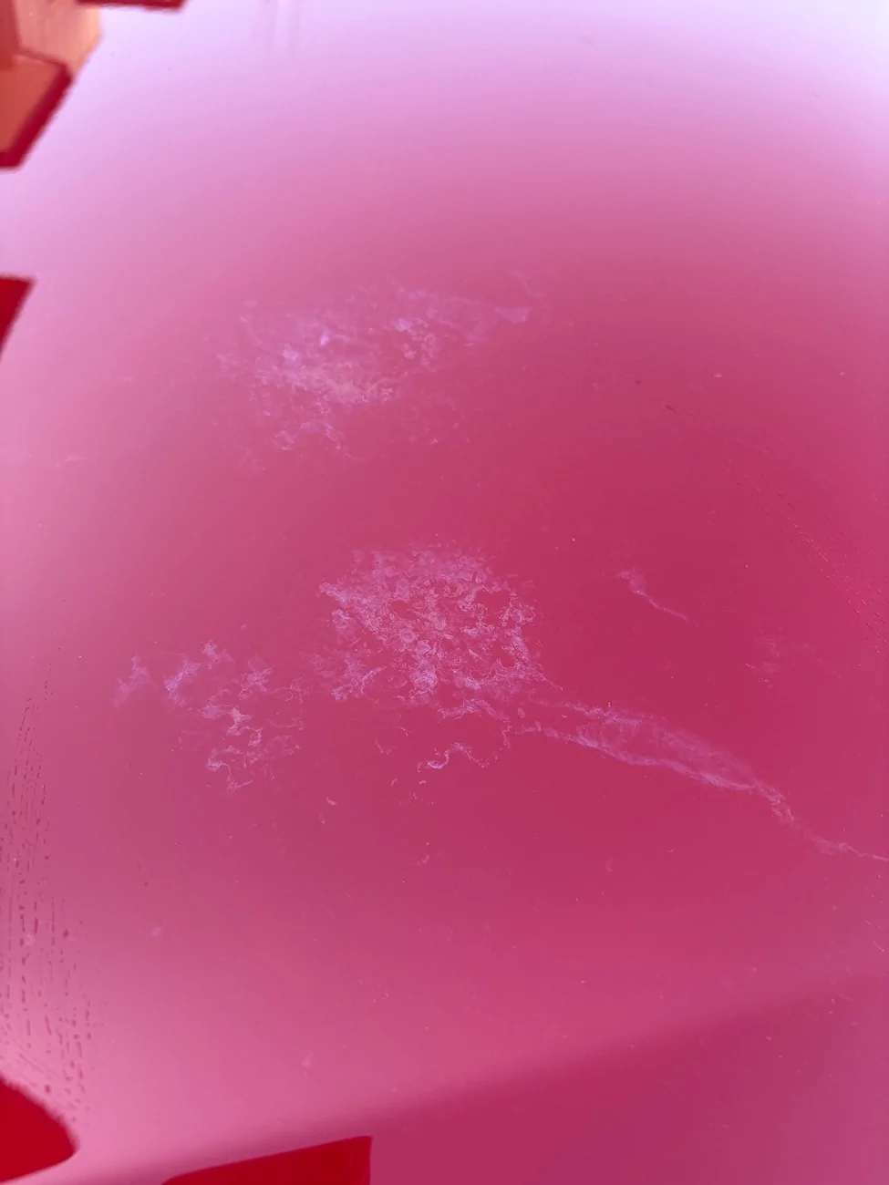

Lol give mensome tips on this. I tried white vinegar which work last time i had salt get on my car but thsi time it didnt come out

I've used and can vouch for Gtechniq W9 Water Spot Remover, though it took a couple of applications for it to remove the hard water spots on mine. I've also been recommended CARPRO Spotless 2.0 Water Spot Remover. That said, I would have thought vinegar would have stripped it along with any paint protection.. 😅

If vinegar didn't work, then you need to polish that out. It looks like bird droppings to me.

I would also try claybar (synthetic clay bar works well) before polish (ScratchX).
If it still doesn't come off, big bandaid decal.. :crazy:
