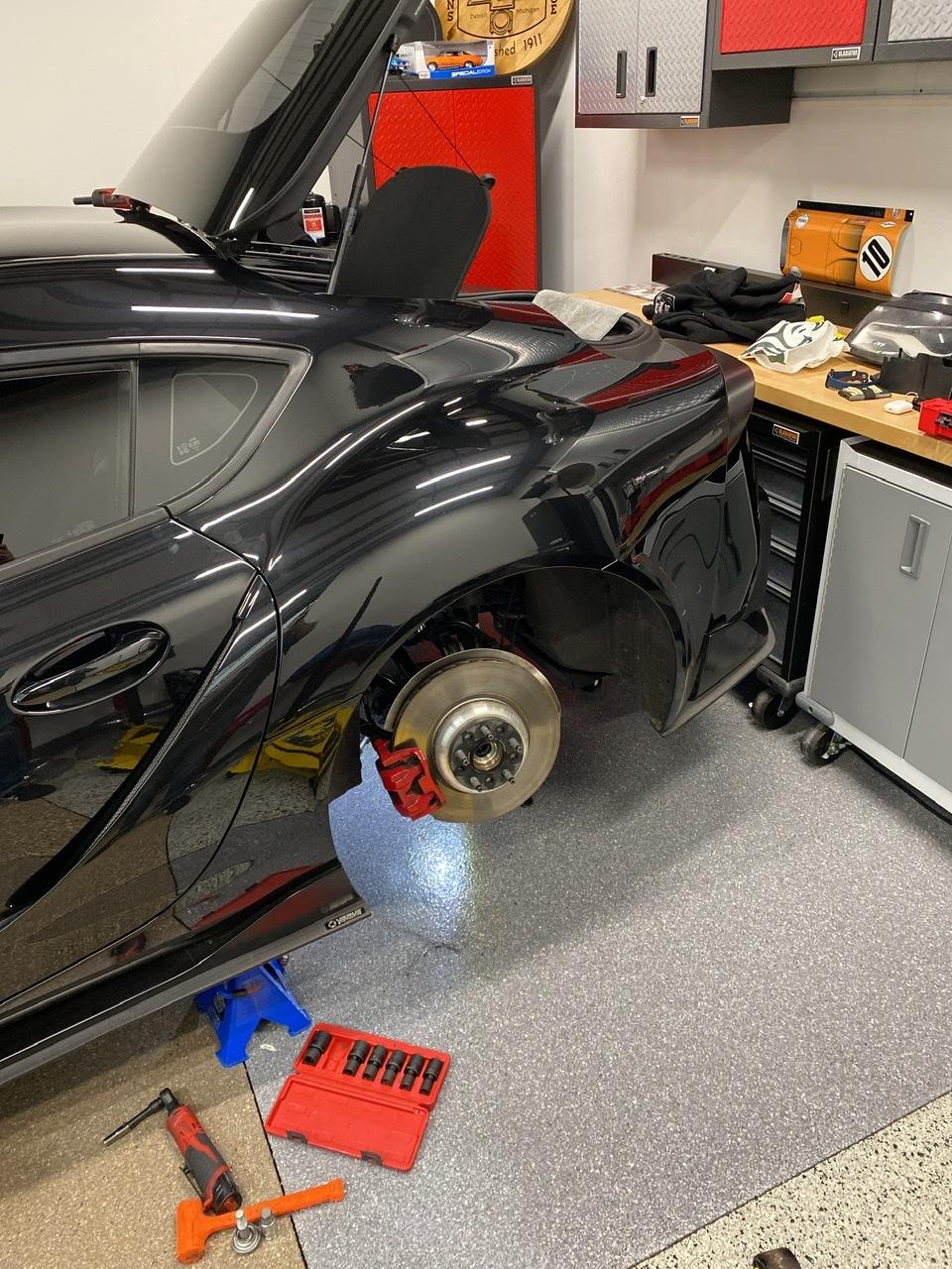

I lowered the rear of the car last night. I had a mechanic in the area explain to me how to use a come-along and some ratchet straps on the control arms to relieve the tension on the springs.
All you do is:
  1. remove the lower mounting bolt of your shocks.
  2. wrap your ratchet straps at the end of each control arm and connect to the come-along.
  3. place a block on the differential cooler to keep the come-along at a "V" to have leverage to pull the control arms down.
  4. One you relieve the tension on the spring you can adjust the nut by hand. (Make sure to loosen the locking bolt if you coilover have one on the nut.)
  5. Remove all your straps.
  6. If have two people, one can lift up on the suspension assembly by the rotors while the other slides the bolt back in the shock mount. The smart thing would be to use a jack or a underhoist to do this... but I didn't have that shit.
Props to my wife for getting those bolts back into the shocks.
With this method you do not have to have a spanner wrench AND you don't lose your alignment doing it this way. You just adjust the nut by hand.
I'm new to this game, so I am super grateful that he showed this to me. From what I understand this isn't common knowledge. I had two different specialist shops in the area complain about having to remove everything to use the spanner wrench to adjust the rear coilovers.
Hopefully this helps someone out. I'll try to make a video this weekend to demonstrate. I should have done it last night. Oh well.

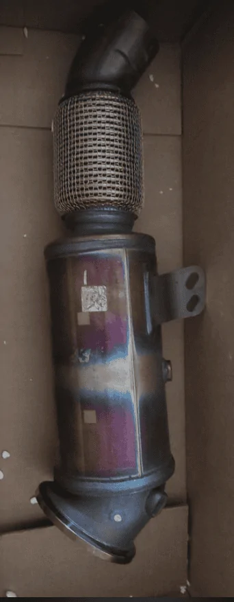

I got rid of the stock downpipe.

We’ve basically taken the whole rear suspension apart. If there’s an easier way, I don’t know it. 3 hours in and axles are out. Reassembly should be easy, but we’re breaking for lunch.

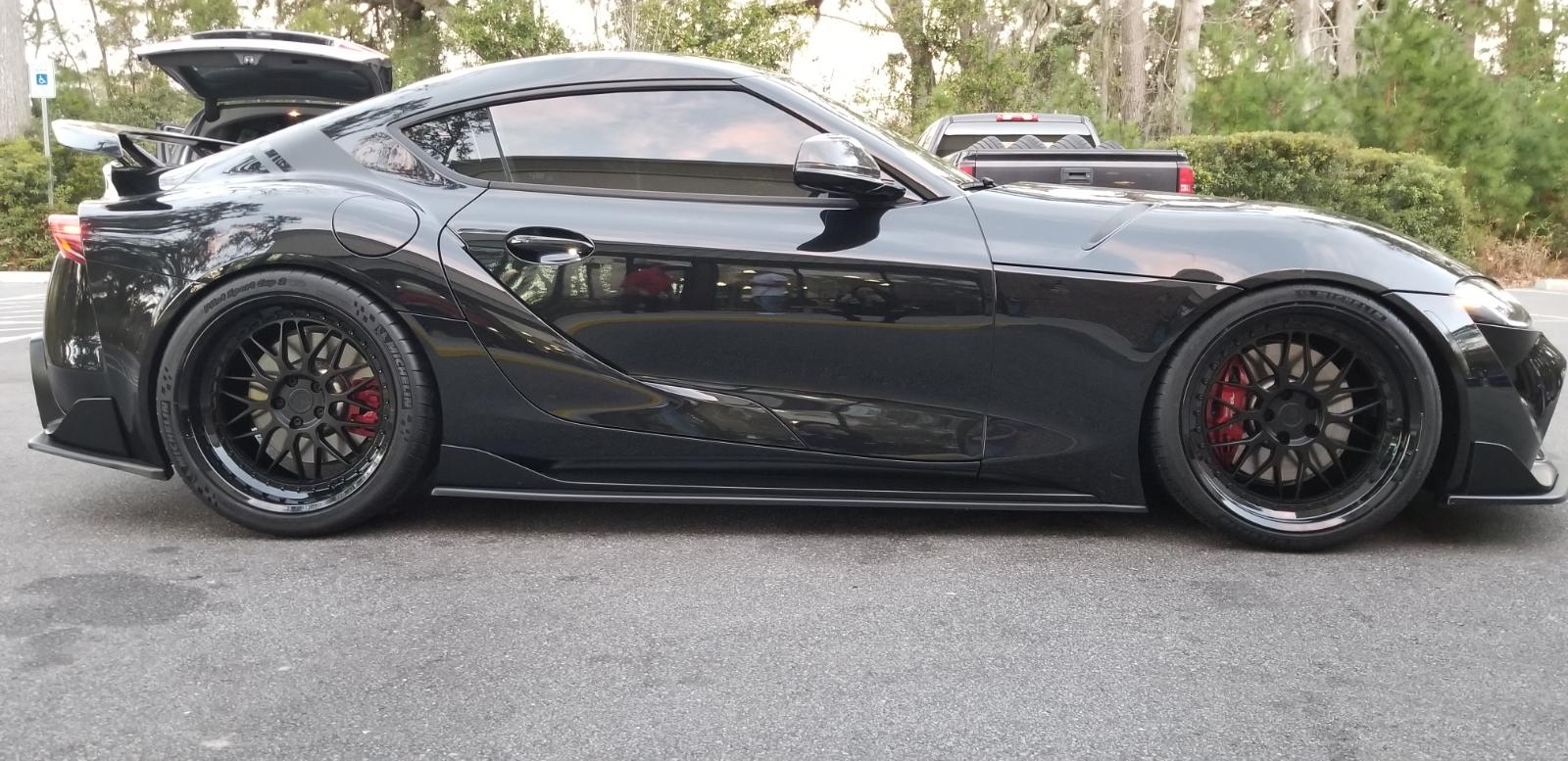

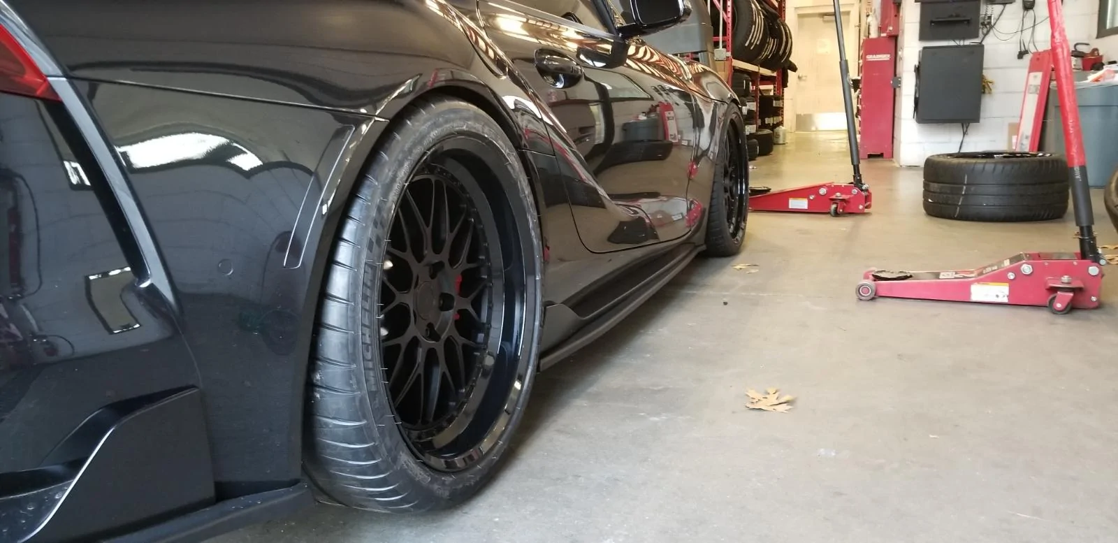

Got new rubber for the BC FORGED LE81s...
But have a slight issue...when pulling into my driveway the loaded tire rubs? not sure if I should be concerned?

Your setup looks similar to mine, I rub over large bumps as well.
Whats your tire size, suspension setup and camber specs? Are you rubbing in front or back?
