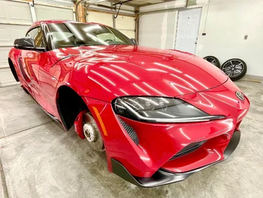

That's what's on mine right now. Crystal serum ultra.. it's a beautiful coating. I did not apply it myself, ceramic coating is something I always pay for because I want the warranty.
The light version is unbelievably easy to use. You could do the entire hood and wipe it off without it even starting to dry unless it was 100 degrees out. I typically do my coatings in the winter/spring where temps are 40-50 degrees and the work time is huge with crystal serum light.
I messed up the coating on one vehicle (but it was a cheap product) and have been timid about it since. I might look into giving it another shot.. that does sound easy.
