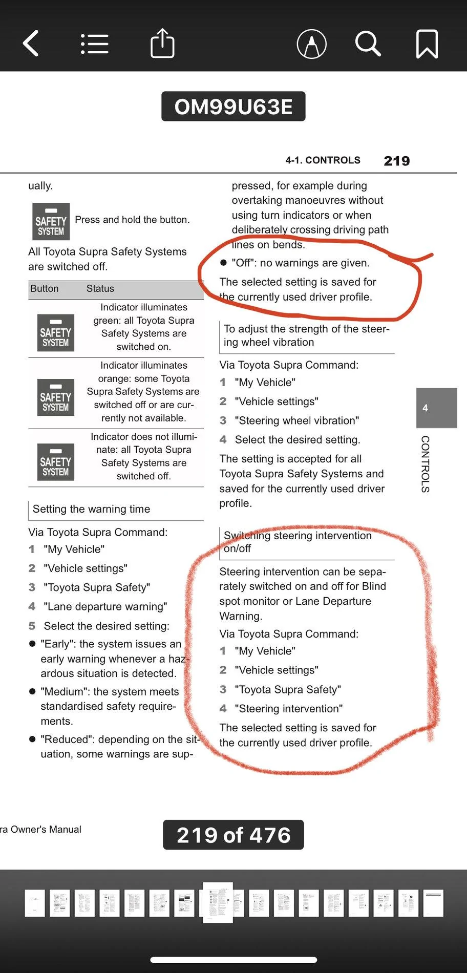

So, i have the lane assist/departure on "off" and it still works as if its on when i turn on the car the next day? i keep going in the menu selecting to on and selecting off to work as it should. Anyone figured this out?

Which part, the steering correction or the whole system? Using the button only turns off the system until the next start when the car will turn it back on.
When you customize and turn off the steering correction only, it stays off.
From the manual...

^^^ Did you watch video above? Make sure console switch is on Customized & then customize lane departure warning to OFF & blind spot to OFF if you don't want that either.

I did brother! Thank you so much for your help! Love ur videos brother, I follow u on YouTube. Thanks for the videos on the obd Bluetooth, this one, and next are the spacers! I appreciate you
