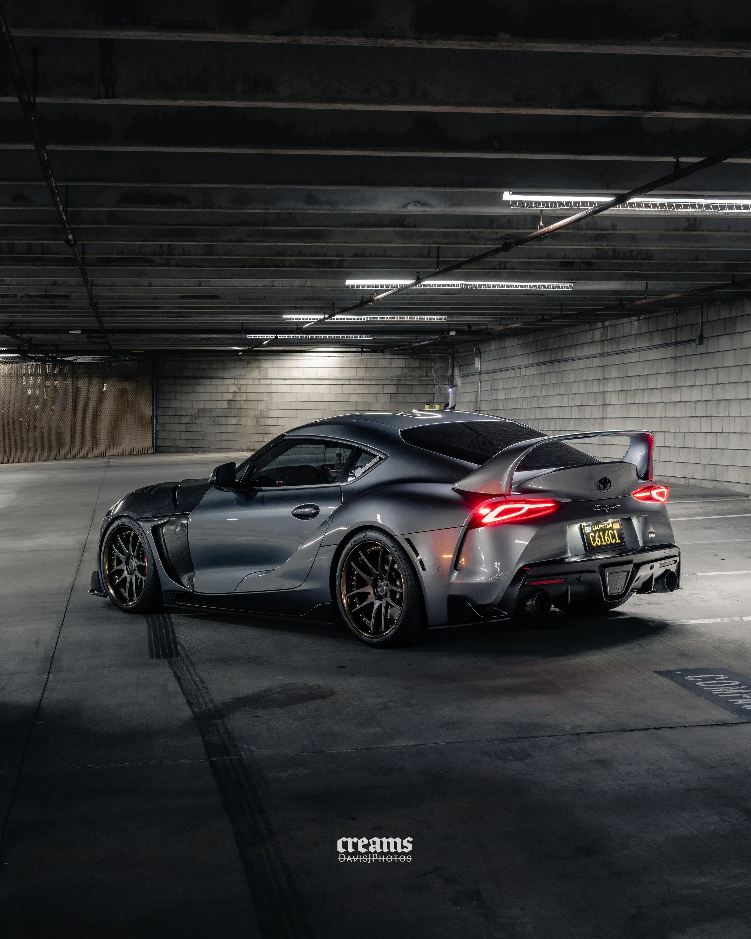

With my Work CR3P they are R disk front, A rear. Recommends set up for OEM brakes.
