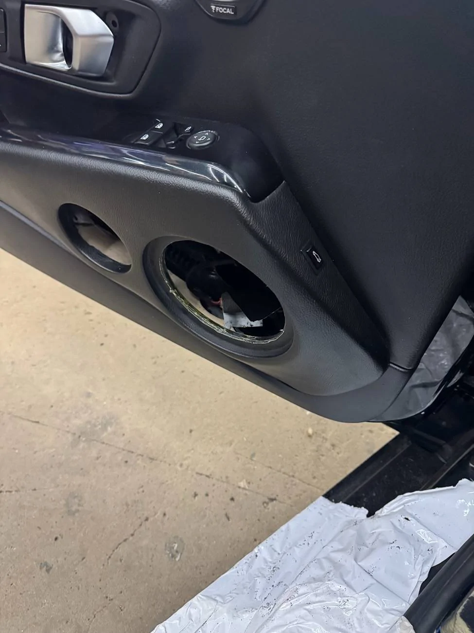

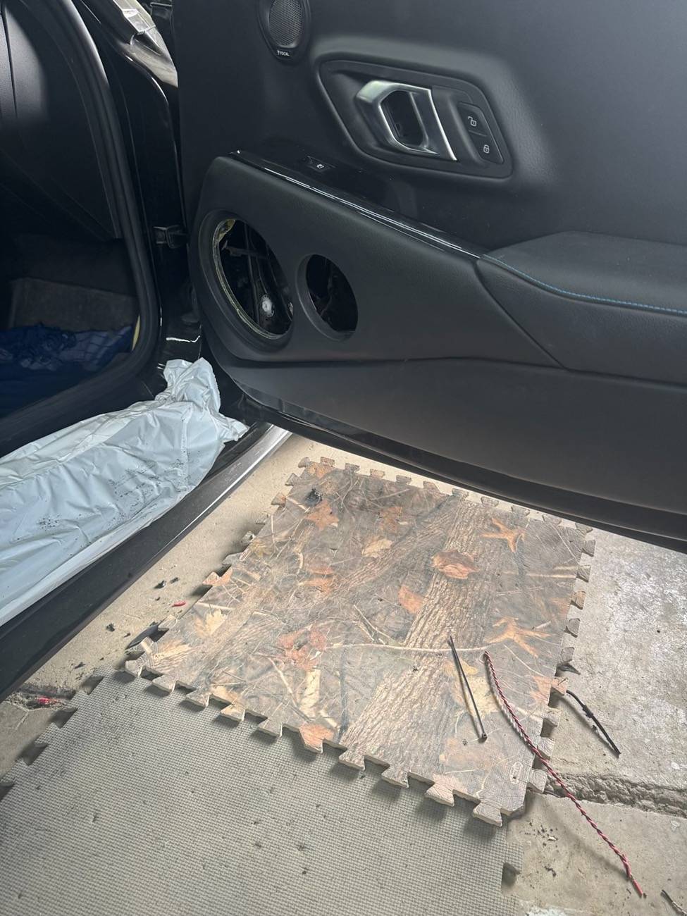

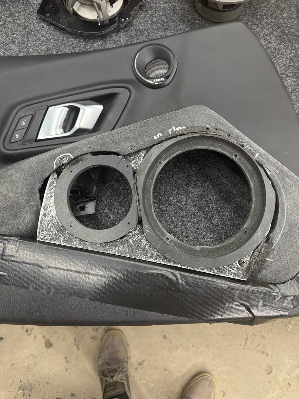

Before I get crazy with claims (hence the question mark in title), has anyone seen any MKV’s with a 3-way component set in our doors?
Pic for attention…..and progress.

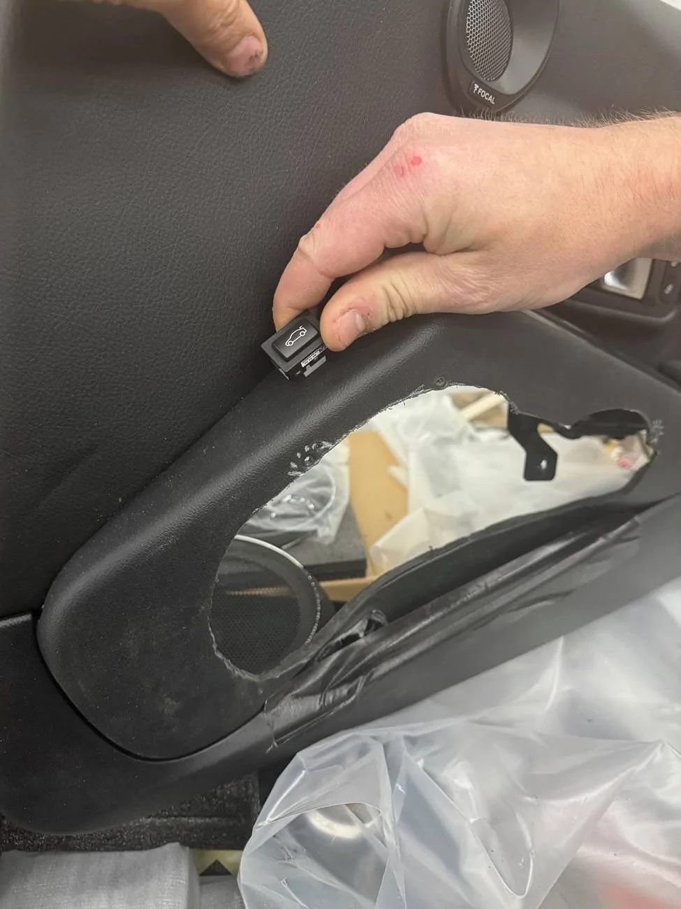

Sorry but I can't answer your question.. but I have one of my own about the door card arm rest - can this be removed without removing the entire door card? Also stole your image for my own thread about identifying the right hand side part number. ?

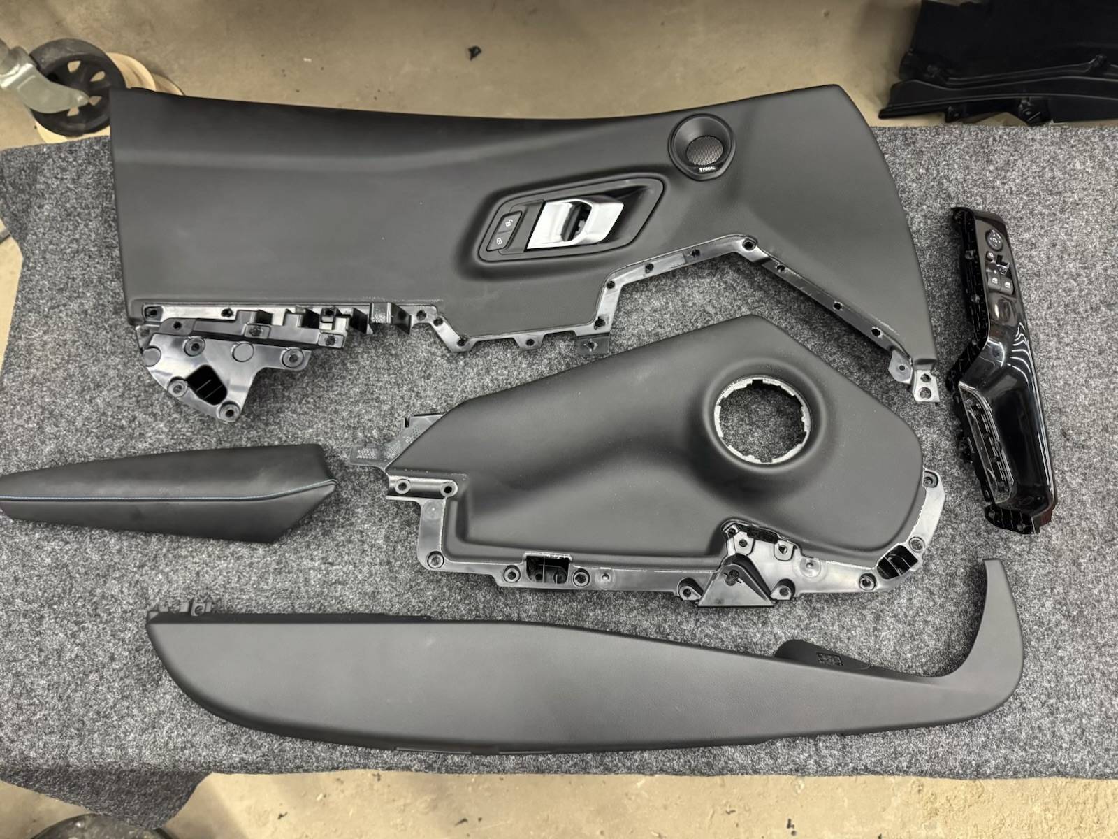

The entire door is held together with plastic rivets. “If” it could, I don’t think it would be worth it. Best to take it off.

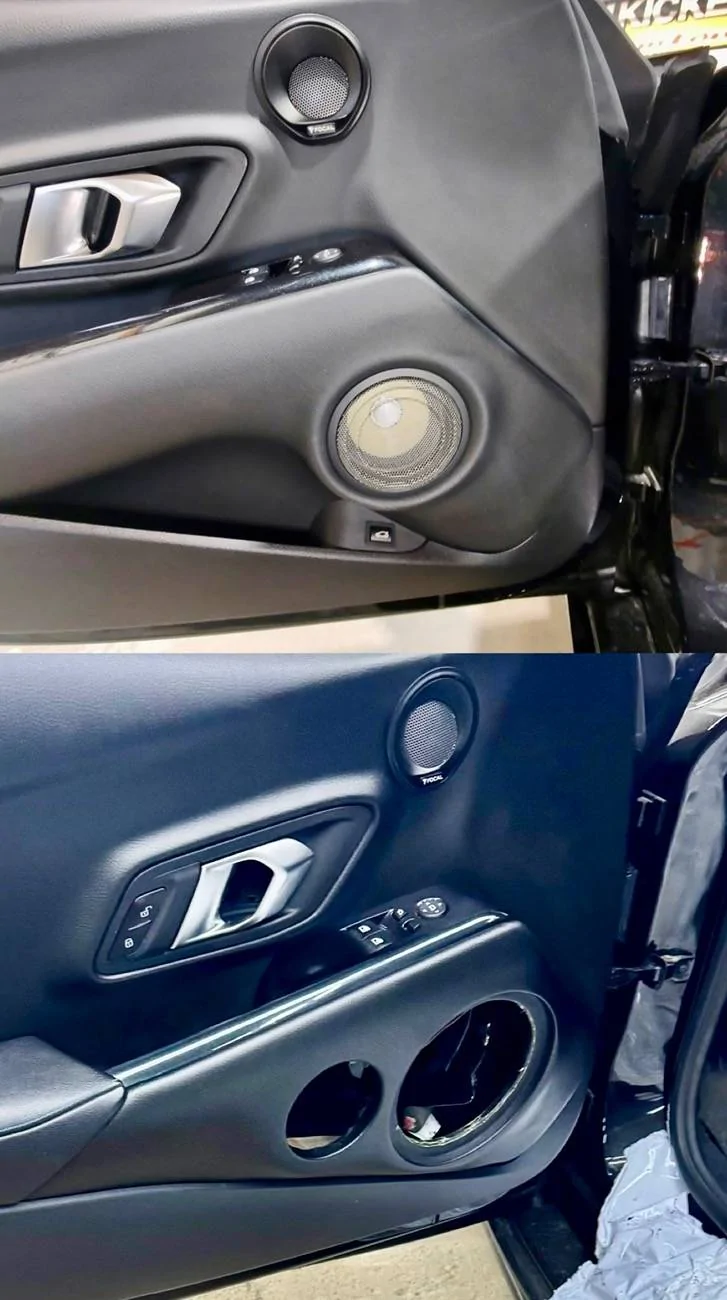

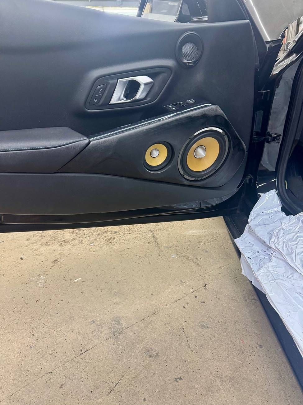

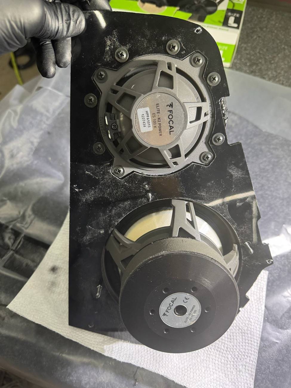

How it looks vinyl wrapped. It looks stock. There is more than enough room for a decent size speaker, disappointing that they chose to do 4”. Custom grills up next.

Fuckin’ hell that looks good. I’m not interested in audio like I used to be but I am very interested in modifications that look OEM. That’s on the right track.

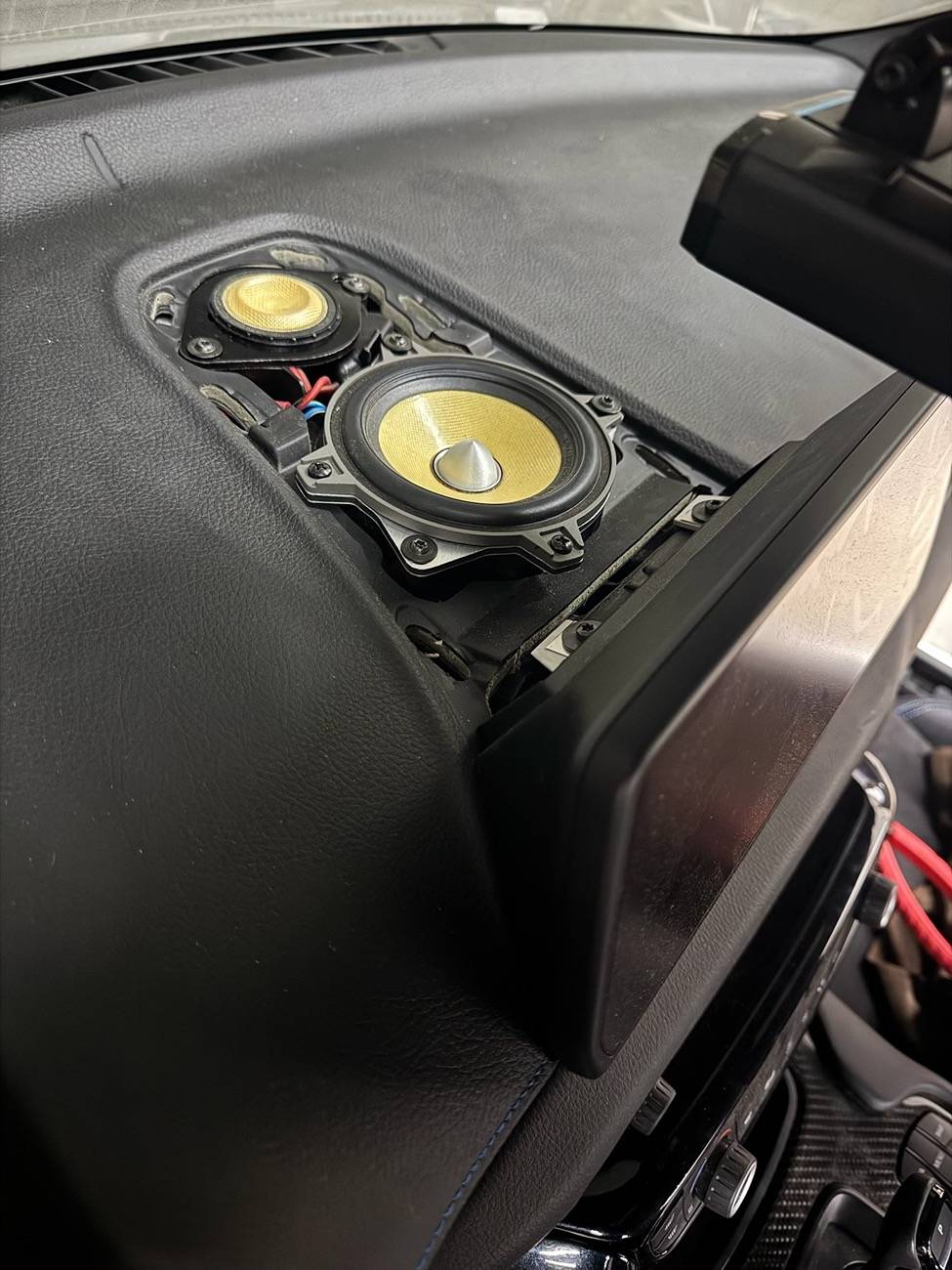

May as well toss in the center channel pic.

Focal is simply the best. Do you plan on changing the amp/dsp?
Yes, a new refresh from my first setup. It will be the Mobridge to the Helix V Eight DSP amp for the center and doors, out to an Epicenter and JL Audio HD750/1 on a 10W6v3.
My old build is also in this forum but wanted more :)
