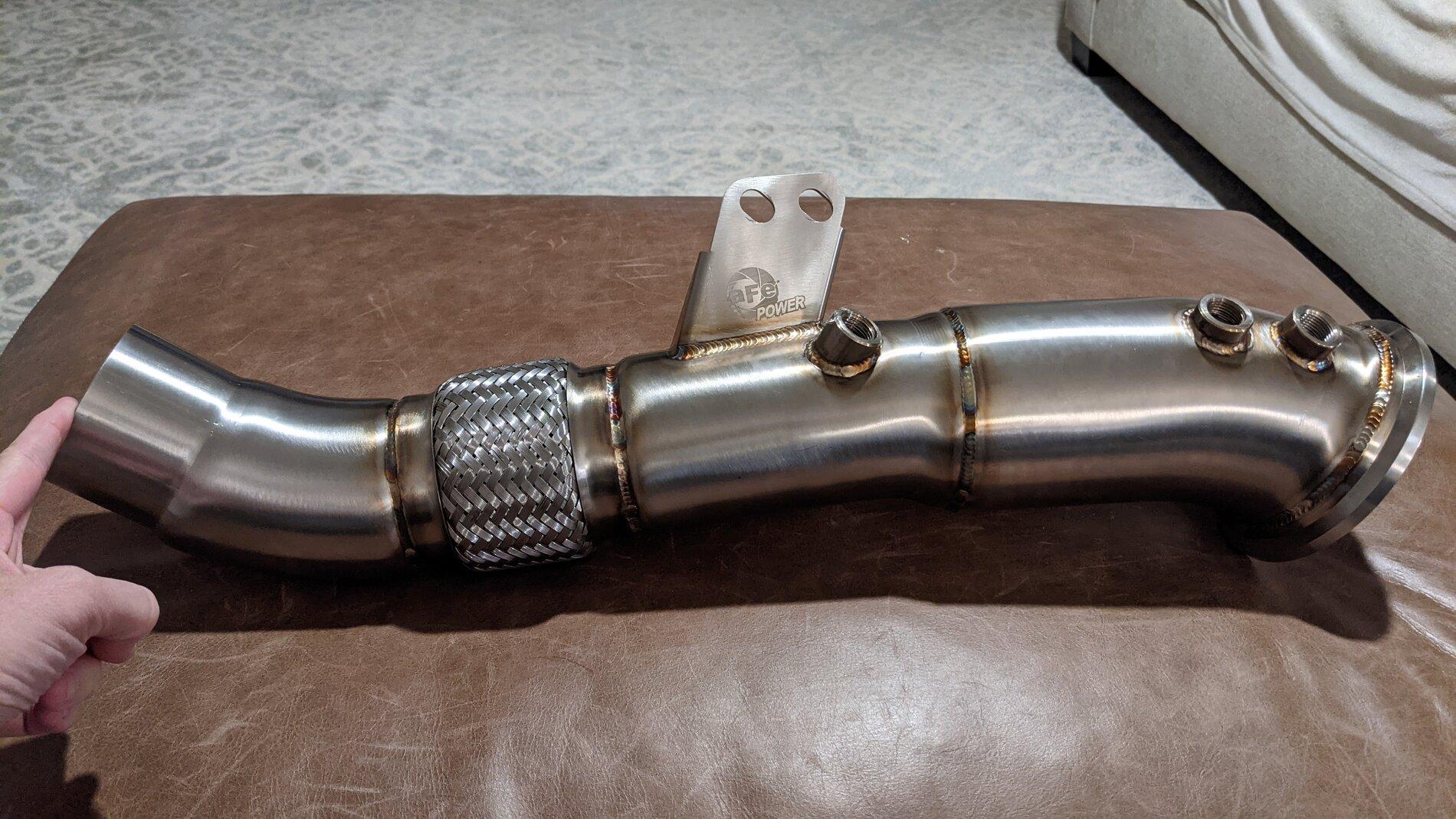

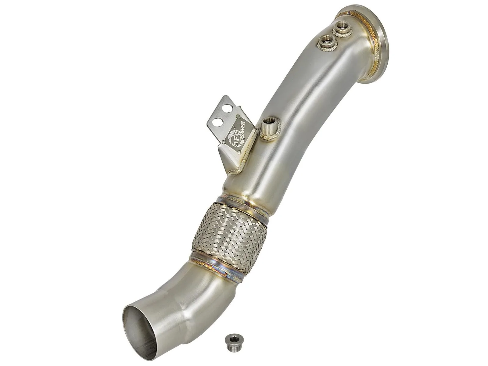

One of these things isn't like the other:
Website Listing
Received
Is anyone aware of a redesign of the catless aFe downpipe, and if so, for what reason?

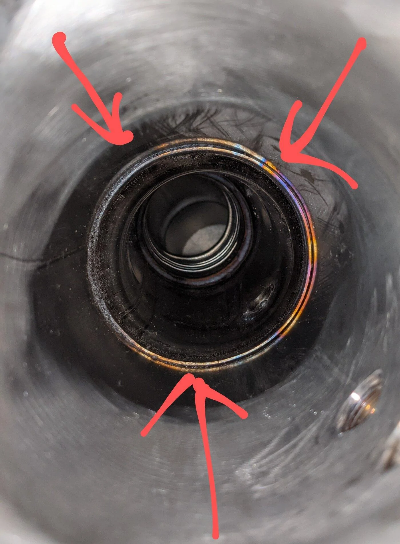

Would this lip facing in the direction of the exhaust flow concern anyone?
