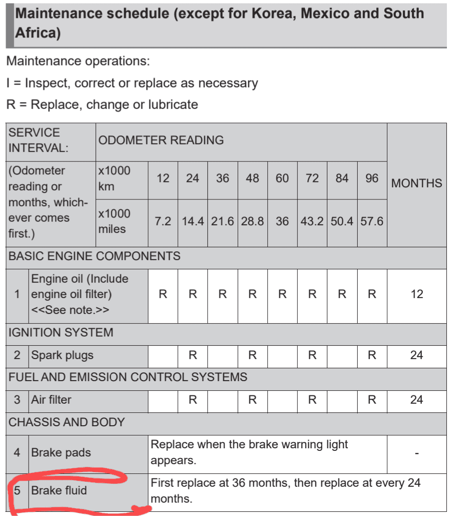

One day after my warranty expired, I got this on the dash notification ! “Service brake fluid “
Obviously I checked fluid,it was clear and to the full line, like when it was new, so, what the hell is service break fluid!!??

It’s a timed service reminder. Once you swap the fluid you can reset it in the dash menu same as you reset the oil change reminder.

Brake fluid is a 2 year service interval not based on mileage. Although 2 years is conservative, so what I do is I bought a brake fluid tester online and I test my brake fluid till it detects water in my brake fluid system, that’s my notification telling me to change it.

Is it 3 y/o?
According to the maintenance schedule that might be the reminder time frame for brake fluid:
