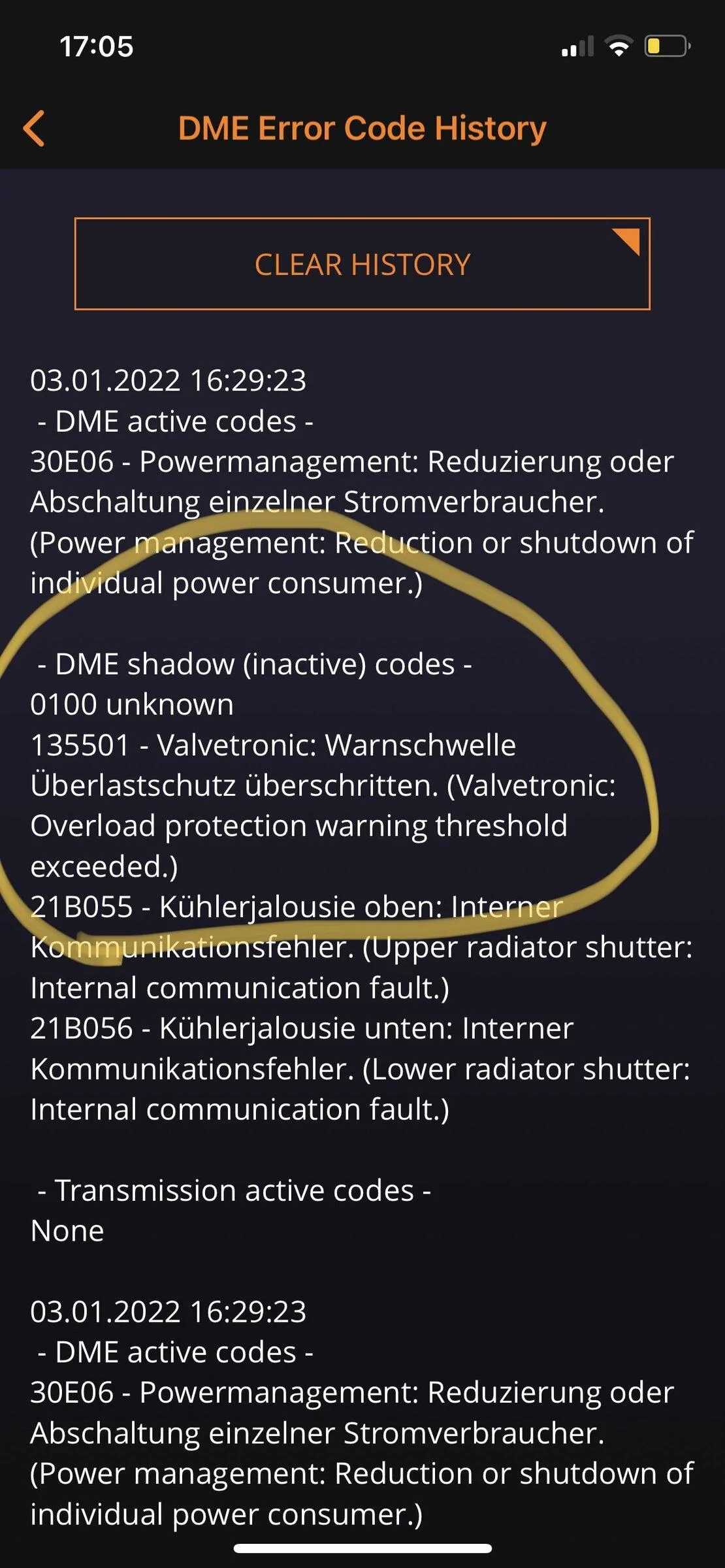

Hello everyone
i just drove around a bit some hours ago and noticed that the power wasnt there anymore. Then i Checked the DMS and got this Valvetronic Code but there were no CEL oder anything else on. I have MHD Stage 1 with a catted DP and an Intake.
i deleted the error and drove again. No Problems anymore. But iā€˜m not sure if this will come again or what excactly went wrong before.
can someone help?

I’d worry more about that power management code at the bottom. That’s the active code where as your circled one is inactive

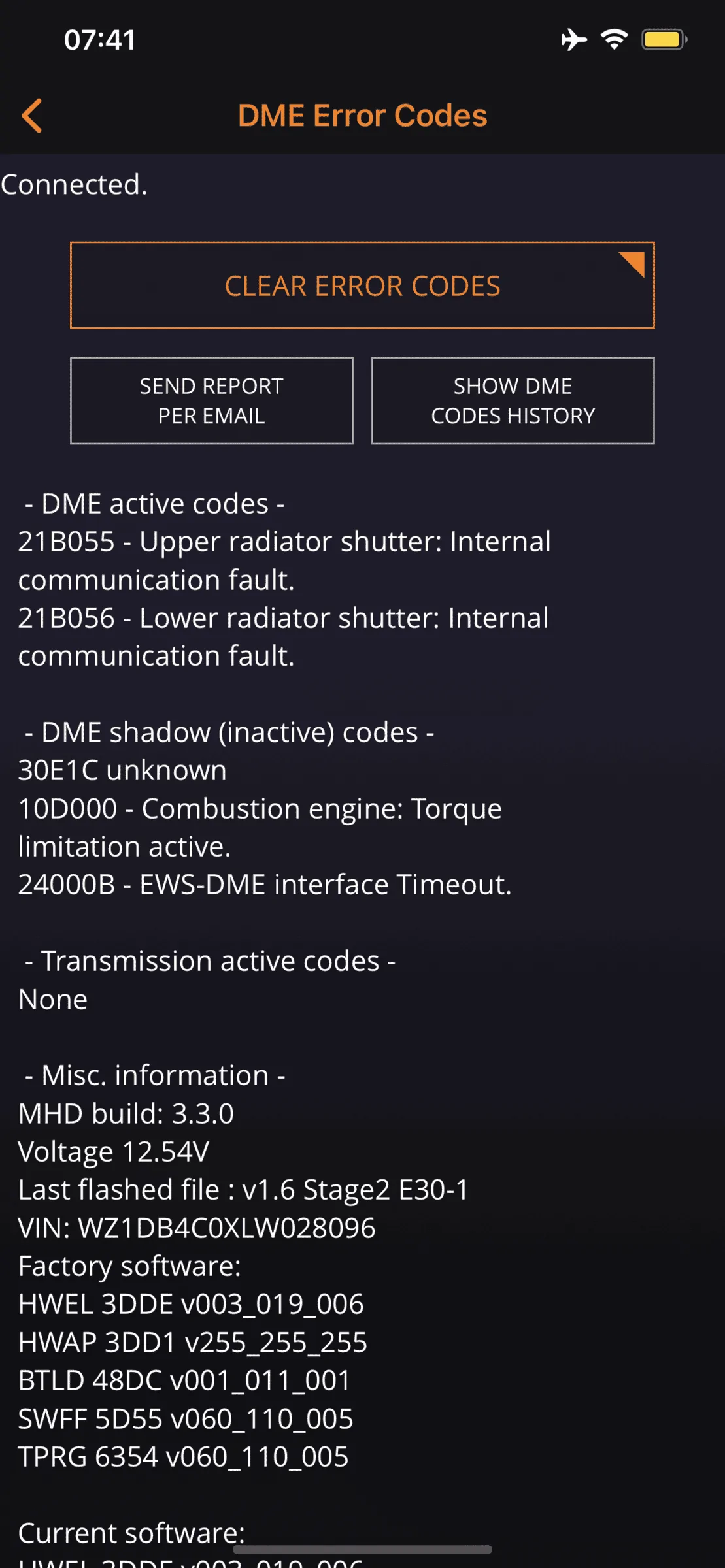

Idk what it is, but your car just went into limp mode. I used to have codes that pop up saying "torque limitation active" sometimes. Not anymore, i think it's also because that was my first time flashing the car onto a powerful map at the time. The TCM or whatever that records and makes adjustments according to your driving habits didn't have time to adjust to the big changes. It'll kick you down to a lower powered map instantaneously. I'm pretty sure you went into limp. Try reflashing the map and see what happens.. datalog it too and send your file to MHD...
