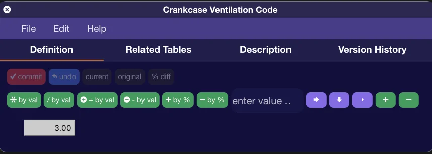

The aftermarket turbos get rid of the little heater connection on the turbo so it throws that code. You can code it out in the tune. Pretty straight forward in Bootmod3:

That’s what I was told and tuner said he coded it out but it keeps coming back. Also Bm3 has option to turn off through their app but after doing that and re flashing the car it’s still present.
Worked for me with no issues. You sure they are coding it out correctly?
