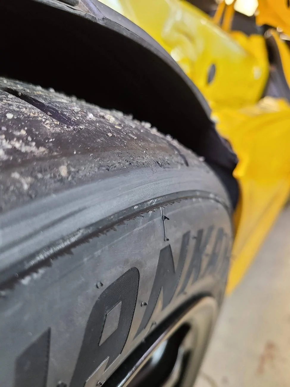

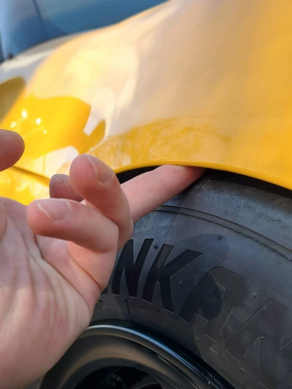

Most likely yes. I ran 275/40 square on an 18.10.7 setup with the eibach US springs but would rub on track. It was much better running that setup with the HKS HAS springs set to their default ride height.

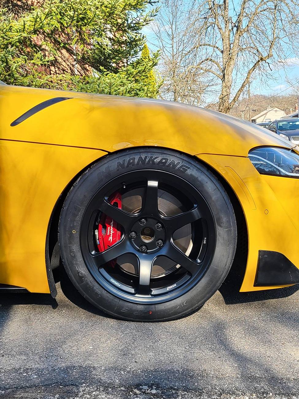

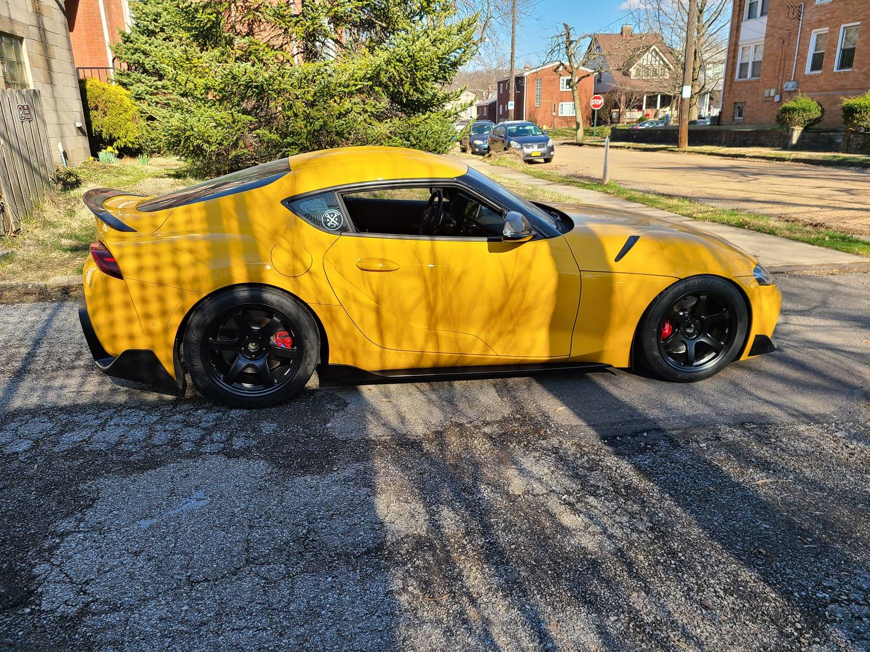

I think you'll clear the fronts with your new setup.
I ran 18x10 +36 on 275/40/18 square on ECS02 with 5mm spacers all around on HKS adjustable springs (default height, out the box settings)

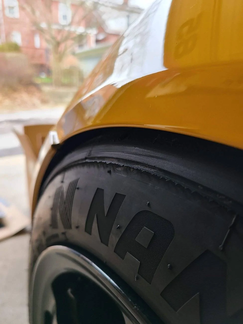

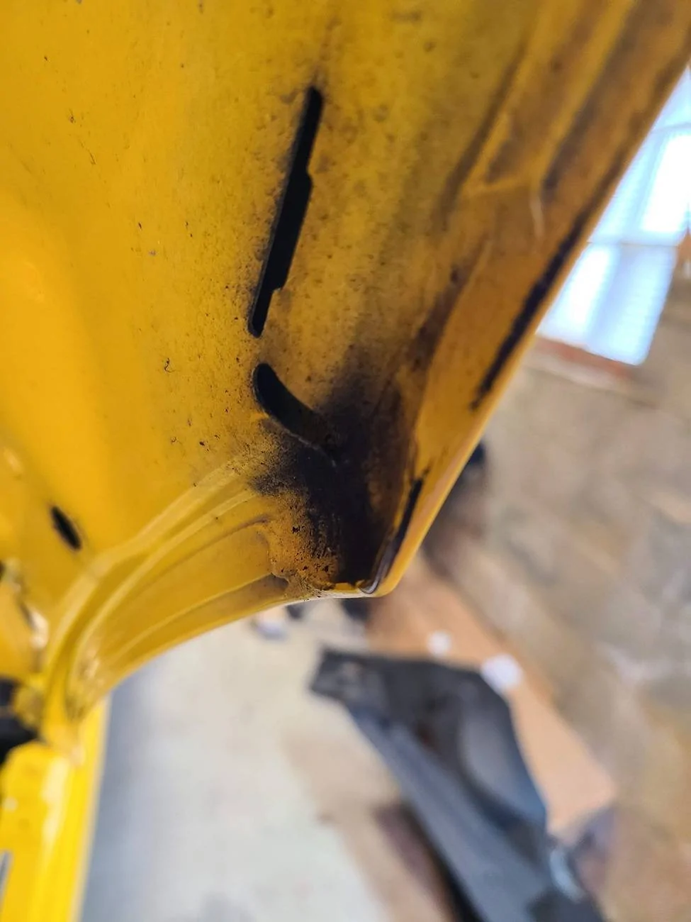

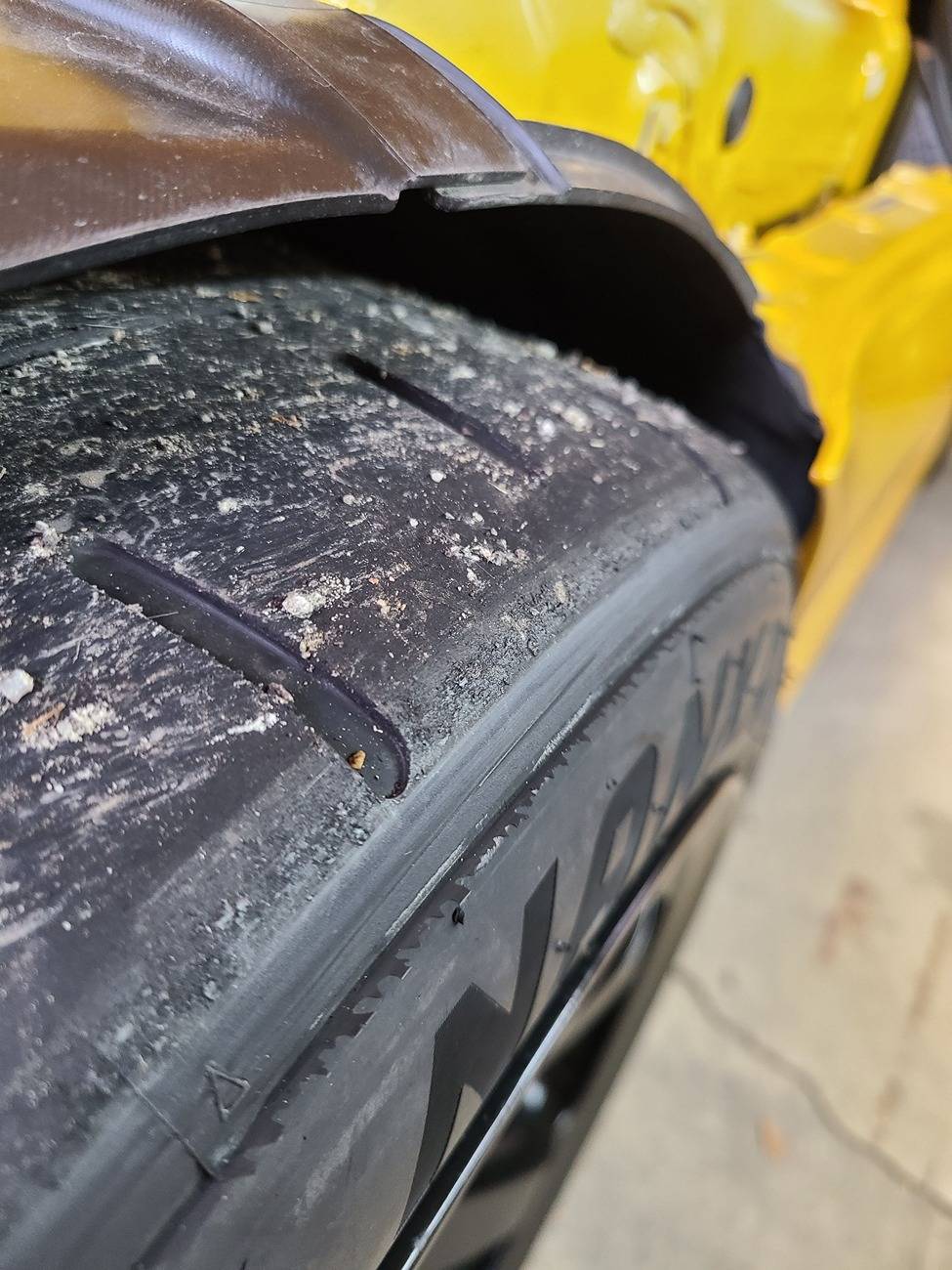

I should add, spacers are needed upfront for it to fit with the eibach springs. But tbh they're way too soft and you need more negative camber for it to not rub at all. I mis-remembered and you can see where the tire contacts rhe hood on compressions.

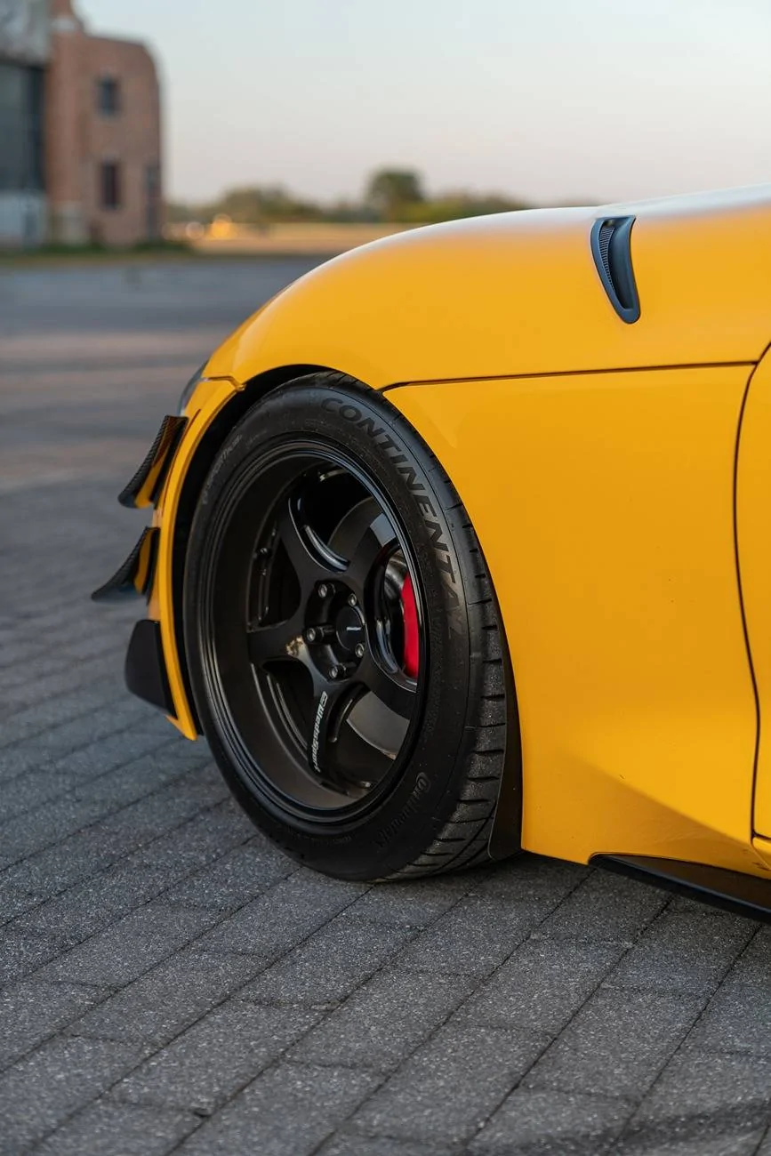

+25 shouldn’t need spacer for 275/40 @rwense @ky.supra but definitely more poke than yall with spacer. Haven’t been able to find anyone w similar setup on H&R yet
