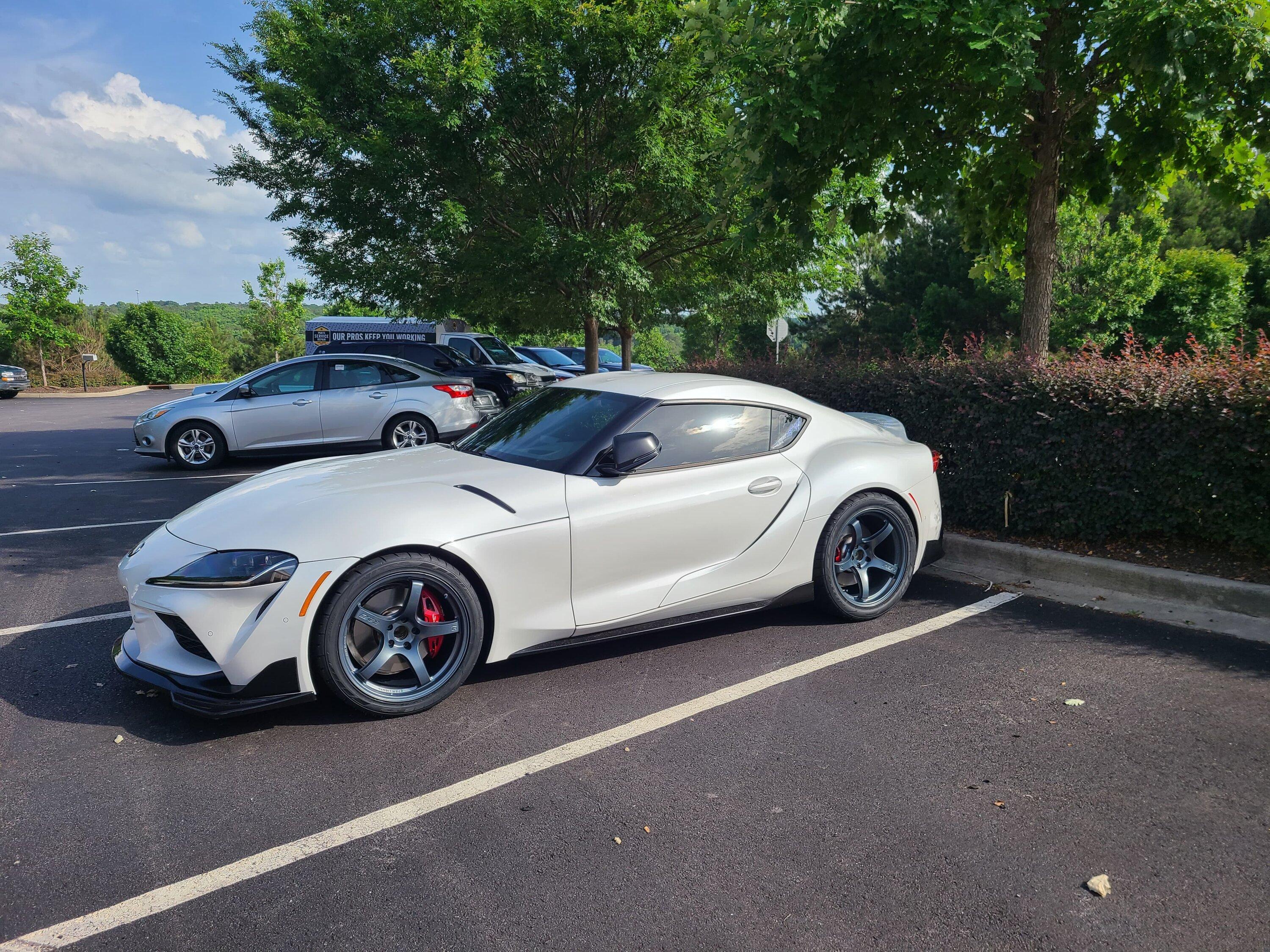

I believe @ArmenLS1 is talking about factory 10” wide rear wheels.
what are your rear wheel specs?

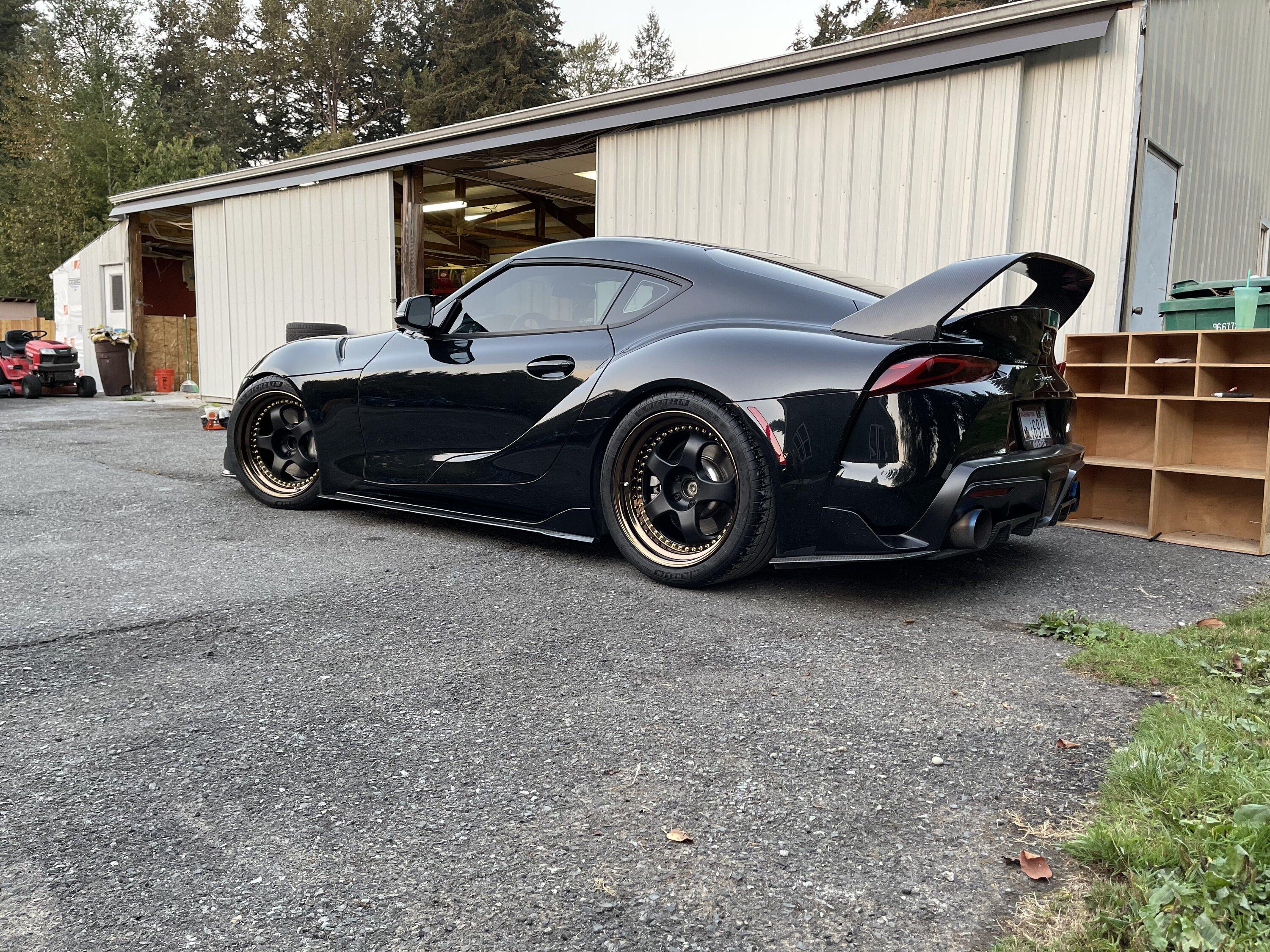

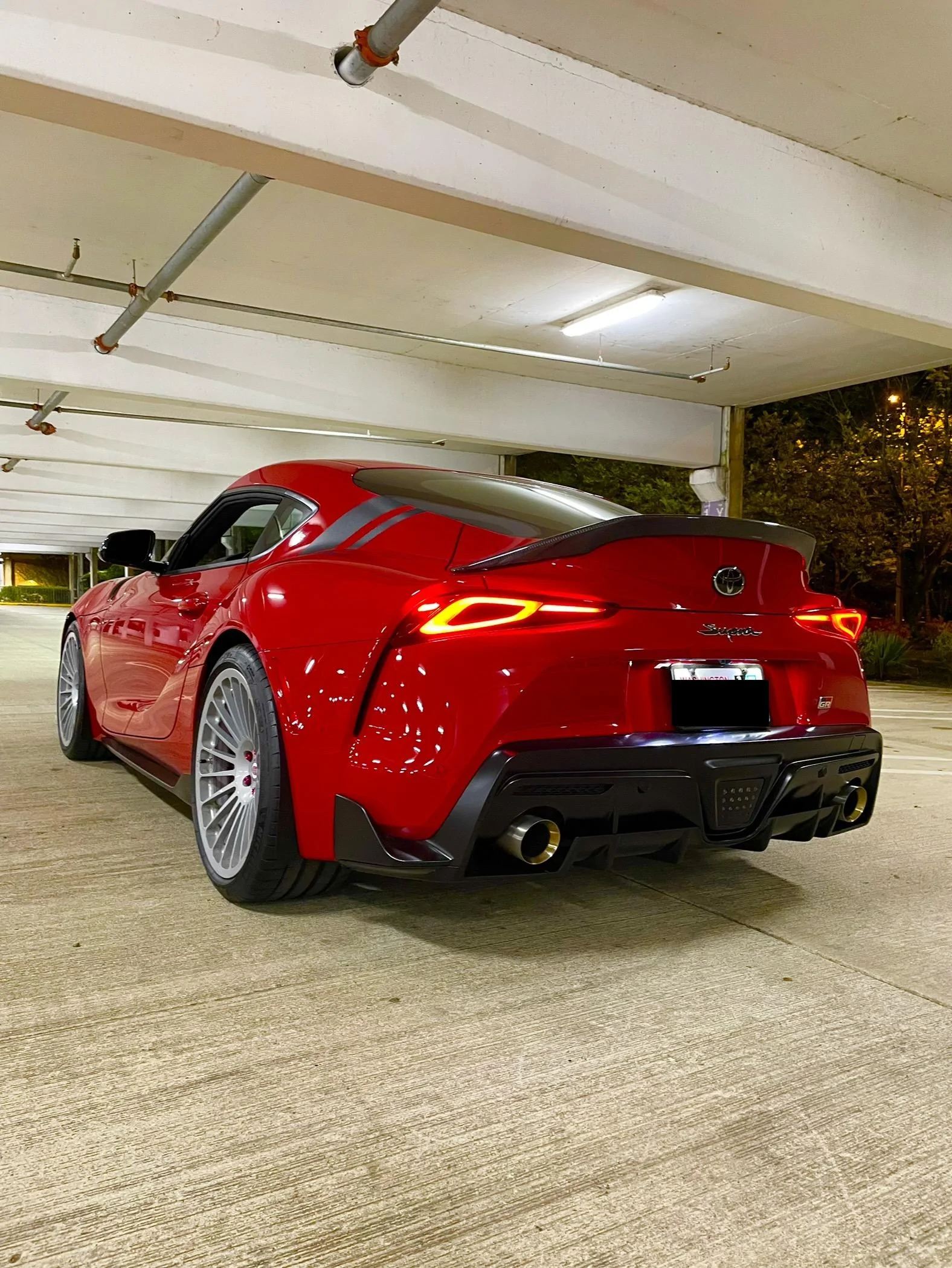

It will fit fine. I'm running Nitto Nt05
305x 35x 19.
No rubbing or whatsoever.

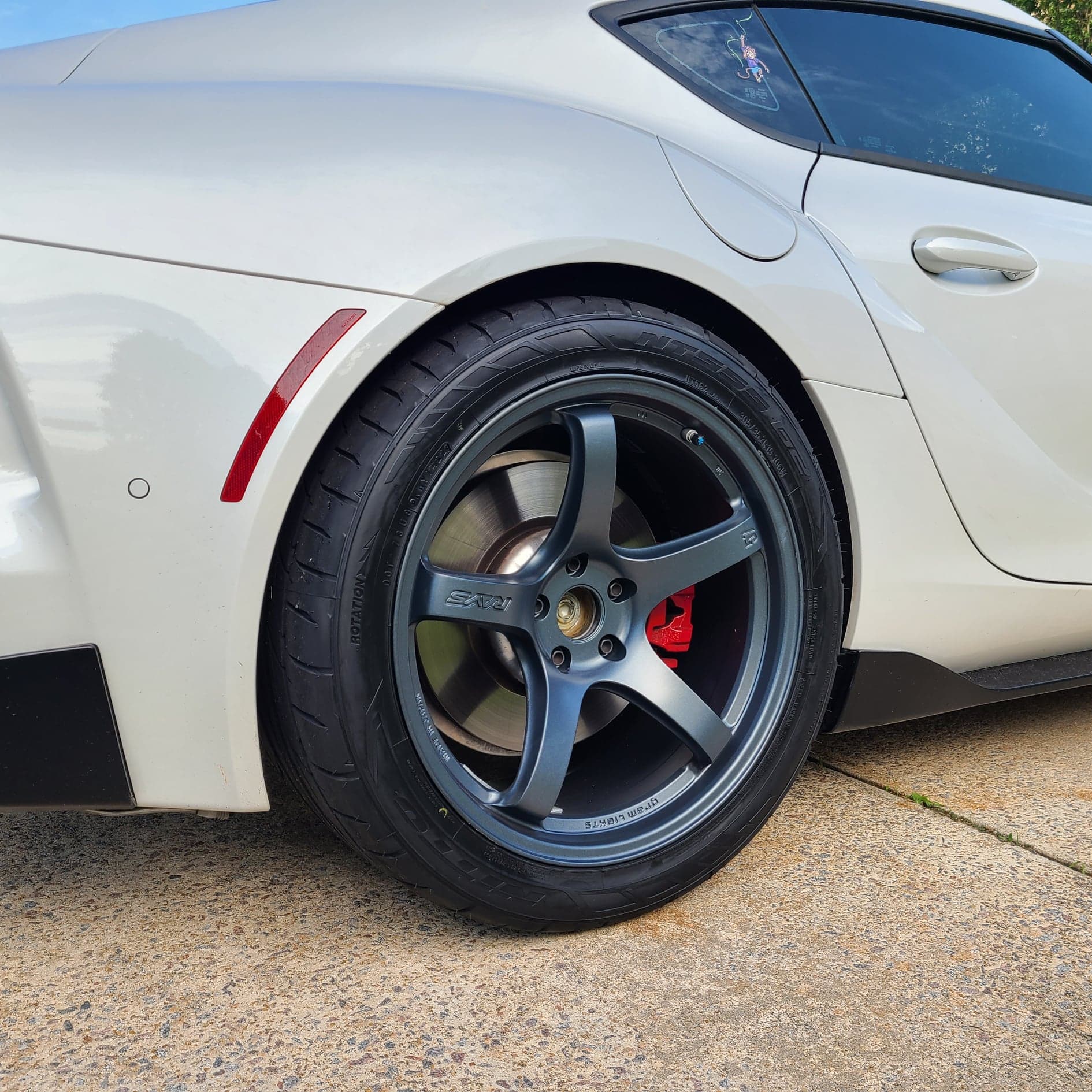

Love your entire build! Are those wheels Rays Gram Lights? I'm upgrading wheels now and love that look. Also going with 305 on rear. Can you tell me your wheel width and offset?
Supra 9
Jeff
Mar 4, 2021
116
133
Tucson, az
2021 Toyota Supra primium 3.0
This wheels is directly made for our car I believe the front is 19 x 10 and the rear is 19 x11 but don't quote me on this, the reason why I believe it is because it doesn't need any spacer for the wheel. And yes 305 is perfectly fit for the rear I'm running 305 x35 x19
