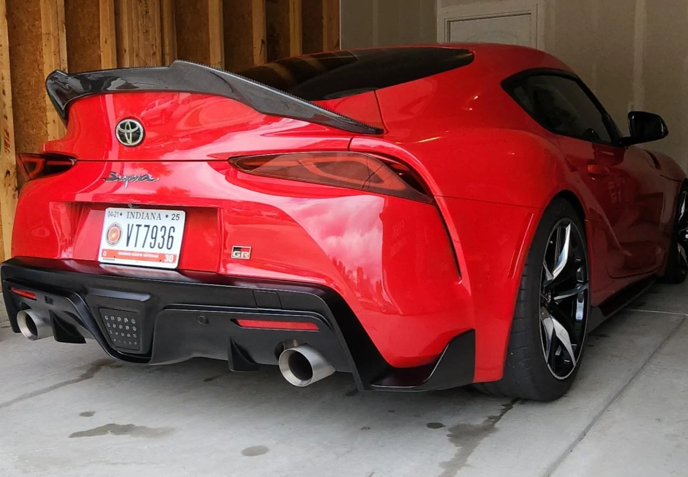

Whiteline brother. That’s what I’m on and went 295/35 in the rear! I do have a 10mm spacer but that’s just because the damn apex wheels are noisy.

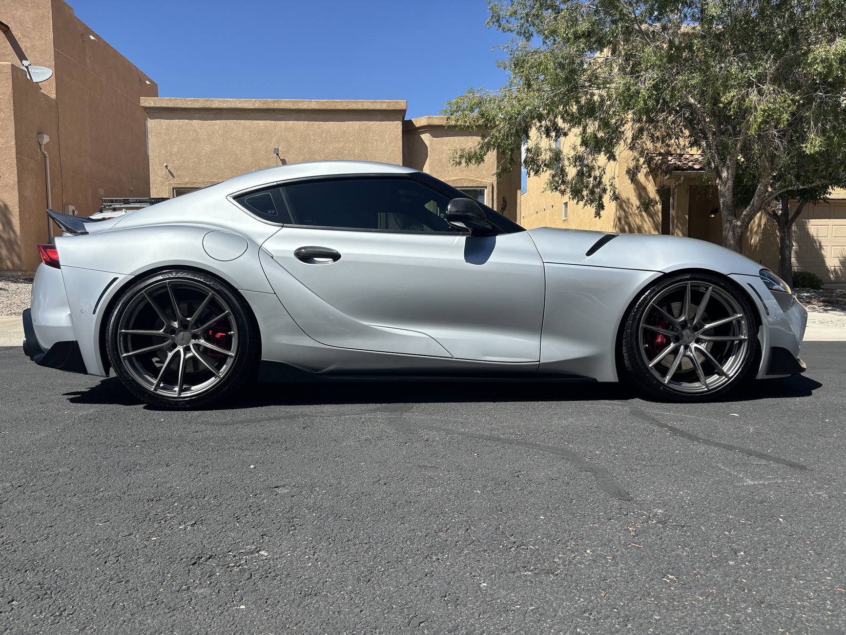

I am running BC Forged RZ05 with PS4S
Front 19X9.5 +22 - 275/35/19
Rear 19X11 +35 - 305/30/19
From my delusional experience, the wider the tire the fatter the side wall, if all other aspects remain unchanged, not sure why or how. For example, to me, the front tire running 35 and the rear tire running 30 looks just about the same thicc'ness.
I am currently back on stock suspension as the coilover rebuild needs 4 weeks due to parts shortage.
Photos attached for reference.
front tires are clearly taller than rear.
