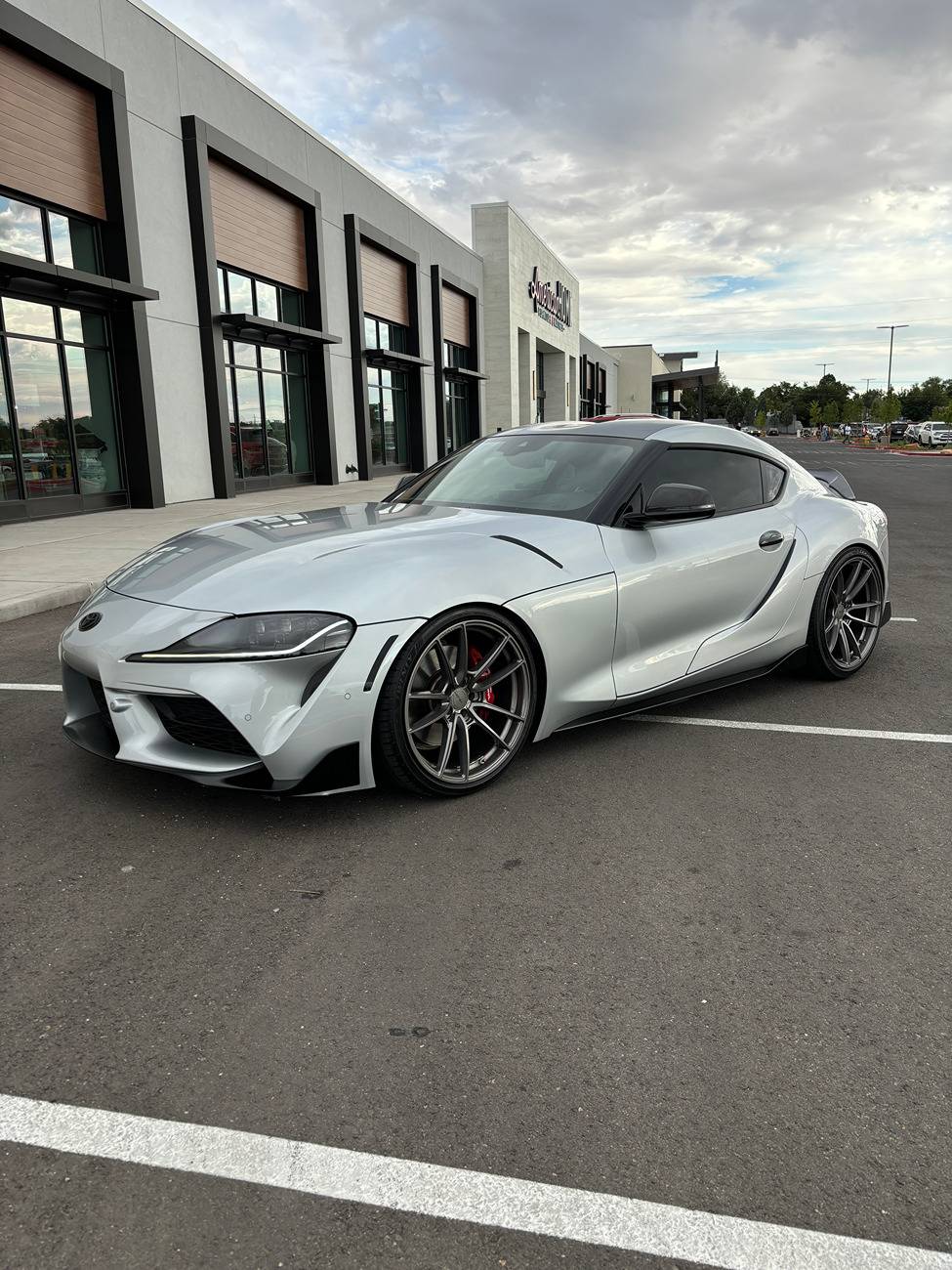

I'm intrigued by many who want more meat with a 35 i guess its preferred with a 19".
Here's 305/30 on 20x11 no rubbing, 275/30 front on 20x10 no spacers or rubbing... and let
me emphasize: Alb, NM might just have the worst Streets! Not enough of our Taxpayers $
goes to roads/highways. If i have a passenger in the car, the rear still doesn't rub.
