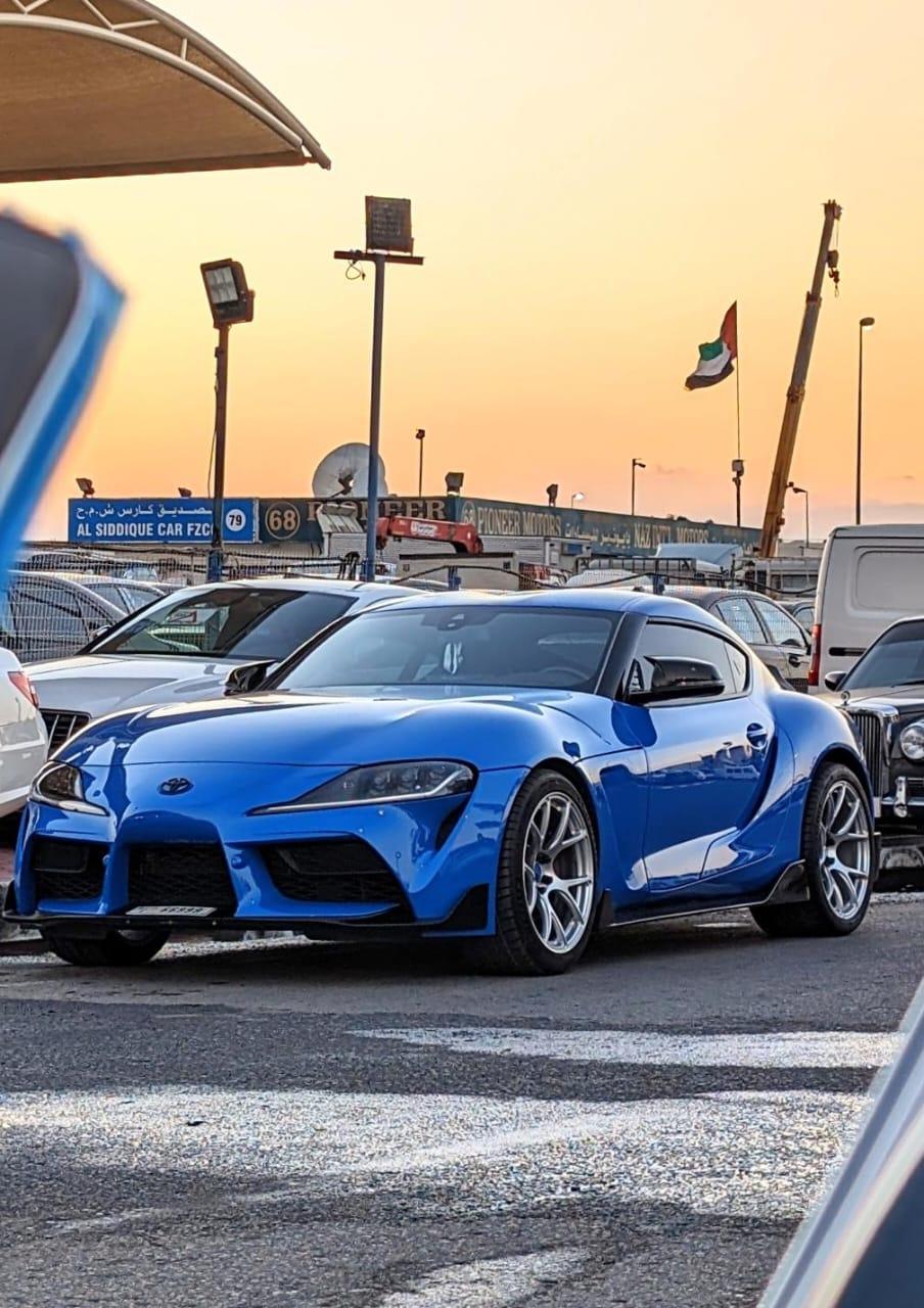

I am running BC Forged RZ05 with PS4S
Front 19X9.5 +22 - 275/35/19
Rear 19X11 +35 - 305/30/19
From my delusional experience, the wider the tire the fatter the side wall, if all other aspects remain unchanged, not sure why or how. For example, to me, the front tire running 35 and the rear tire running 30 looks just about the same thicc'ness.
I am currently back on stock suspension as the coilover rebuild needs 4 weeks due to parts shortage.
Photos attached for reference.

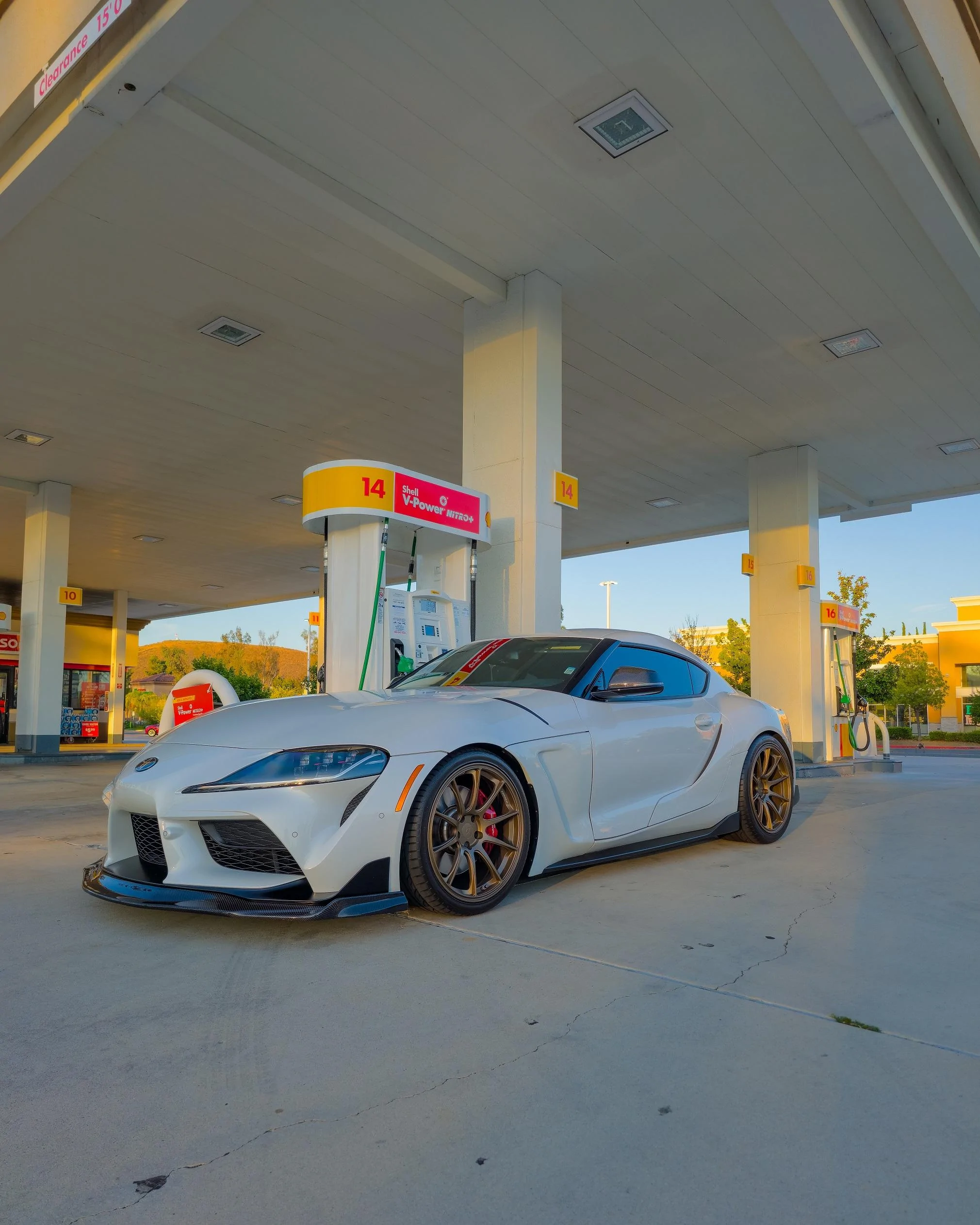

19x9.5+34 on 275/30/19
19x11+40 on 305/30/19
lowered on swift springs
Thank you for the photo, that sidewall is so thin and I think exactly why I want to avoid that size. Even lowered you have some gap in the front, my car would look silly on stock suspension.

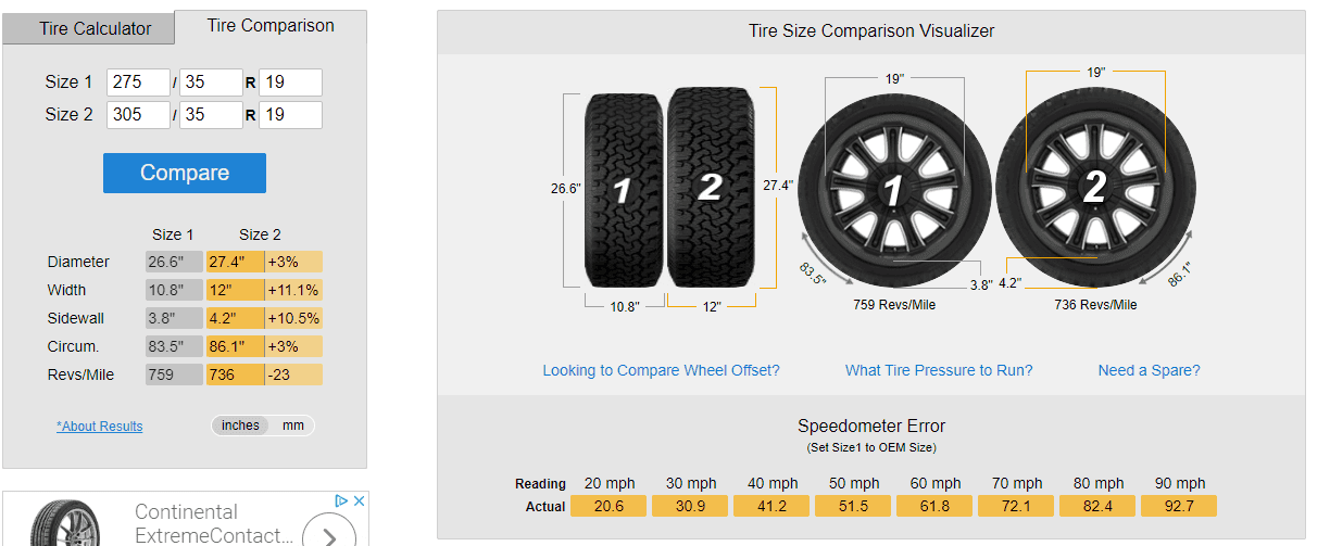

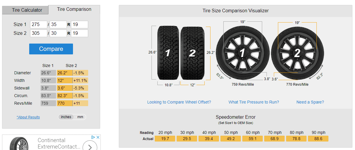

The reason the front tire running 35 and the rear tire running 30 looks just about the same thickness is because they are just about the same thickness!
The second number (yy) in a tire size xxx/yyR19 is called the sidewall aspect ratio. It is a percentage of the tire width. So with a 275mm wide tire, with an aspect ratio of 35 will have the sidewall height of 35% of the tires width (hence the 35 as the yy number). Math below.
275mm = 10.827 in.
275mm x 0.35 = 96.25mm
96.25mm = 3.789 in
Your 305 mm wide rear tires sidewall height is 30% of the width. Math below.
305mm = 12.008 in.
305mm x 0.30 = 91.5mm
91.5mm = 3.602 in
So, your front tires sidewall height is 3.789 inches and the rear sidewall height is 3.602 inches which is just 19 hundreths of an inch different. Visually, there is no difference.
A wider tire doesn't always mean a fatter sidewall. It all depends on that yy number. The sidewall aspect ratio. Below is an example of 3 different tires with different sidewall aspect ratios-- 30, 35 and 75
A 305/30R19 has a sidewall height of 3.602 inches as shown above.
A 305/35R19 has a sidewall height of 4.202 inches.
A narrower tire such as a 285/75R17 has a sidewall height of 8.415 inches.
Hope this helps!
