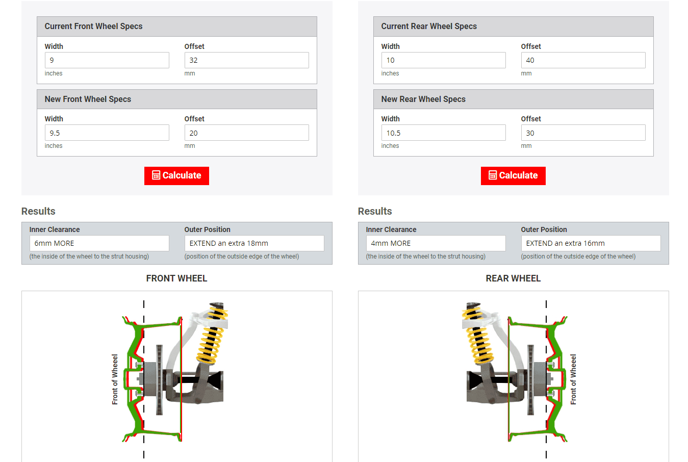

feitu232 Well-Known Member Joined Apr 19, 2021 Threads 22 Messages 74 Reaction score 18 Location PNW Car(s) None Apr 5, 2024 Thread starter #1 Hello, Anyone know if these will clear stock suspension? Thanks! Sponsored
Wilzzonn Member Joined Mar 1, 2024 Threads 1 Messages 18 Reaction score 27 Location NC Car(s) 2022 3.0 GR Supra Premium Apr 6, 2024 #2 This guy has a similar setup. https://www.supramkv.com/threads/18-te37-sl-saga-m-spec-on-2023-supra-burnout-white.20060/ use the search function and the link below. I've already input your information compared to stock in the image. https://n4sm.com/wheel-offset-calculator
