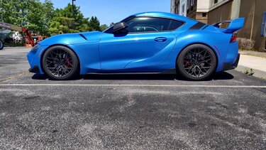

For wheels I can't recommend these guys enough:
https://www.litespeedracing.com/
I dropped 4 lbs per tire with the aluminum monoblock VR20 series, which is one of their heaviest and stiffest series of wheels.
The GT10 series is close to the same look as the Enkei GTC02s.
The RS5 series is close to the same look as the Titan TS-5s.
Pic with the VR20 wheels attached.
