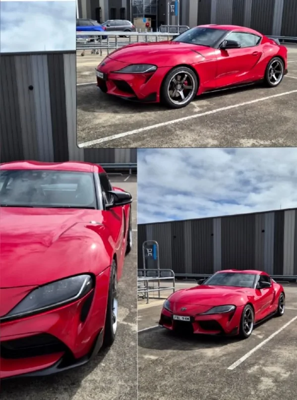

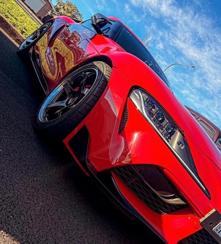

On stock suspension, no spacers, no rubbing, fits flush to fenders all around
Wheels: Yokohama Advan GT Beyond - Hyper Platinum Black (MPB)
Front: 19x9.5 +25 Concave face 4
Rear: 19x10.5 +32 Concave face 5
Tyres: Yokohama Advan NEOVA AD09
Front: 275/35/19
Rear: 295/30/19

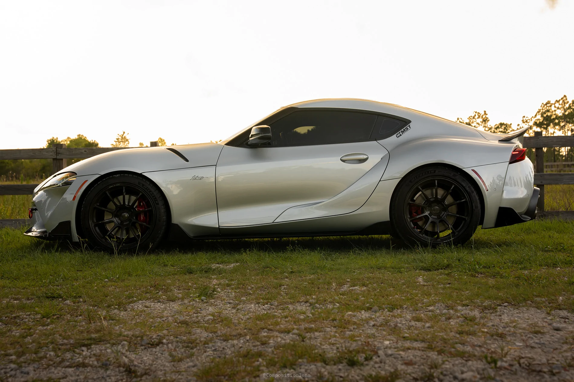

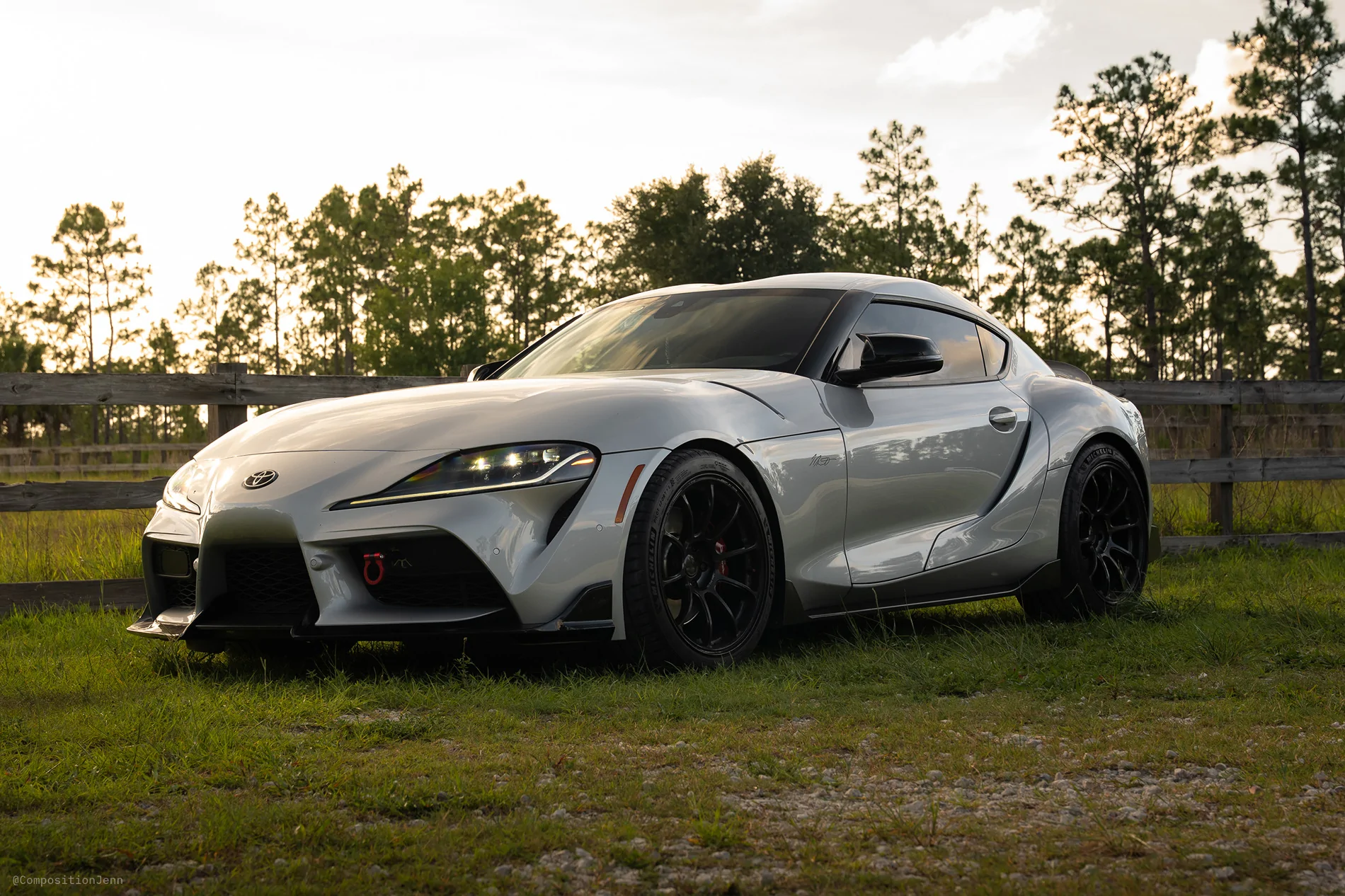

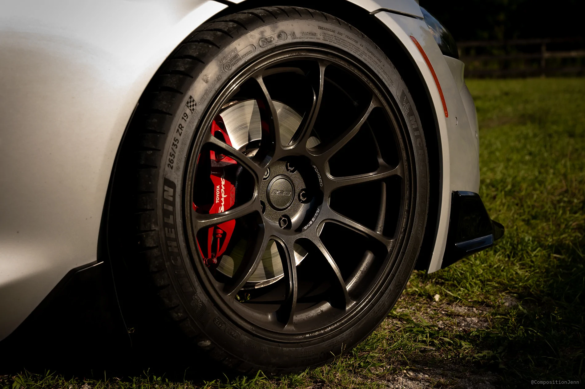

2021 3.0 Premium Silver

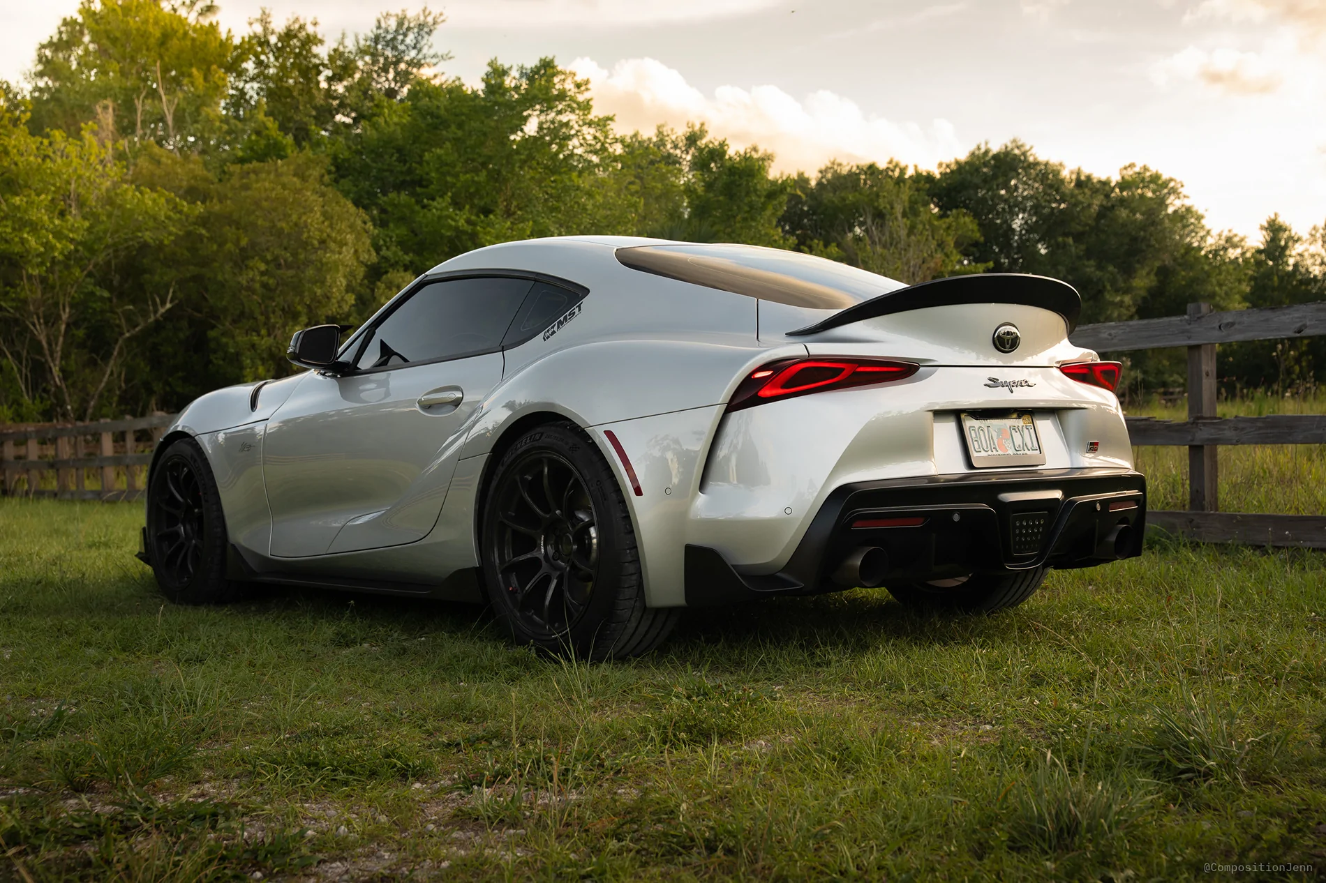

Rays ZE40's 19x9.5 +25 / 19x10.5 +35 - Diamond Dark Gunmetal (And dirty, unfortunately)
Stock suspension / no lowering springs.

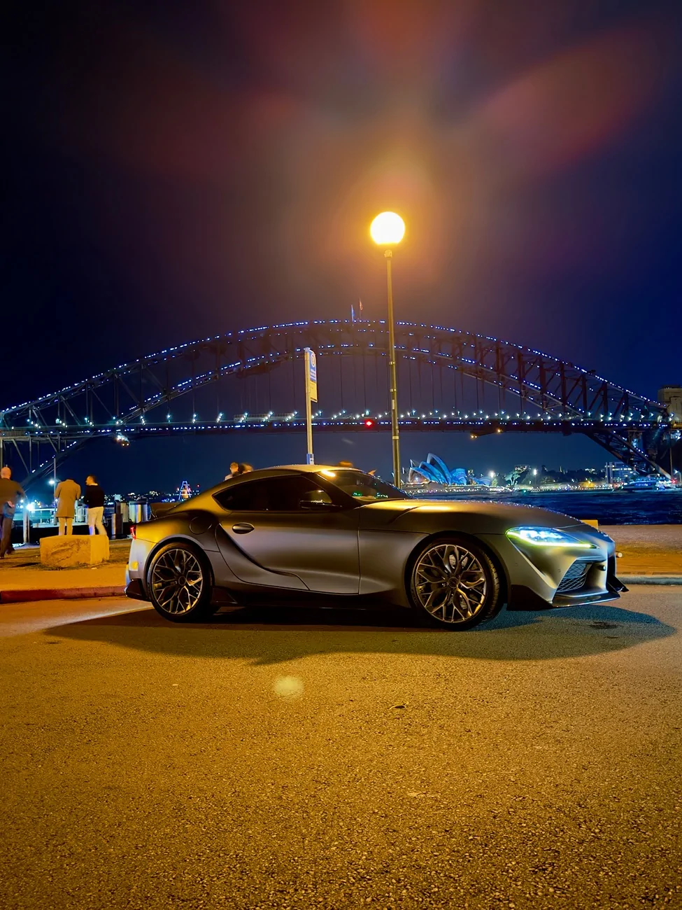

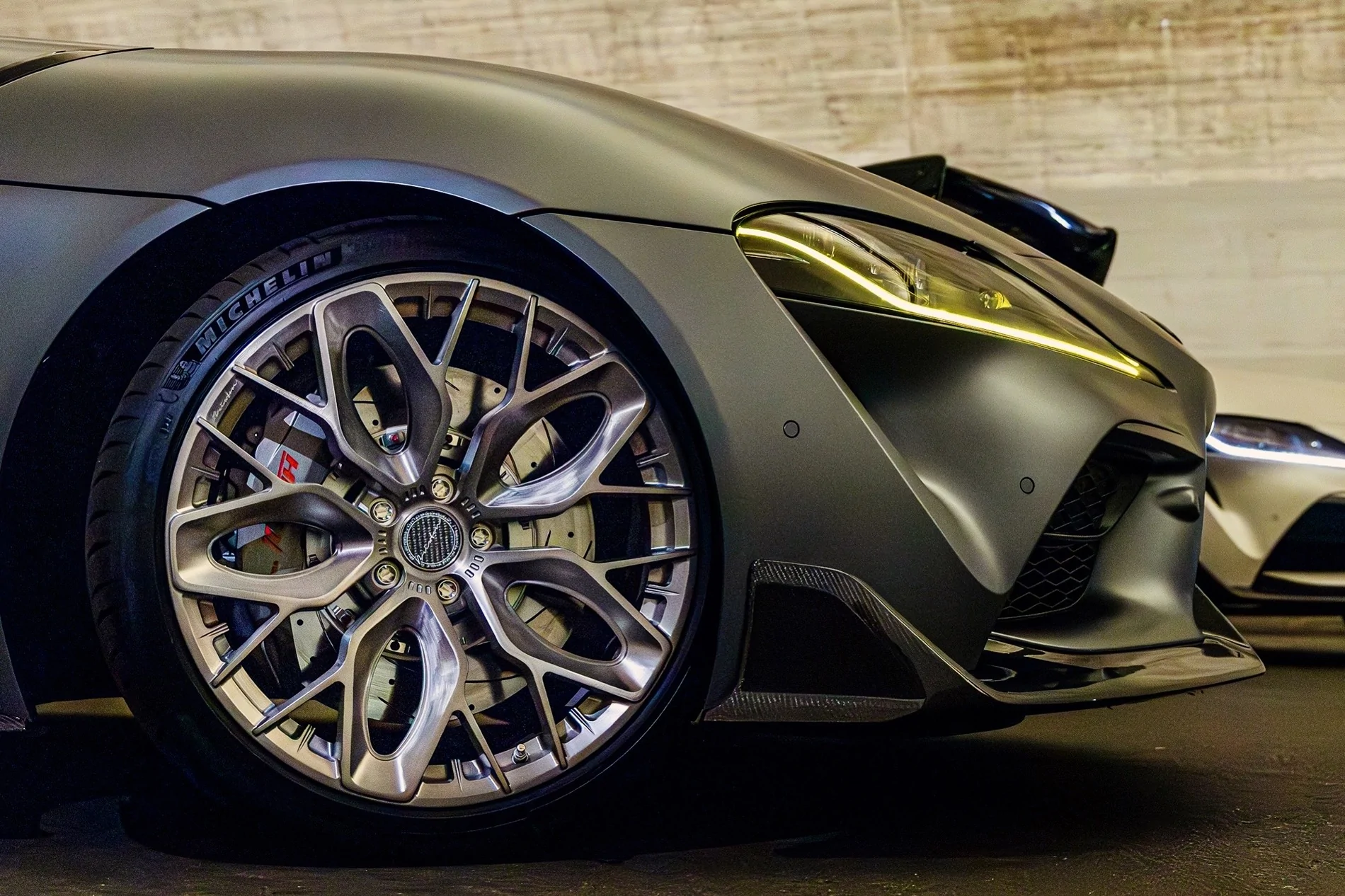

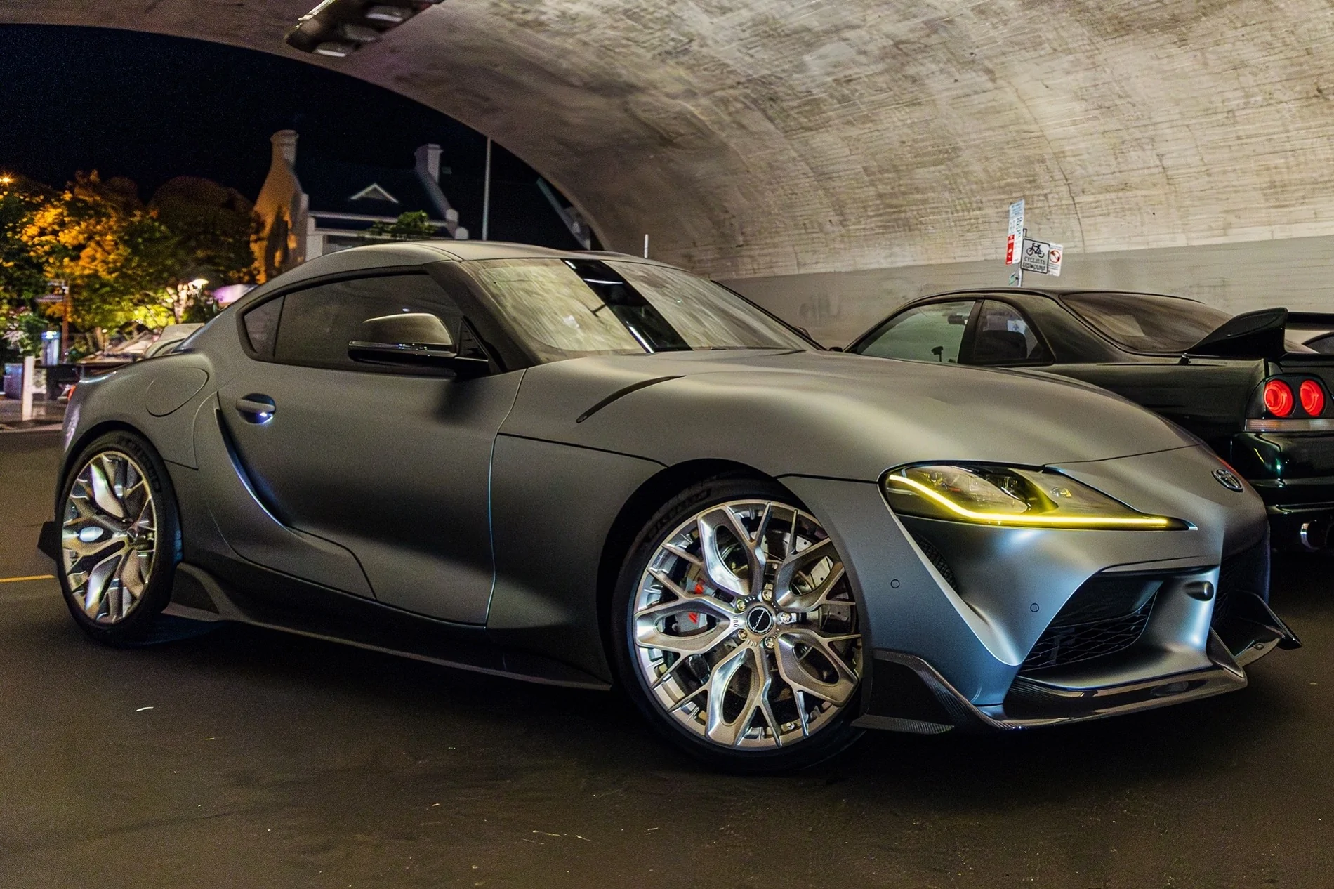

These are 19x9.5 et23 front and 19x11 et38 rear on stock final edition.
The setup looks sick 🔥🔥
I haven't try but does it accept 18 inch wheels on stock suspensions (18x10 or 18x10.5 squared)??
I got the same model but i'm not sure about the fitment, i want to buy aftermarket but for track days and the stock for street.
illidelph
Jan 5, 2026
Chicago

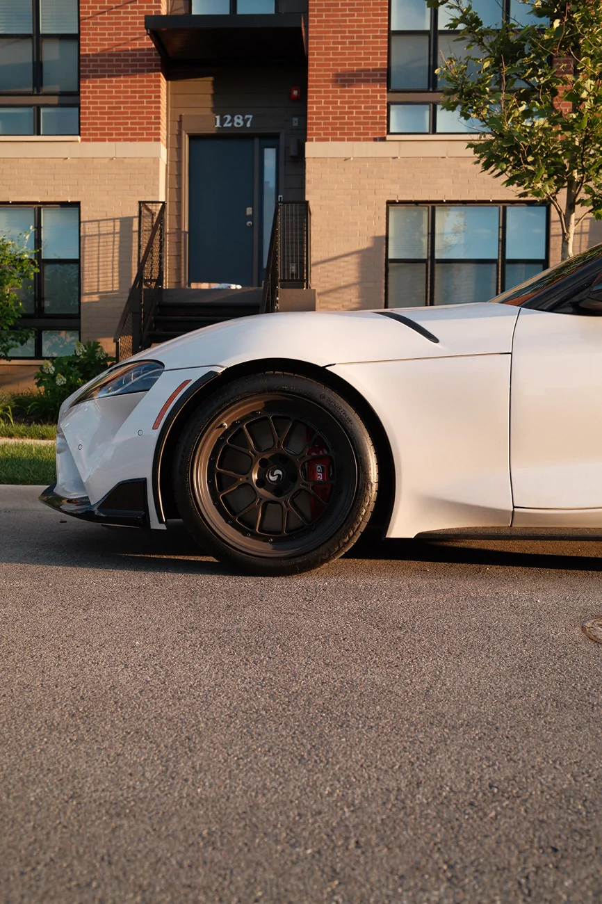

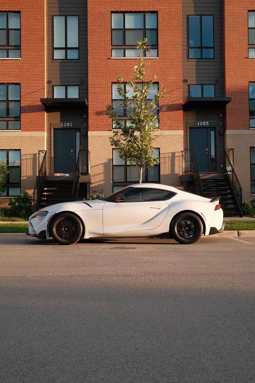

2026 Supra FE
Not without suspension changes. There's a lot of threads about 18 inch square fitments around the forums I'd search for them.
