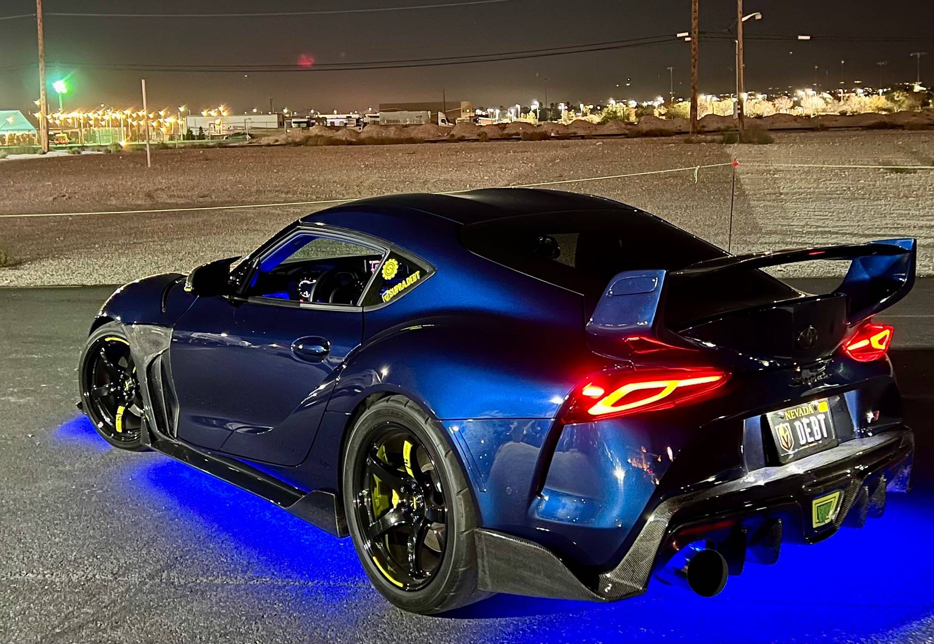

I’m in the 305/35 camp also. Fronts are 255/35 the way the car came when I bought it from the PO, ill change them to 265/35 at least when its time to replace them.
