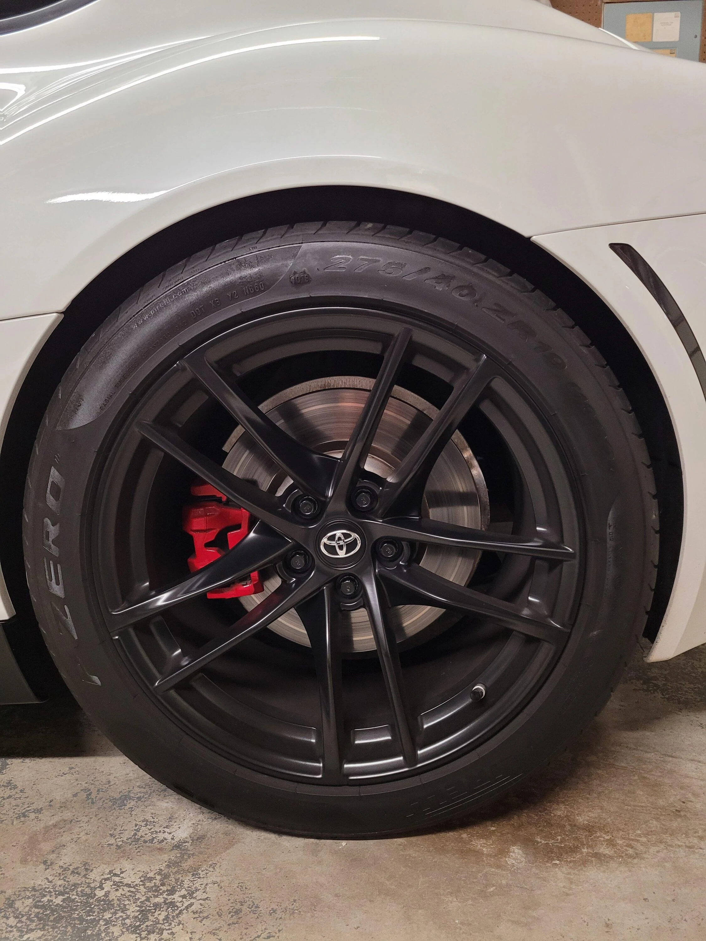

hey guys is 305/35 with stock wheels and suspension all good without any rubbing or sensor issue? i cant find anything about stock everything running 305/35 thanks.
Landon
Sep 8, 2025
United States
2024 Nissan Z
I’m running 275/35/19 in the fronts and 305/30/19 in the rears on stock suspension with no rubbing issues. Might opt for 35 in the rears when it’s time for new tires to fill in some of that gap, but honestly the most I’ve noticed compared to stock tires is just more road noise which doesn’t bother me.
Are your back wheels 19x10.5?
