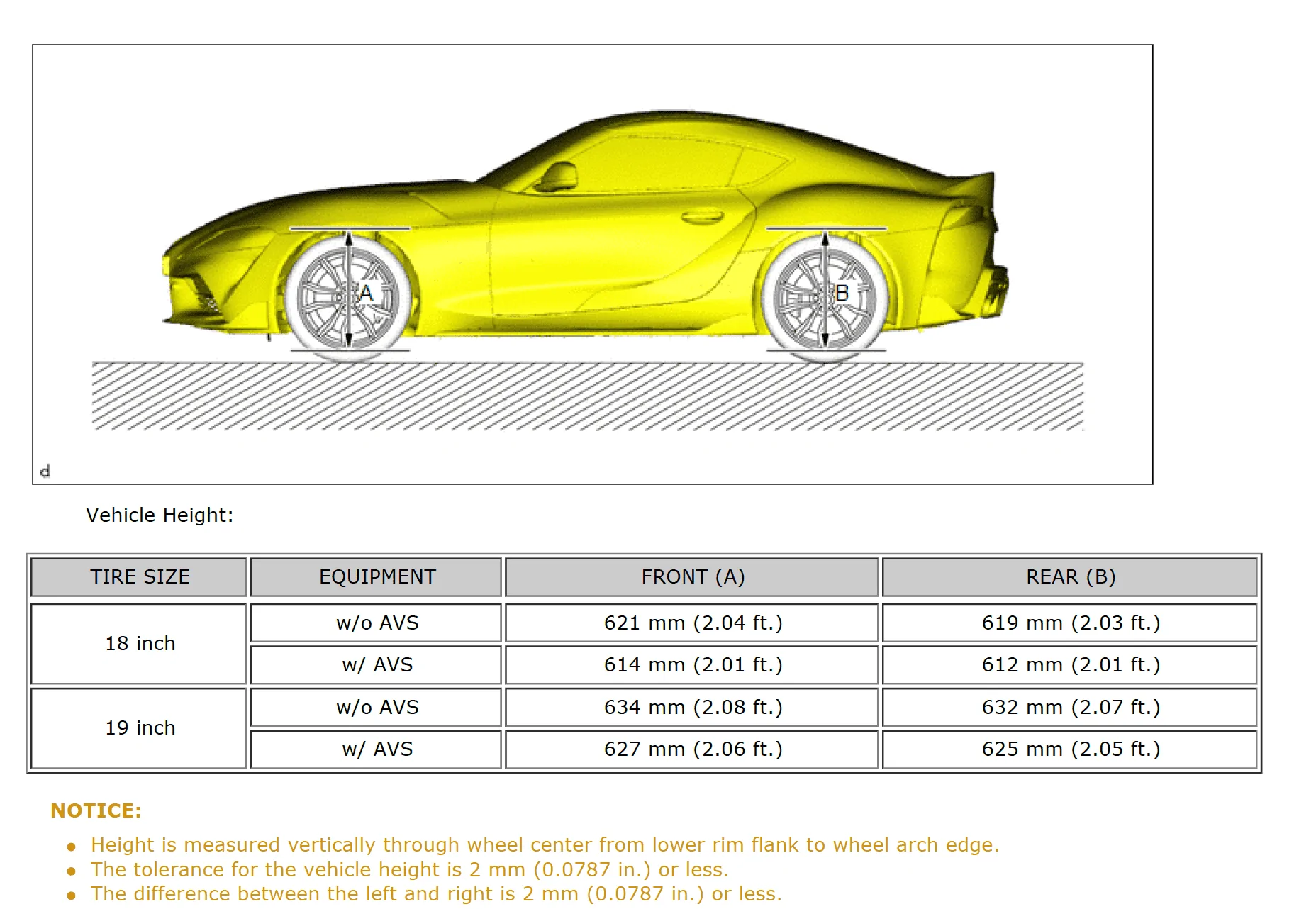

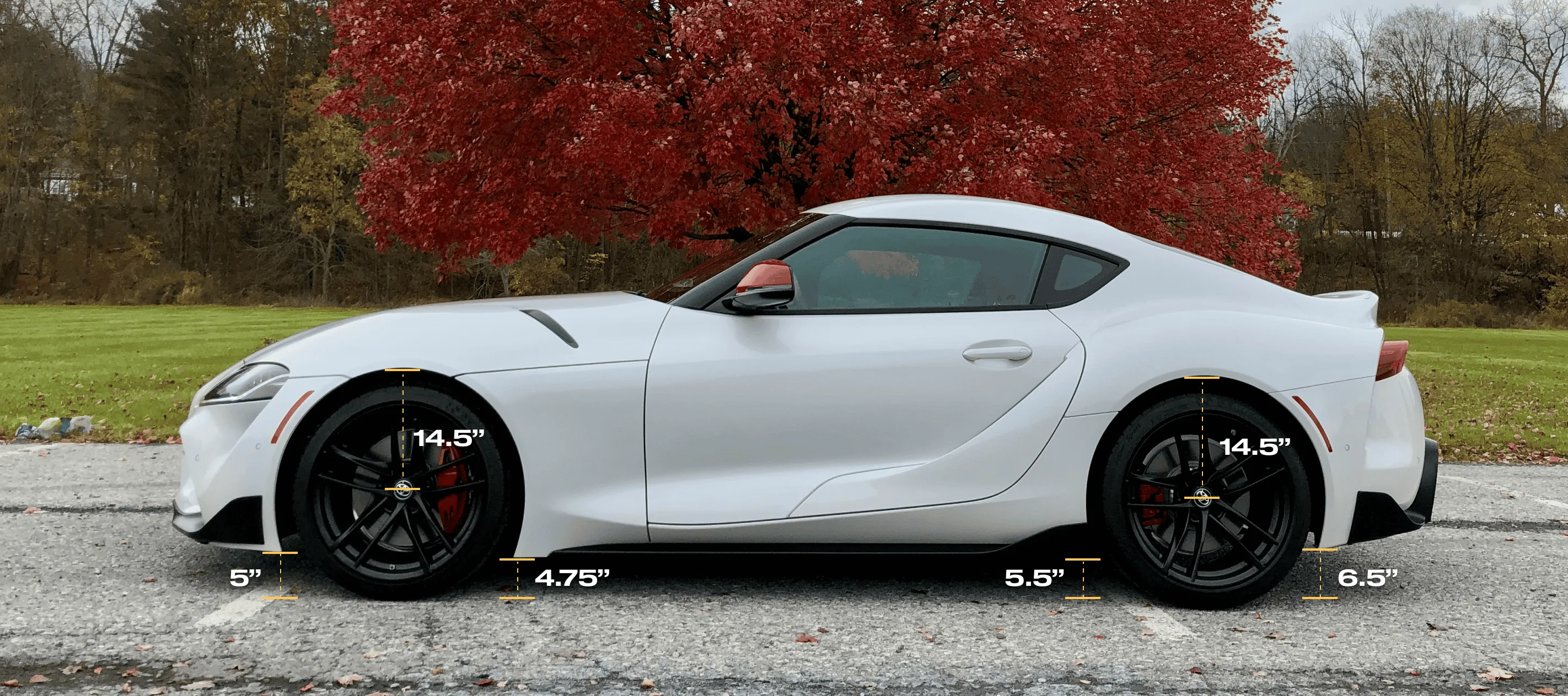

Not sure on rake but I can give you OEM height measurements so at least you have a baseline:
Measured from center of wheel to fender, 14.5" front and rear

Yes, rake is usually front lower than rear.. My 2020 is on stock suspension and has some rake as she should.
Negative rake is usually referred to as the 'boat look'.. and not very practical for performance oriented cars as it's too rear heavy.. unless I suppose some drag cars..(?)

OEM body to ground and ride height numbers I measured when my car was stock:
Thanks buddy. I'm wondering if I should put a positive rake on the car however or just have the height differential stay 0 as I am seeing your photo.

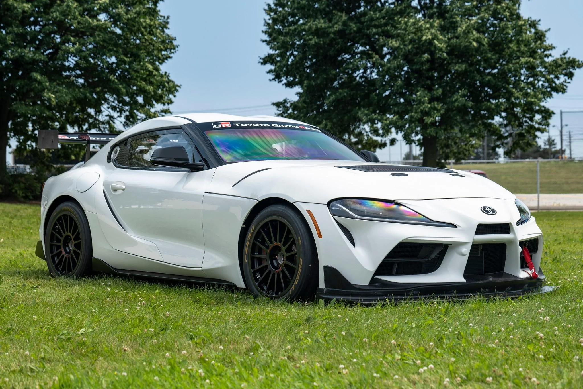

OEM has slight forward rake (Front lower than rear) and I added a little more with my setup as I have a front splitter.
Also the Supra GT4 has a good amount of forward rake as well:

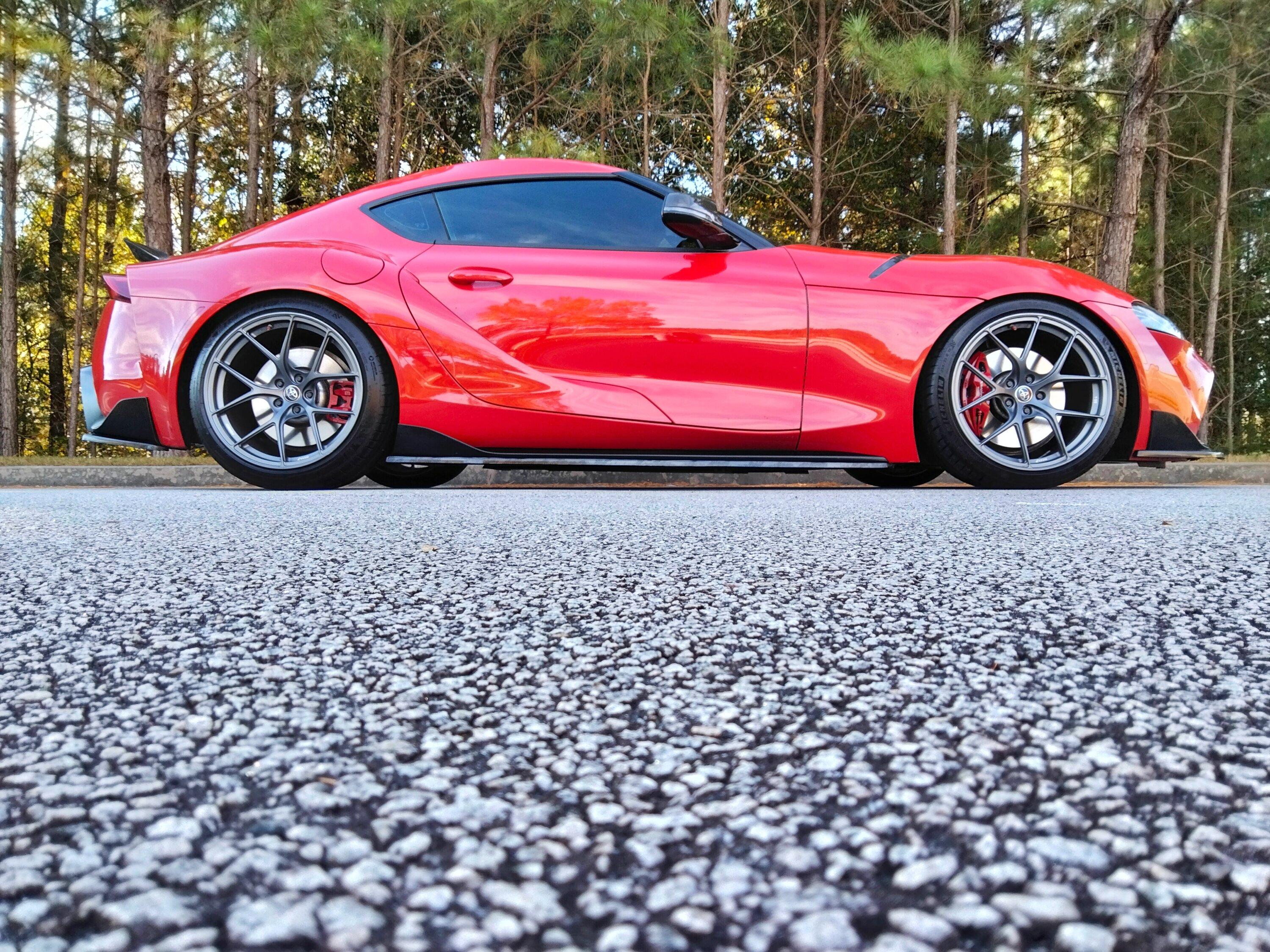

2021 Toyota Supra 3.0 Premium Renaissance Red
I always felt the Supra looks too high up front(negative rake) on stock suspension, even if it isn't but after a 1.2 inch drop all around I can see the positive rake plus I can see the road better through the windshield.
