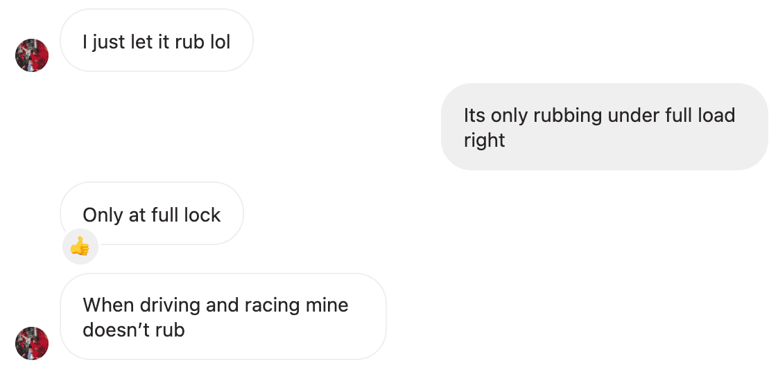

I asked Jackie Ding about his setup 275/40/18 square and he said

Im on stock suspension/rims atm so no rubbing on full lock. My plan is going Ps4S*OE wheels once Michelin starts producing tires in 4-6 months. I needa figure out rim replacement tho
