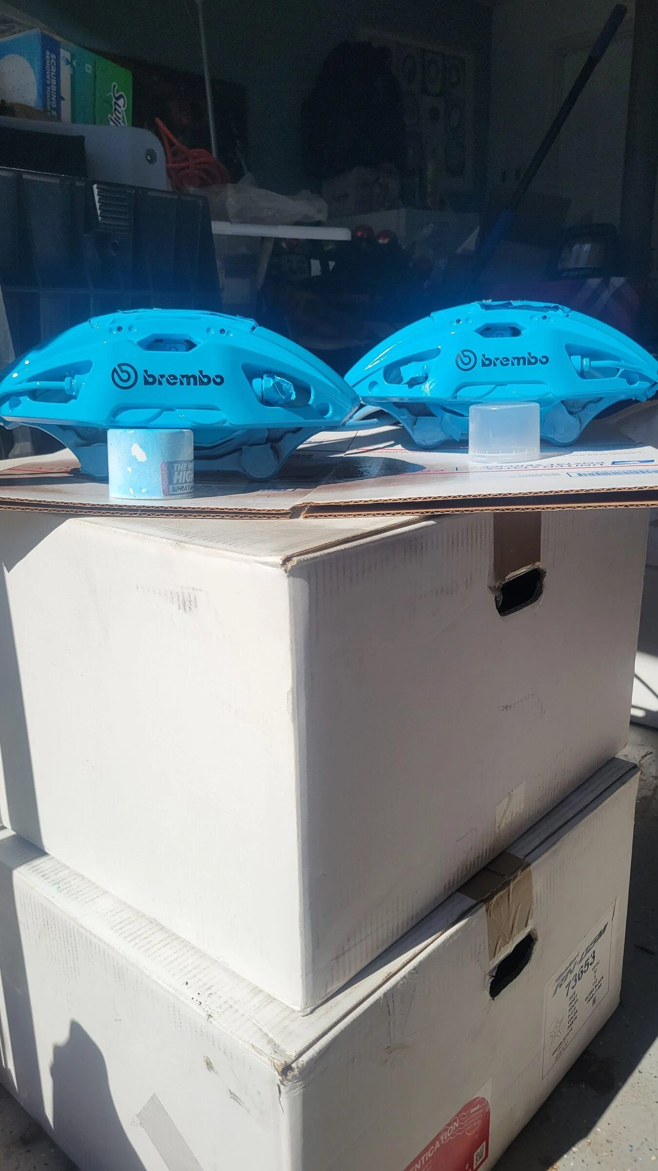

thanks.coz i saw on ebay used only for 4kmiles for $900 just the caliper.and im planning to get it powder coated.

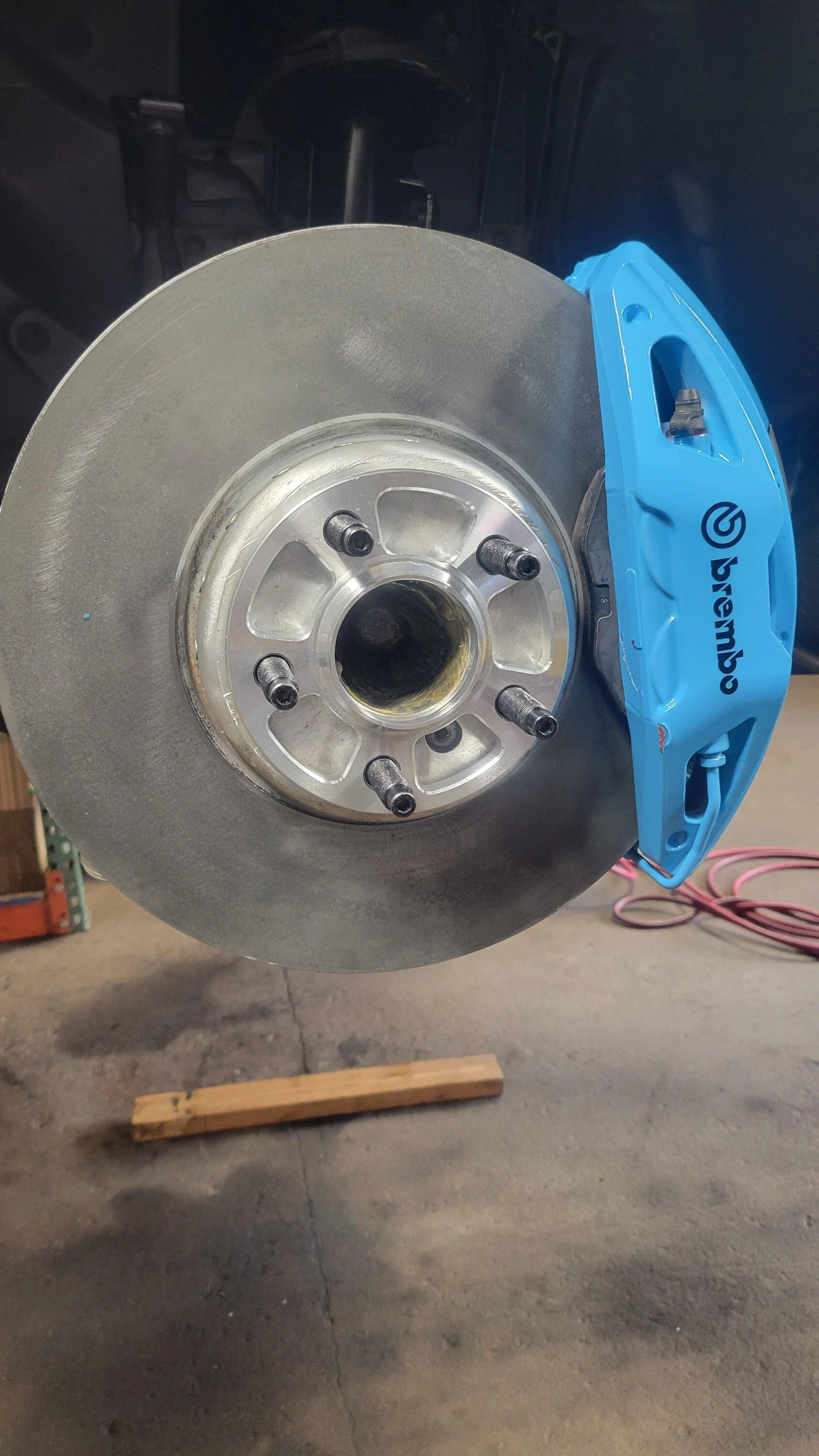

Car dropped on shop yesterday ,spring,rims,spacer, lug nut onversion and brembo from 3.0 being installed.havent heared from them as of today.hopefully all goes well.ill stop by on them tomorrow and check.then I'll post update.

Car is not done yet but the 3.0 brakes is direct replacement on 2.0,even the brake lines.
