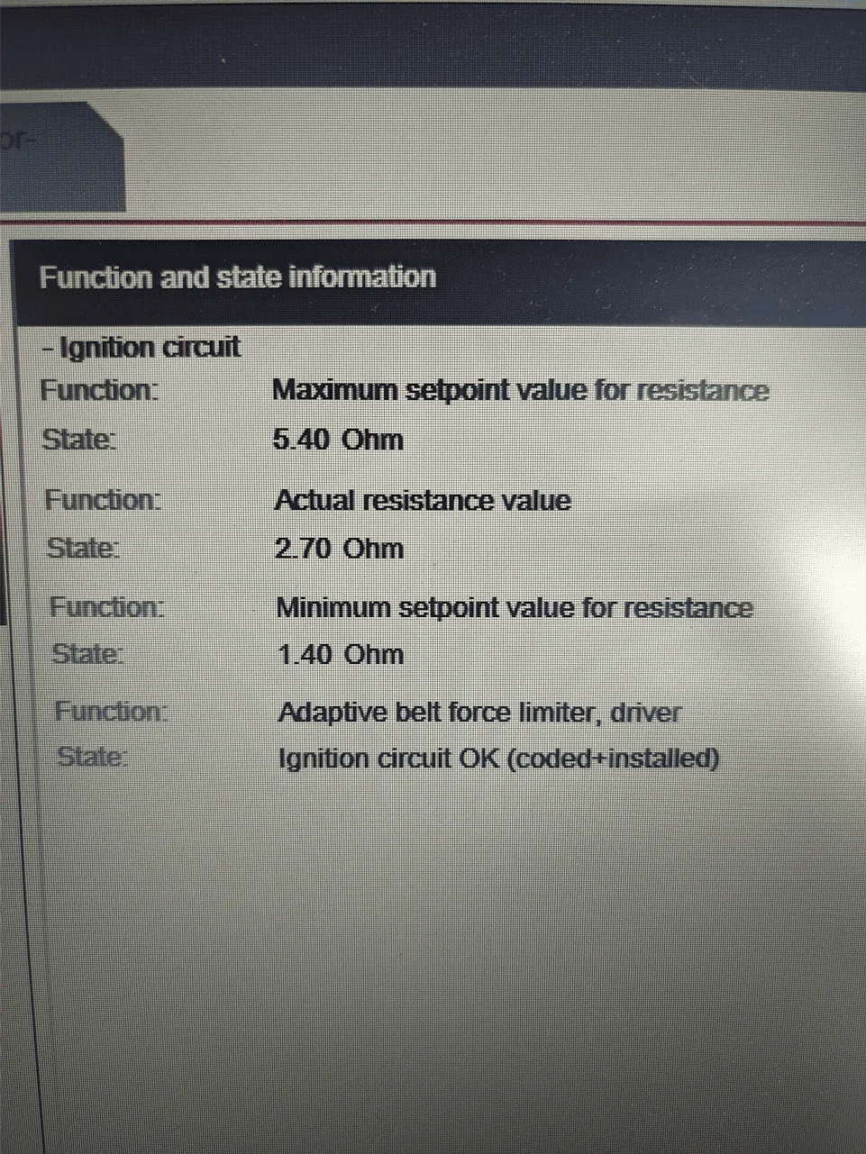

I completely agree on the harness. Can slip out since too wide.
Just SEMA things, I guess.
Easy way you can defeat the airbag on the Supra by with 3.3Ohm resistors.
The Supra's circuitry uses resistance to measure if the airbags are there.
Or as you mentioned, find someone that can code it out.

Care to describe how easy it is to defeat the airbag light?
Easy to code out. If youre unfamiliar with BMW coding someone can remote code it for you for $100 or less.

@razorlab Care to describe how easy it is to defeat the airbag light? I can tell you on my 2018 Porsche it was a PITA. I had to retain all the airbag hardware including the bladder that measures weight and store it in between the seat mount and seat. Then I had to recode the car with a Porsche specific OBD2 reader to tell it to reset the airbag. I have Carly which can do similar things on BMW's but never tried to do this particular thing to a BMW so I have no idea if it will work.
Also, I spoke to a guy today who said that the older ECU (2020) is easier to deal with than the 2022+ ECU. I gather the older one allowed programming and the newer one may have some hack prevention or something that makes it harder.
I feel like between a rock and a hard place. Everyone keeps saying its "possible" but until its proven, well, that seems like a pipe dream to me.
Not a pipe dream. Proven and easy. ? I even wrote up a how-to:https://www.supramkv.com/threads/airbag-error-lights-warnings-easy-coding.14617/

I have a 2016 BMW M3 - I've used Carly with that car with my iphone - anyone know if that would work?
Having done this, it will only get rid of the airbag error. You will still have the seat position error.
