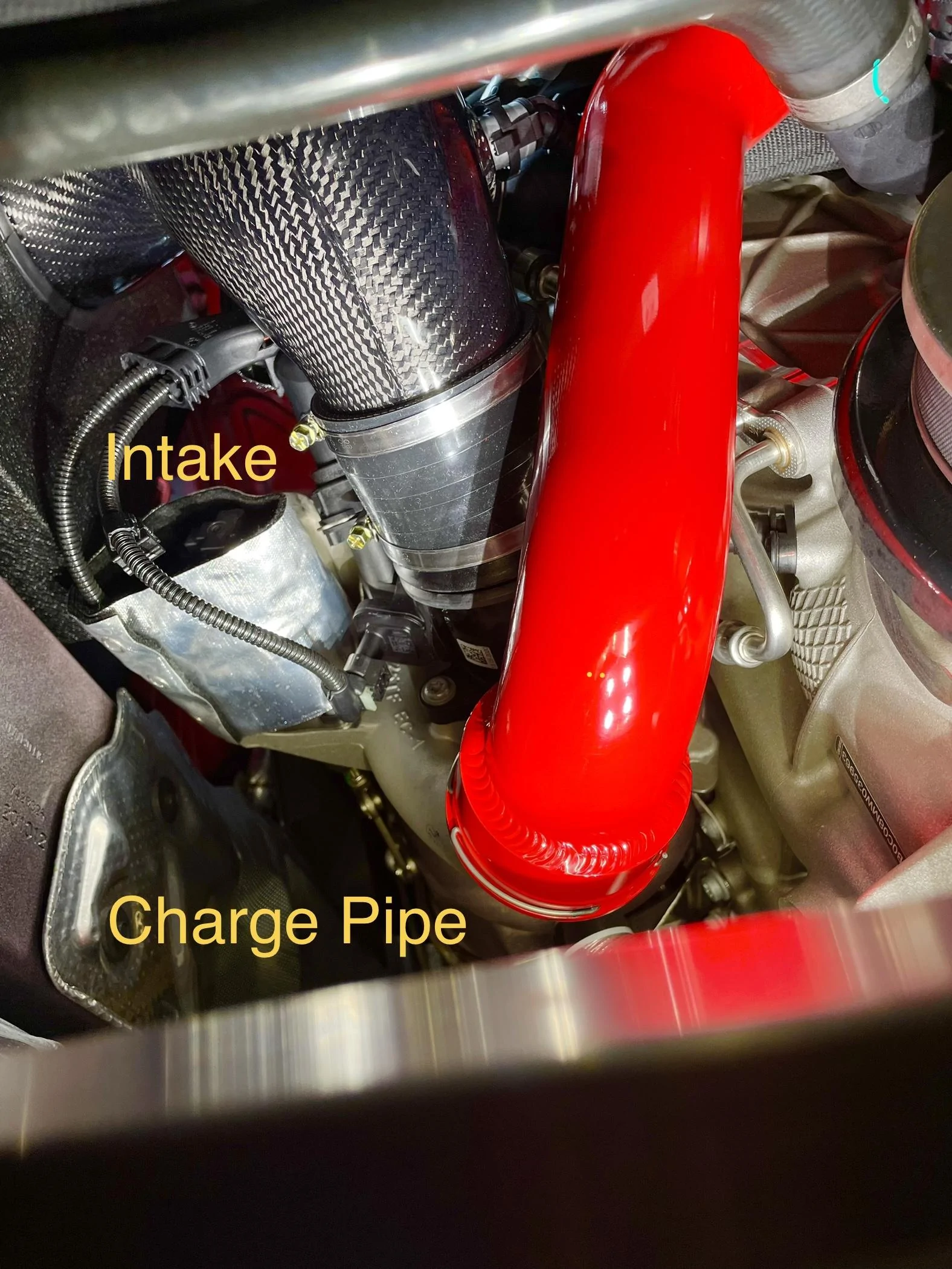

Sometimes a visual helps. Here is one for reference.

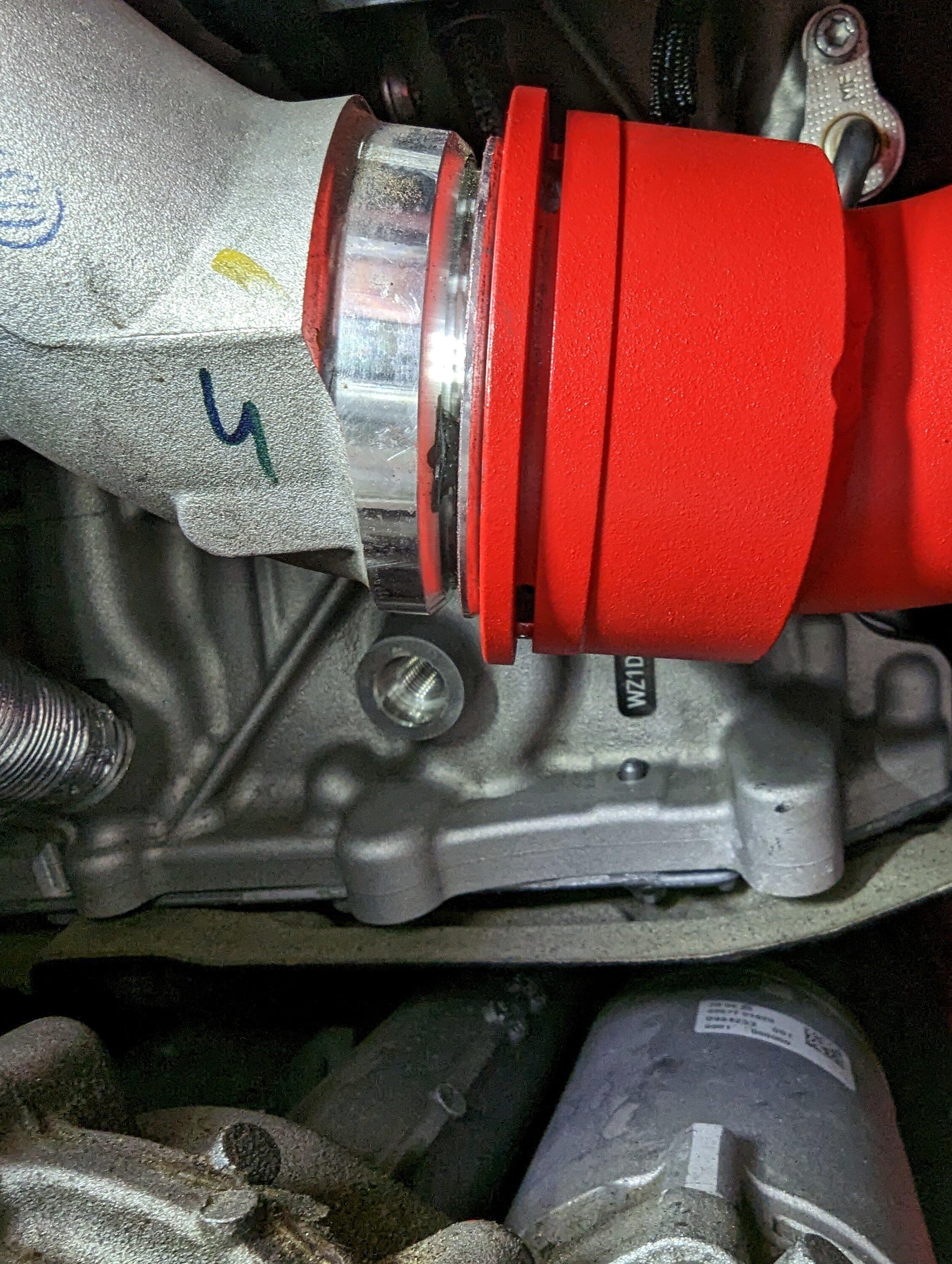

Talking with the place I bought it from too. I tried it with or without the clip and it will not fit over the lip on the turbo. I still need about 10mm to have the place where the clip is, actually snap in.

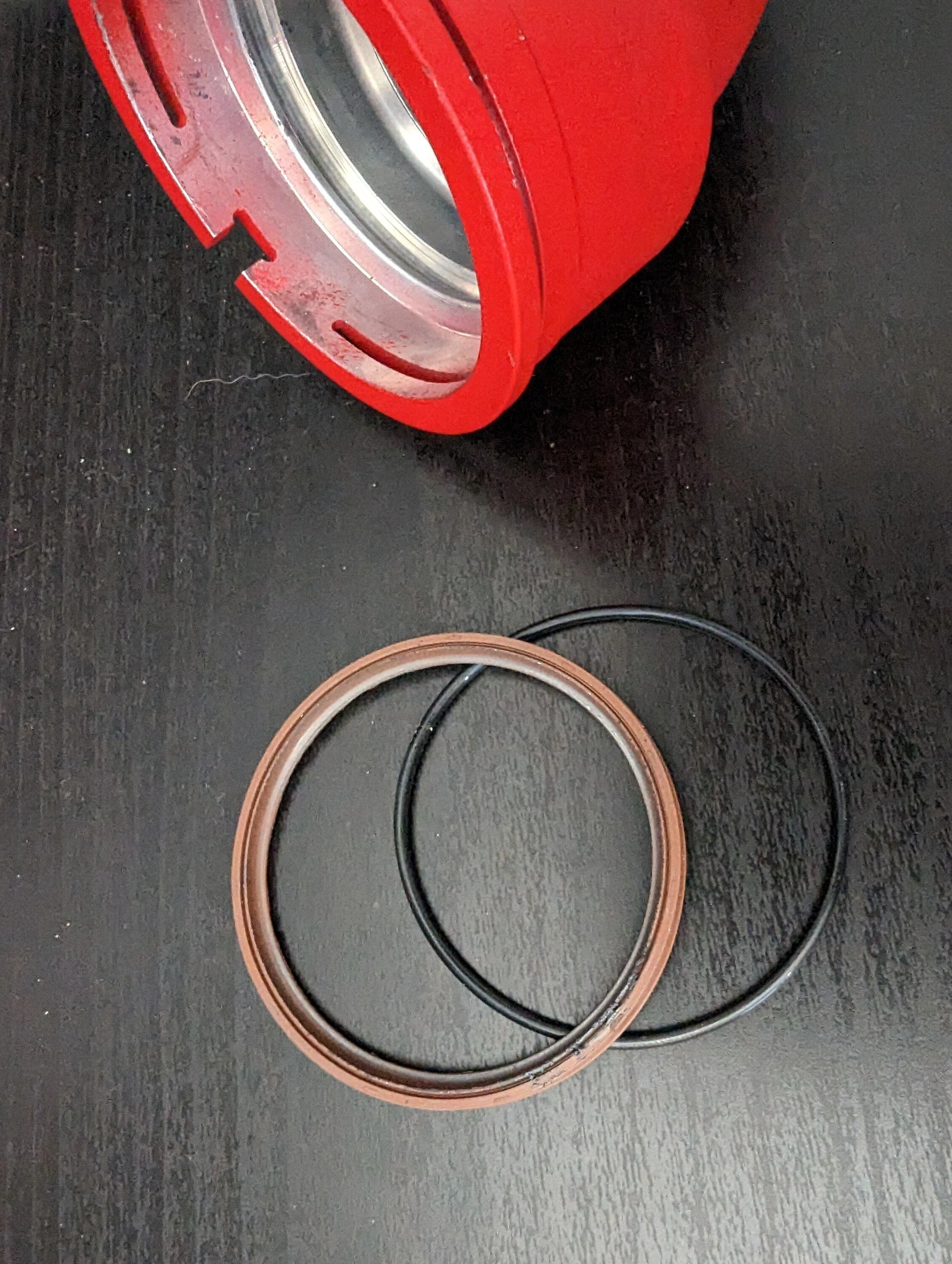

So I finally got it installed, after talking directly with FTP. The shop I bought it from was no help. For anyone that may run into this issue, there may be two seals/o-rings installed on the turbo side of the pipe. FTP said you can install it using only the brown seal, and to remove the black o-ring from the pipe. (It is hidden well and you wont even be able to see it next to the brown seal when it is in the pipe). They said you can use vaseline to help it on as well. Just make sure to reinstall the brown seal the same orientation as it came.
