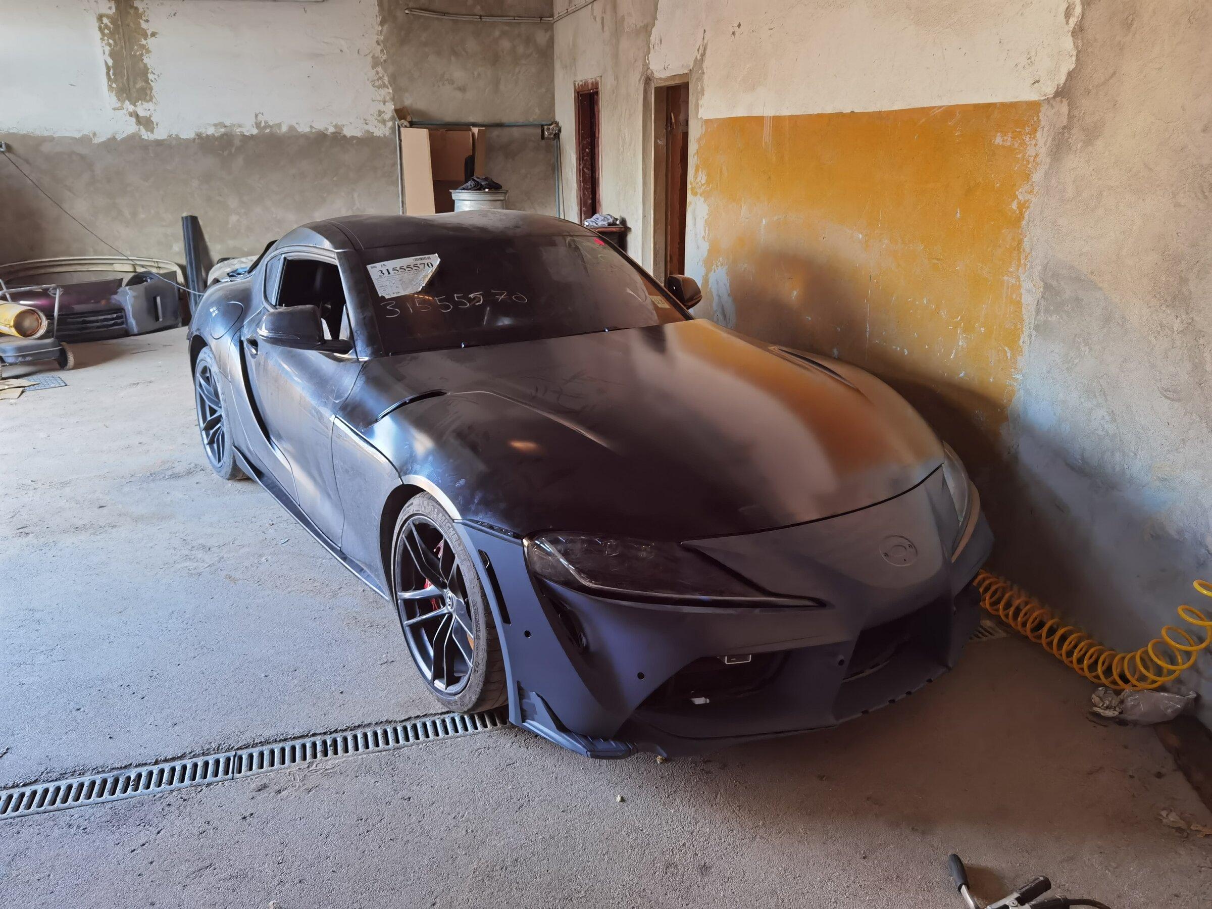

So I managed to start the engine today and move car around for the first time. Really happy. ?
IT was a fuse foult, but not the one on the + terminal. It was the power control unit fault which is located next to the DME. It was broken from the impact and the 30 amp fuse which were inside were blown. So I just glued whaever I could find quickest and 10 minutės later car runs. Luckily it shielded DME from an impact. I will have to search for a good power unit now. Is there any diference between bmw lineup?
