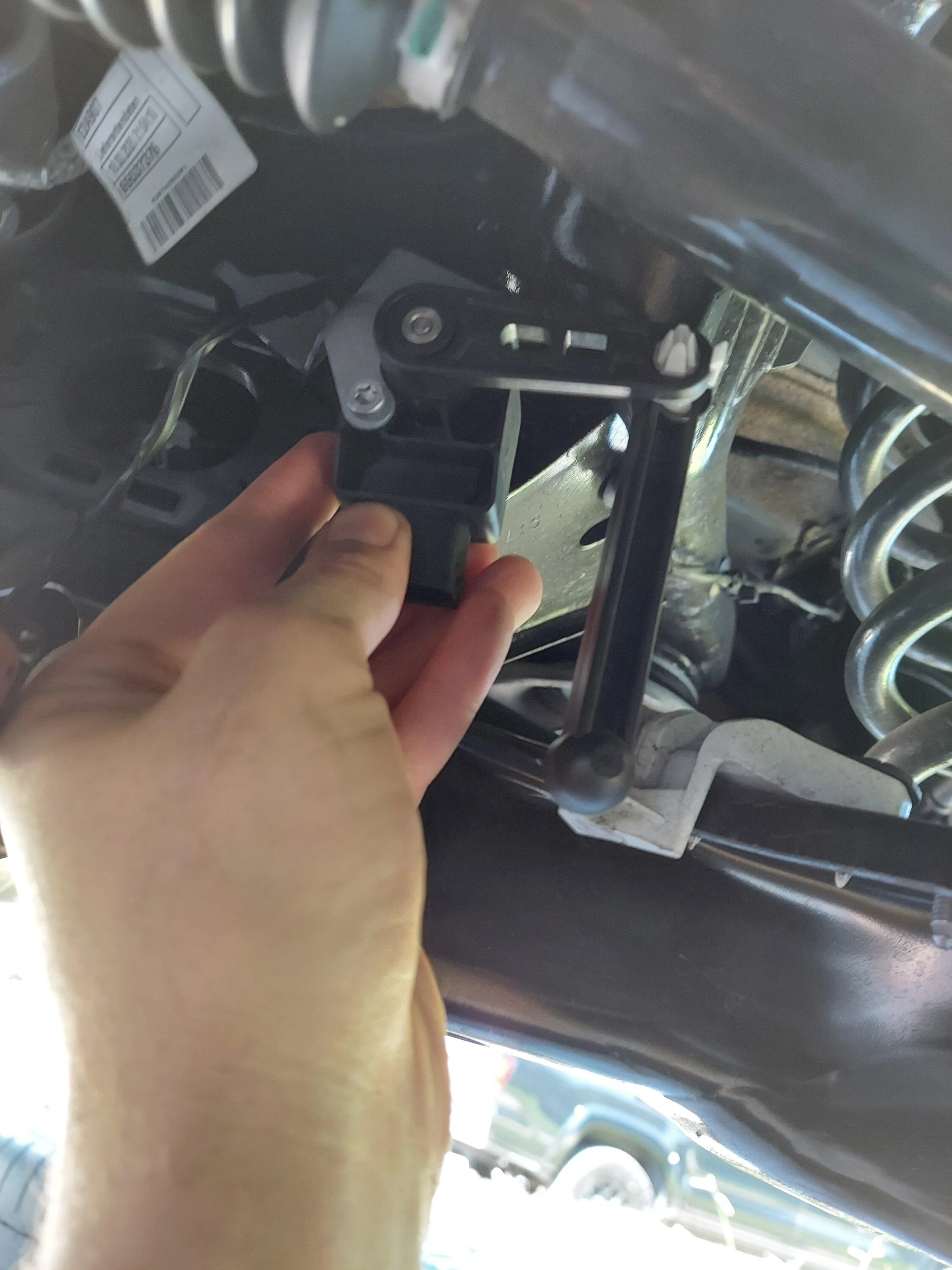

Hot take, don't be lazy and unclip the ride height sensor, risking damaging it. Unbolt the top of the mechanism where it's mounted to the car, it takes 30 seconds.
The top portion unbolts entirely and is super easy.
Also take a picture of the orientation. It might seem obvious, but when you're tired later you could forget since the arm could angle either direction and look correct when it's not.
I don't know if the 2022 are different but I was not able to unclip it. I just removed the nut, bolt, or screw. But Yeah I forgot to take a picture of the front and I think I removed a screw and bolt and I forgot how to put it back together until I found a pic online.
