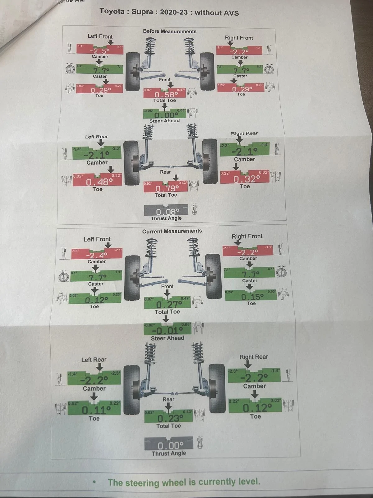

I scoured forums looking for perfect specs to recommend my shop and ended up just talking to a few shops and what they could/ would recommend as far as specs go.
I waited about 3 weeks ~350 miles after I installed my springs (mainly bc I couldn’t find a shop willing to do it)
The shop I took it to had a program to spit out recommended specs based on the springs/drop amount. I did request to get the toe for the front and the toe for the back to be as close to each other as possible. Have almost 300 miles since alignment, and so far no complaints and handless way better now IMO
I should add - not a track day car, more of a fair-weather cruiser and not looking to run through tires like crazy! this was on H&R springs; -1" front -.75" rear
