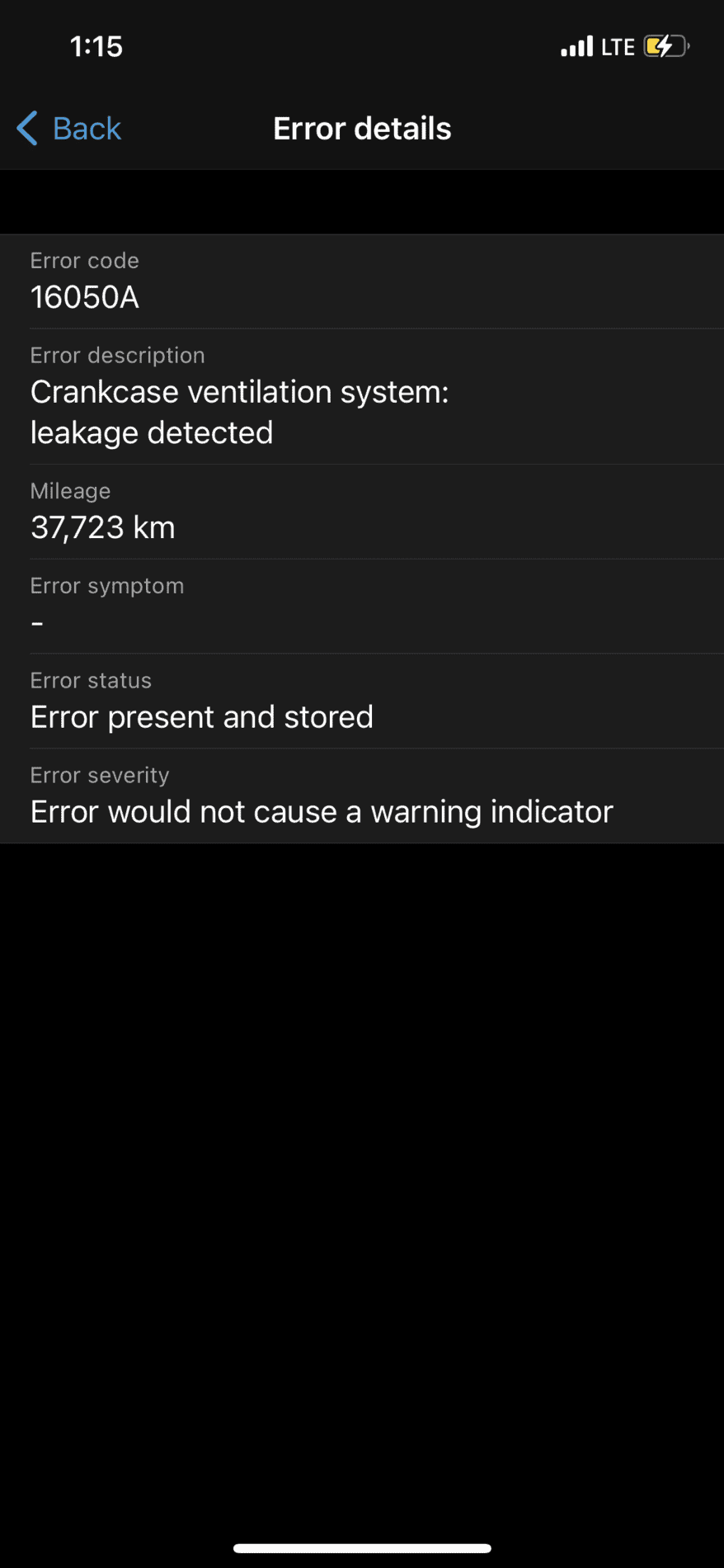

Getting code 16050A & 1C0101 have checked every hose nothing is broken anyone else had this problem?

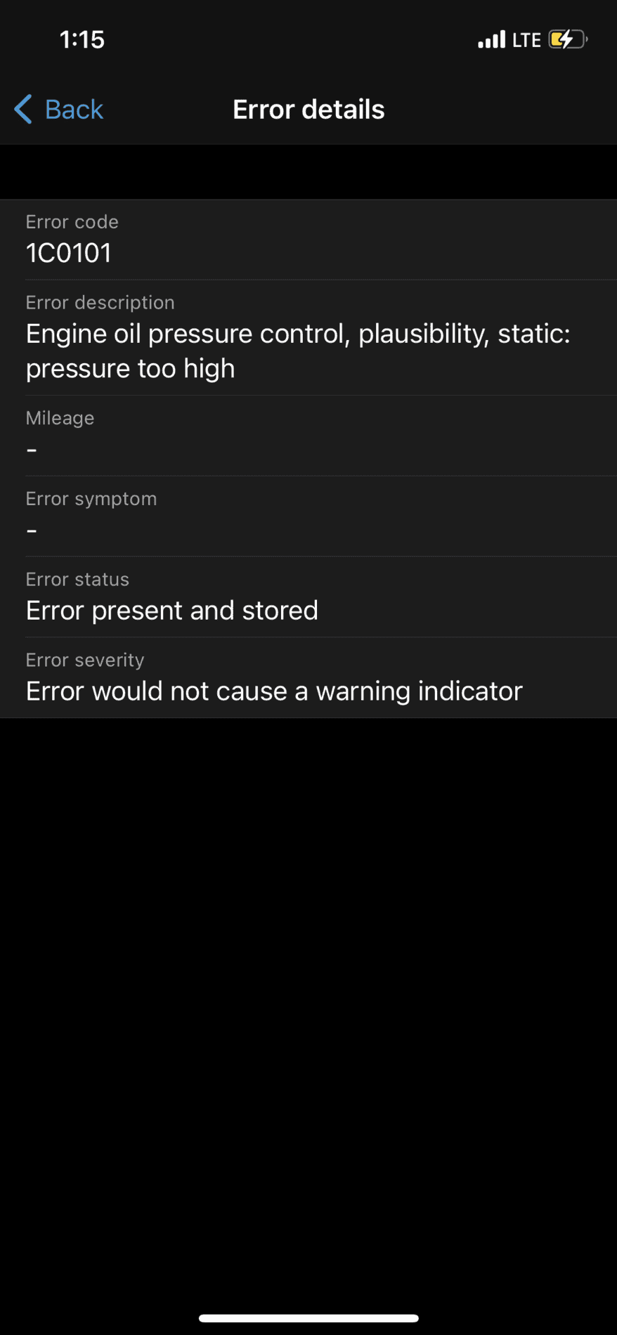

also can’t check my oil for the last few months just stopped working

I mean, this one is obvious right as the Pure800 deletes this sensor. Reach out to your tuner and have them code it out.
well this isn't the heater code from what gather i got code 160504 which the heater that gets deleted with the pure that was coded out, this is for a leak
79
8,413
13,762
Yes, yes, you're right. But the DME still thinks the extra flow is evap/pcv leakage. This is fine.
Ok that’s what I thought but wasn’t sure
any idea on the oil pressure code we think it’s a bad sensor

Sorry to necro an old thread, but I recently got a code for 16050a and there's almost no info on this online. Is the code really a non issue?

my tuner turned it off cause I asked him but few months later I notice my charge pipe was leaking I’m going to asking him when I have time to turn it back on and see what happens
