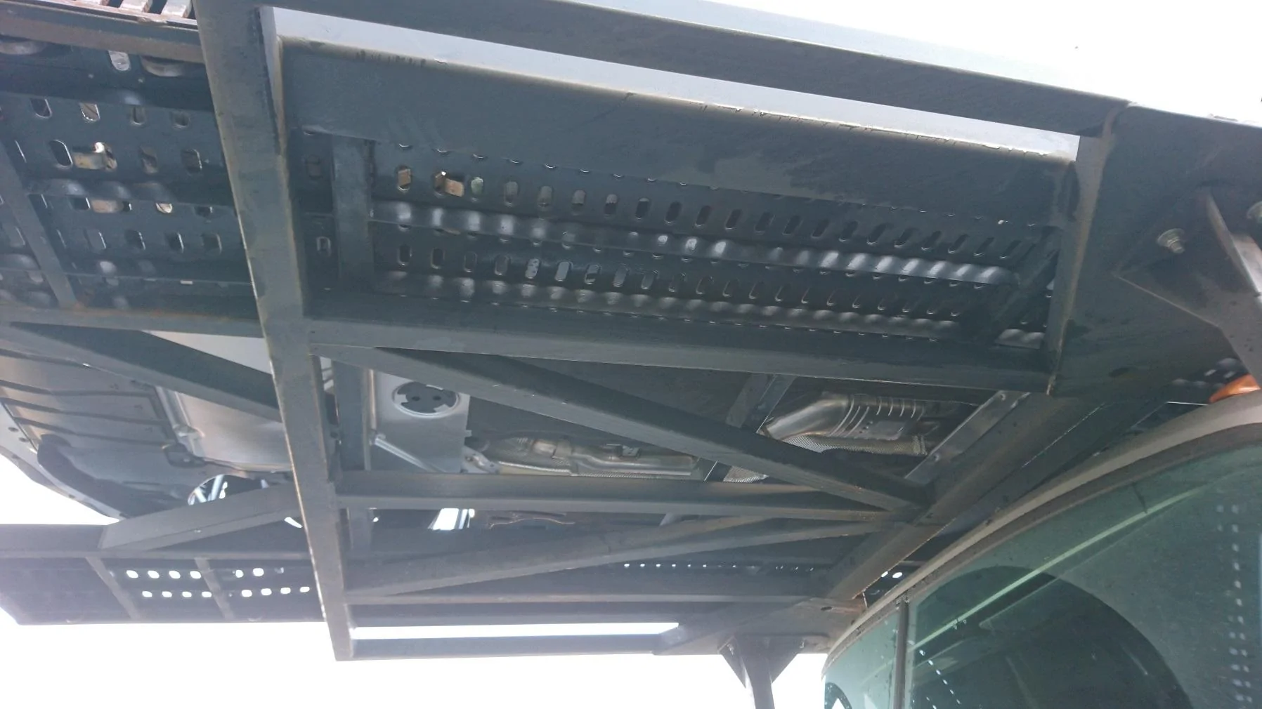

Things to note:
- The Au model does not have the GPF
- The exhaust hardware is the same as the US models - not the EU models (see pic)
- Exhaust flap is always open - except cold start
- Cold ambient temperature gives the really loud cracks and bangs - otherwise it's like the vid (which was shot in about 30 degrees celcius)
Is it loud? Unsure. I haven't had a standard exhaust car in 15 years, so seems pretty quiet to me.

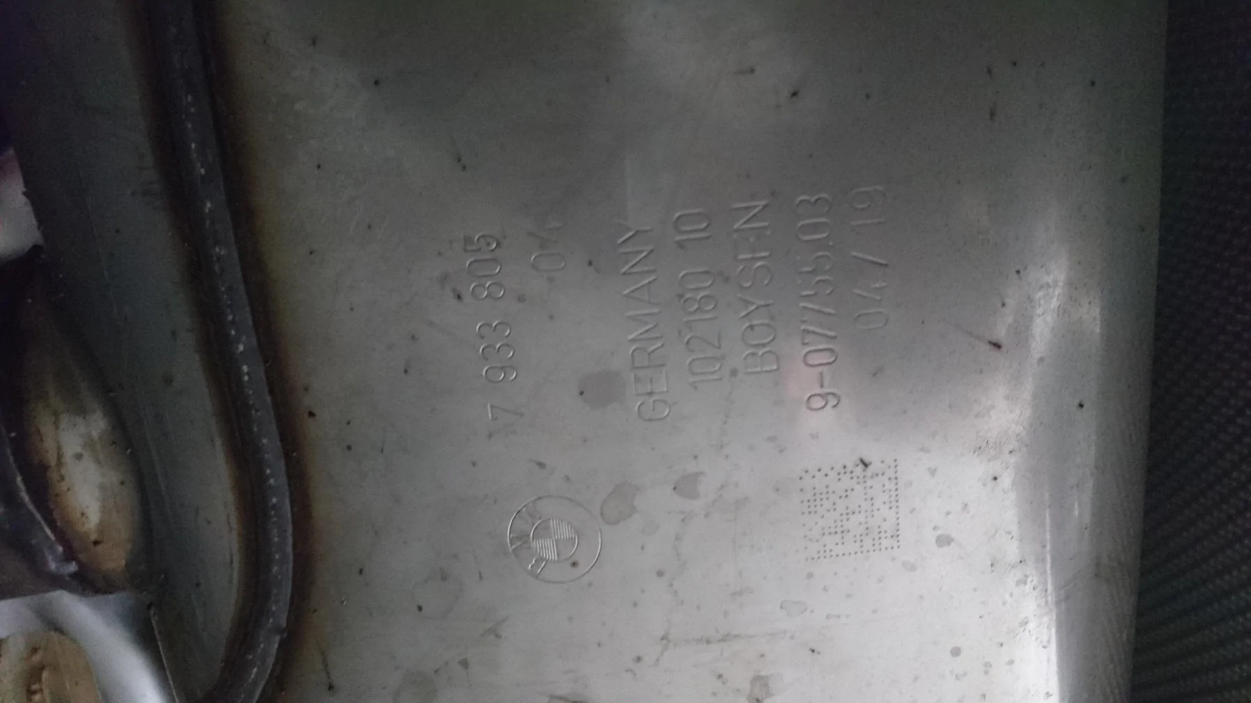

If someone in the US could get a part number off the rear muffler, that'd be awesome... just trying to confirm what is what!

Here's the AU rear muffler part number
Can someone in the US please snap a picture of theirs? It's very easy to access, just near the LHS rear inlet/outlet. No need to raise the vehicle from the floor.

So it appears that the US does have a different rear muffler to the rest of the world.
So, it would appear the market configuration is as follows:
EU:
Rear muffler: 7 933 805 04
Centre section: (1) in below
V-band downpipe
GPF
"quiet"
AU:
Centre section: (2) in below
Ribbon Clamp downpipe
No GPF
"medium"
US:
Rear muffler: 9 425 817 03
No GPF
"loud"
