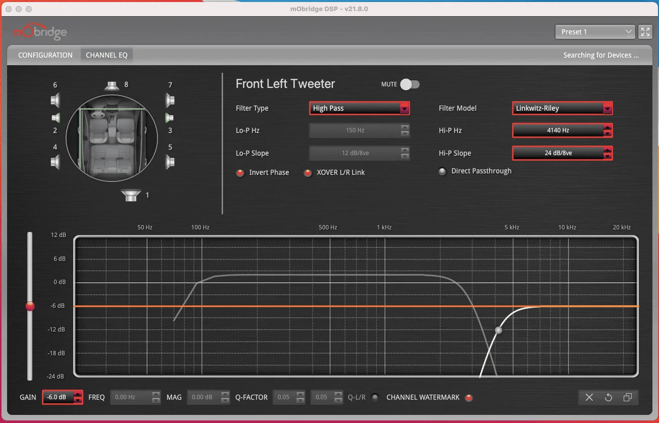

No need to bi-amp(bridge) the channels on the K2 amp. There are two channels allocated that are pre bridged at 200w rms @4 ohms for those that want to stick with passive.
Edit: I can say though had I not went active the tweeters would have been much too bright as I am currently running my tweets -6dbs compared to the mids.
Now that I mention it, I am going to revisit my gain settings for the tweeters. They were initially lowered 6db due to the brightness, but I had since eliminated the excessive brightness issue by removing excessive frequency overlap between the tweeter and mid by setting my crossovers at 2750hz/24db slope on the mid and 4250hz/24db slope on the tweeter.

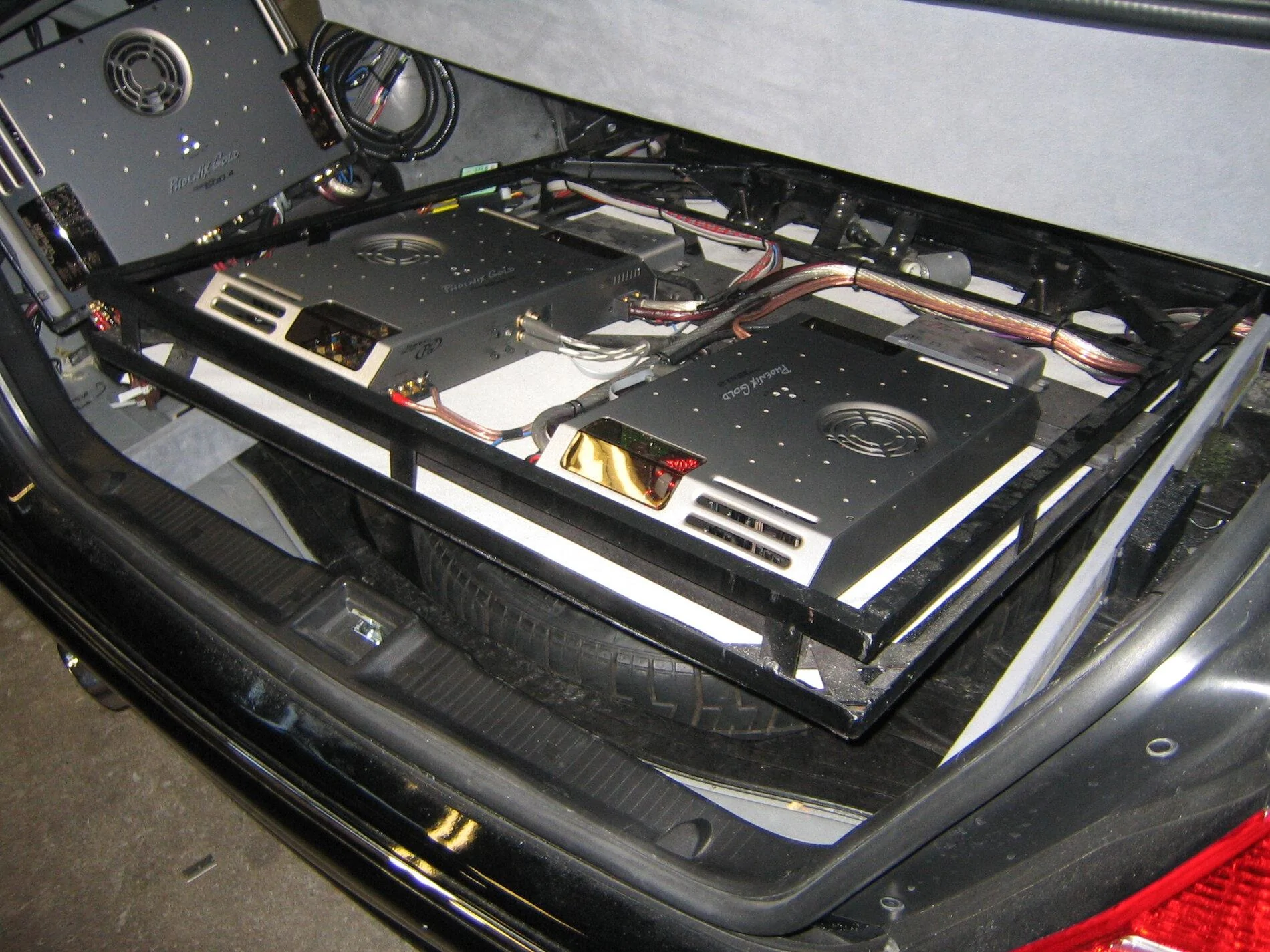

I agree with the above. An all active setup definitely provides more control for those who can properly utilize it; and I do love the benefits of having a direct connection between driver and amplifier. I just want to warn the novices that may not realize itā€™s an expert move. We just want to be careful to prioritize/protect proper tone and timbre, over the benefits of dynamics and phase coherency (among others) that scuttling the passive network delivers. As I mentioned earlier- Iā€™m not against an all-active setup for those who can take advantage of this approach.

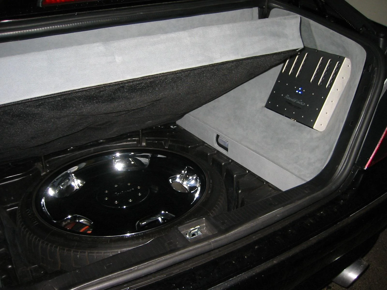

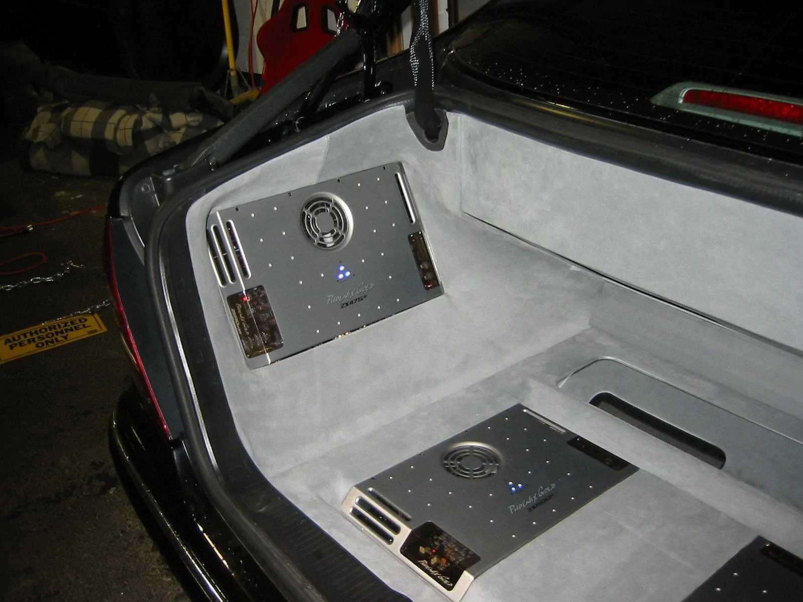

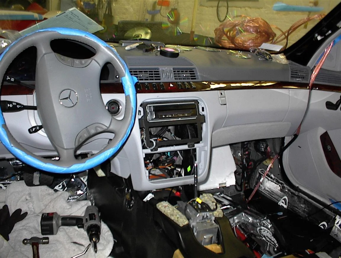

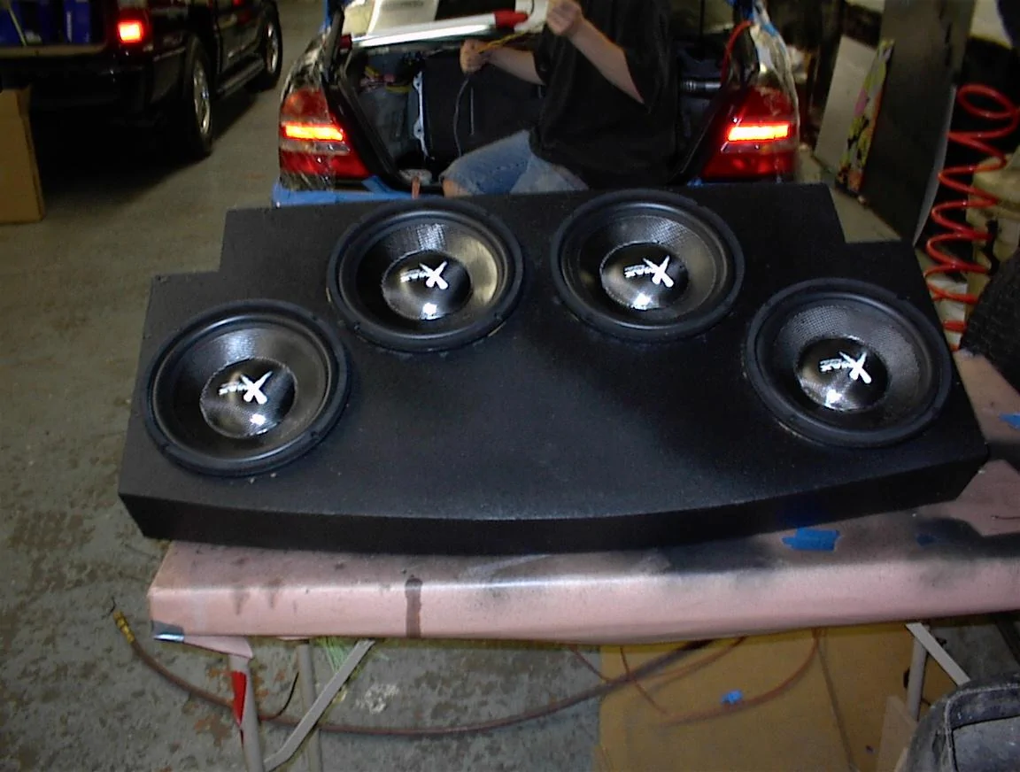

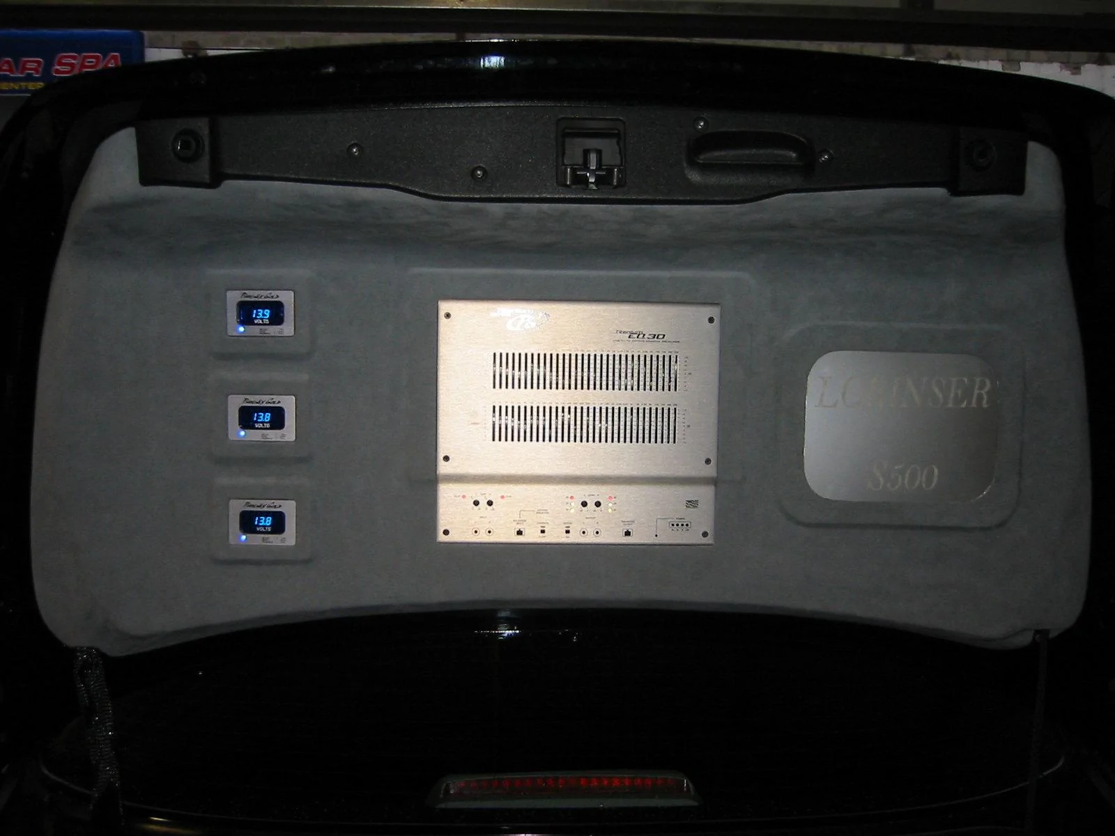

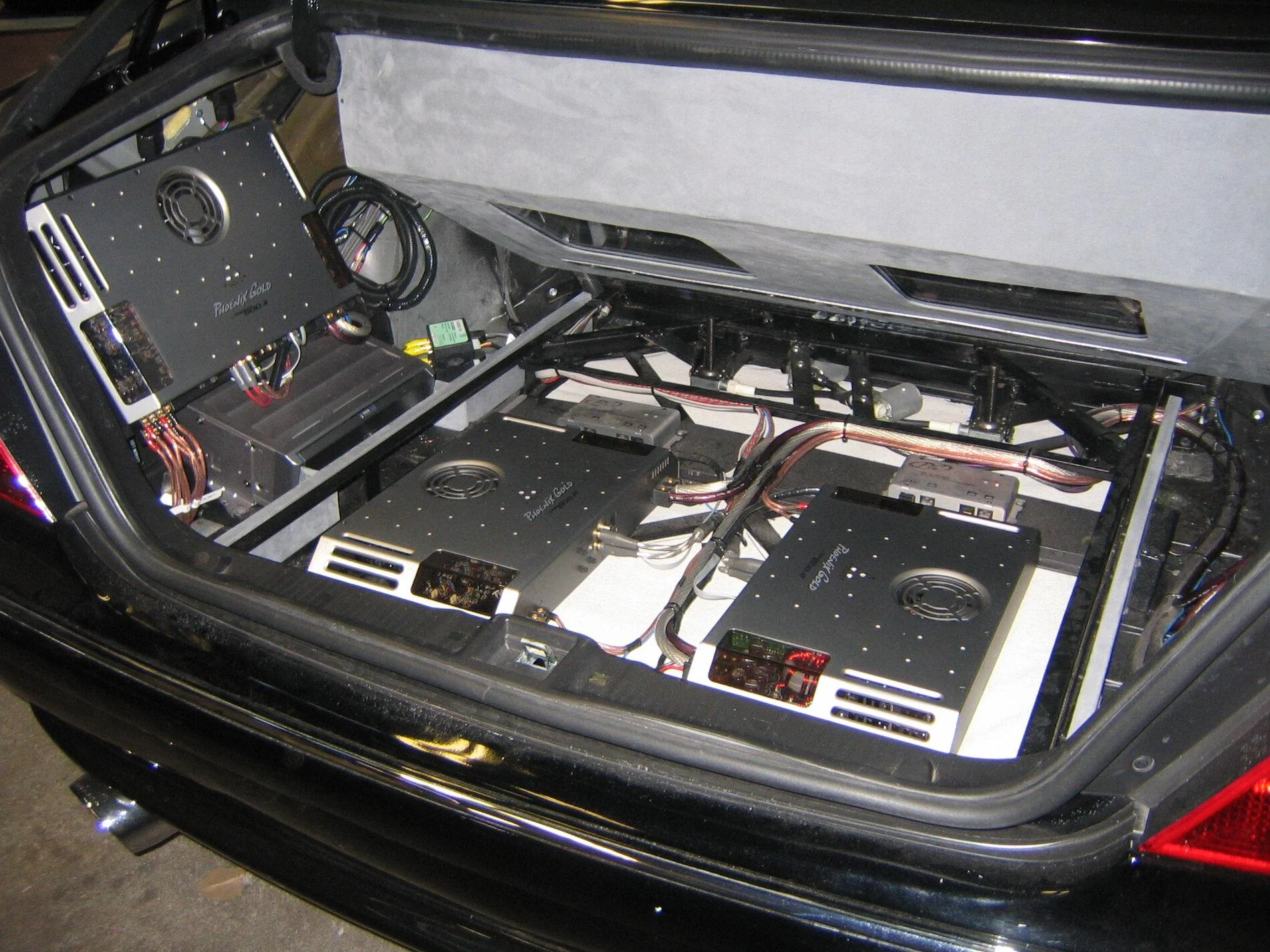

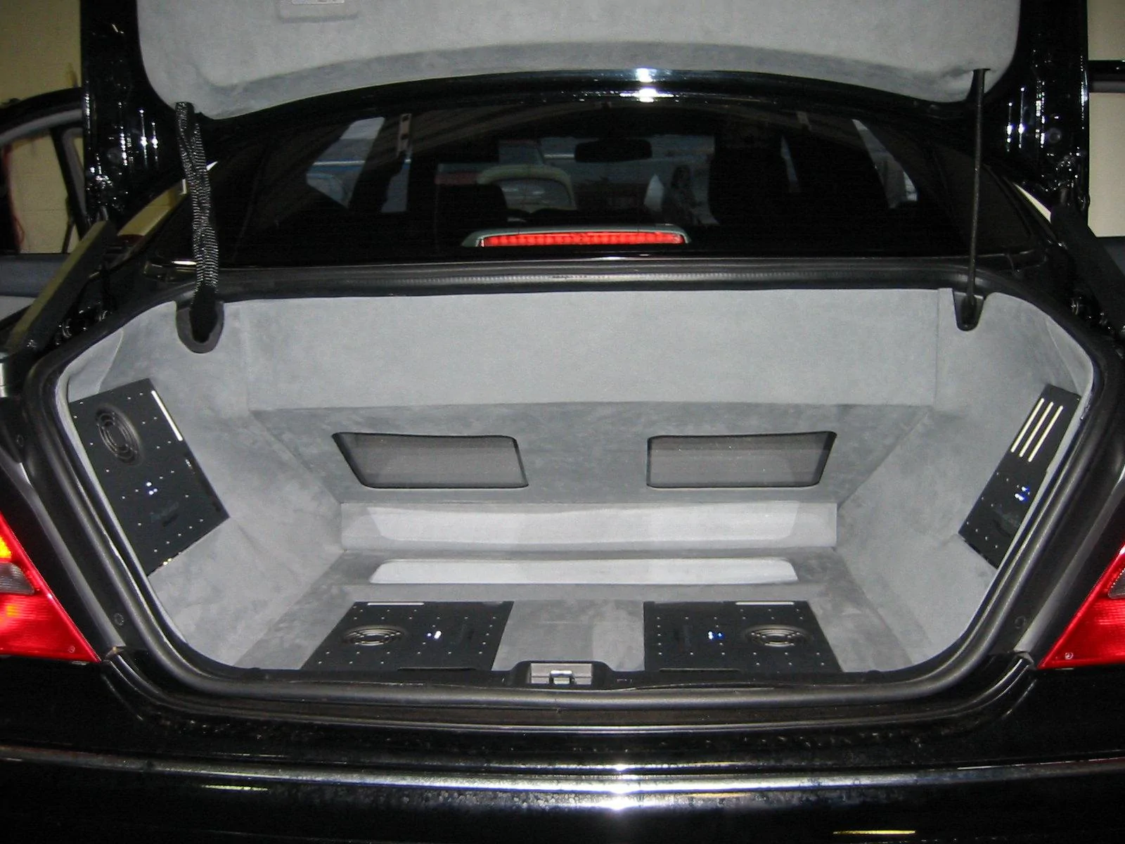

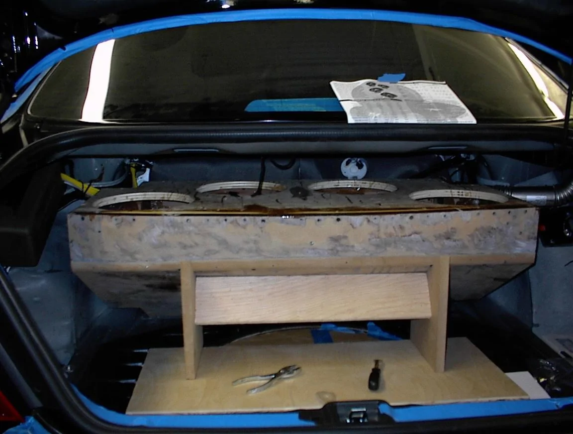

BTW- I have substantial experience in car audioā€¦. Somewhere I have an old picture from the mid-90s where I built a show car for SONY to display their ES system as proof my car audio bonafides, but I canā€™t find it right now. How about this old S Class system I did around 1999?
(sorry to thread jack)

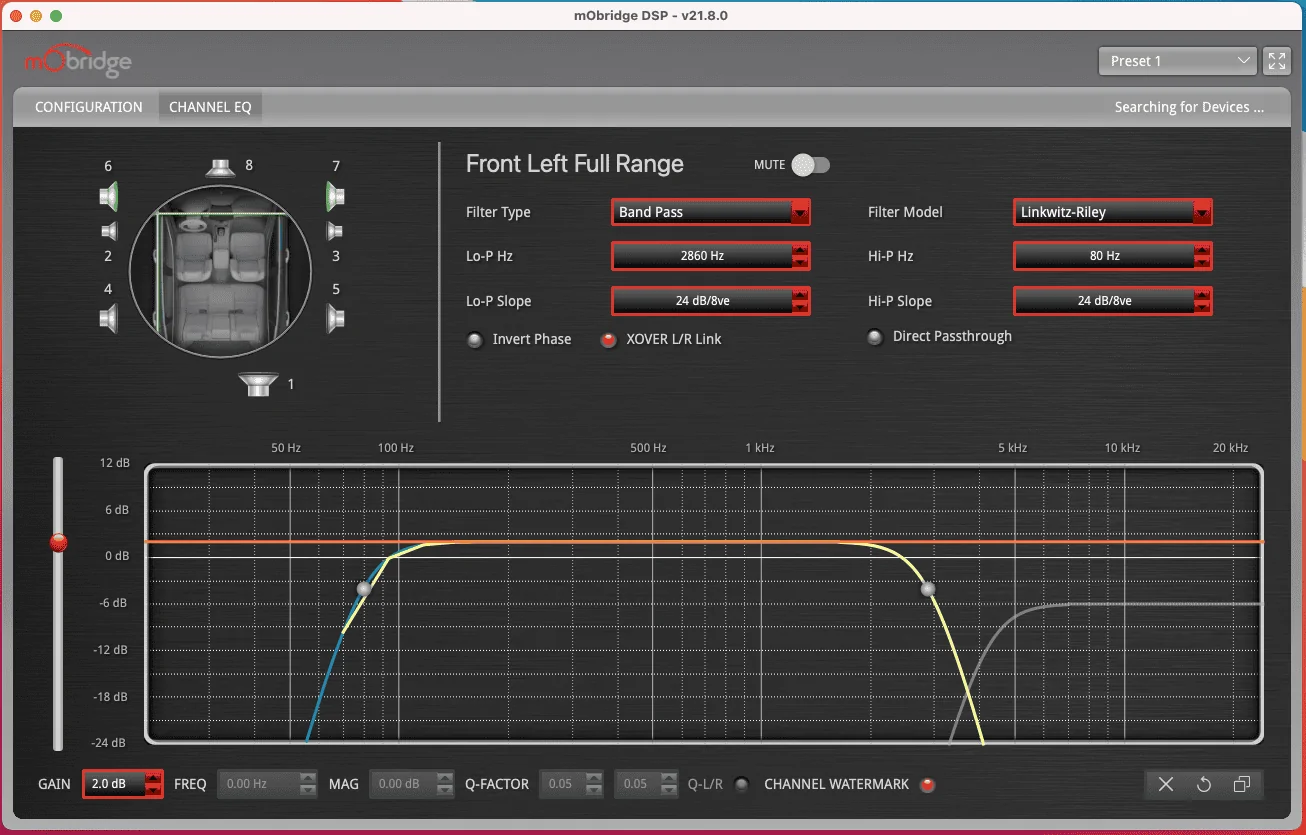

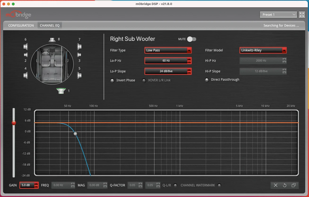

DSP Tuning
Getting the equipment installed and working is just half the job. The next step is to dial in the system utilizing the heart of the system, the mObridge DSP.
Goal:
To fully maximize the performance of the system by using basic and advanced tuning methods for creating a desired sound stage and experince. I am a novice to this and will be learning on the go based off the sources I have been reading/watching. Once I start the process I will update this thread as I go.
Tools:
Audio Control SA-4100i Microphone
Mobile Tools by Audio Control App
Neewer Microphone Stand
Resources:
A Straightforward One-Seat Stereo Tuning Process and Some Notes About Why it Works
JL Audio - Active vs. Passive - Session 101: Crossover Network Overview
JL Audio - DSP Amplifiers - Session 201A: Basic Mobile Tune
JL Audio - DSP Amplifiers - Session 301: Advanced Tuning
Current Settings (pre tuning):

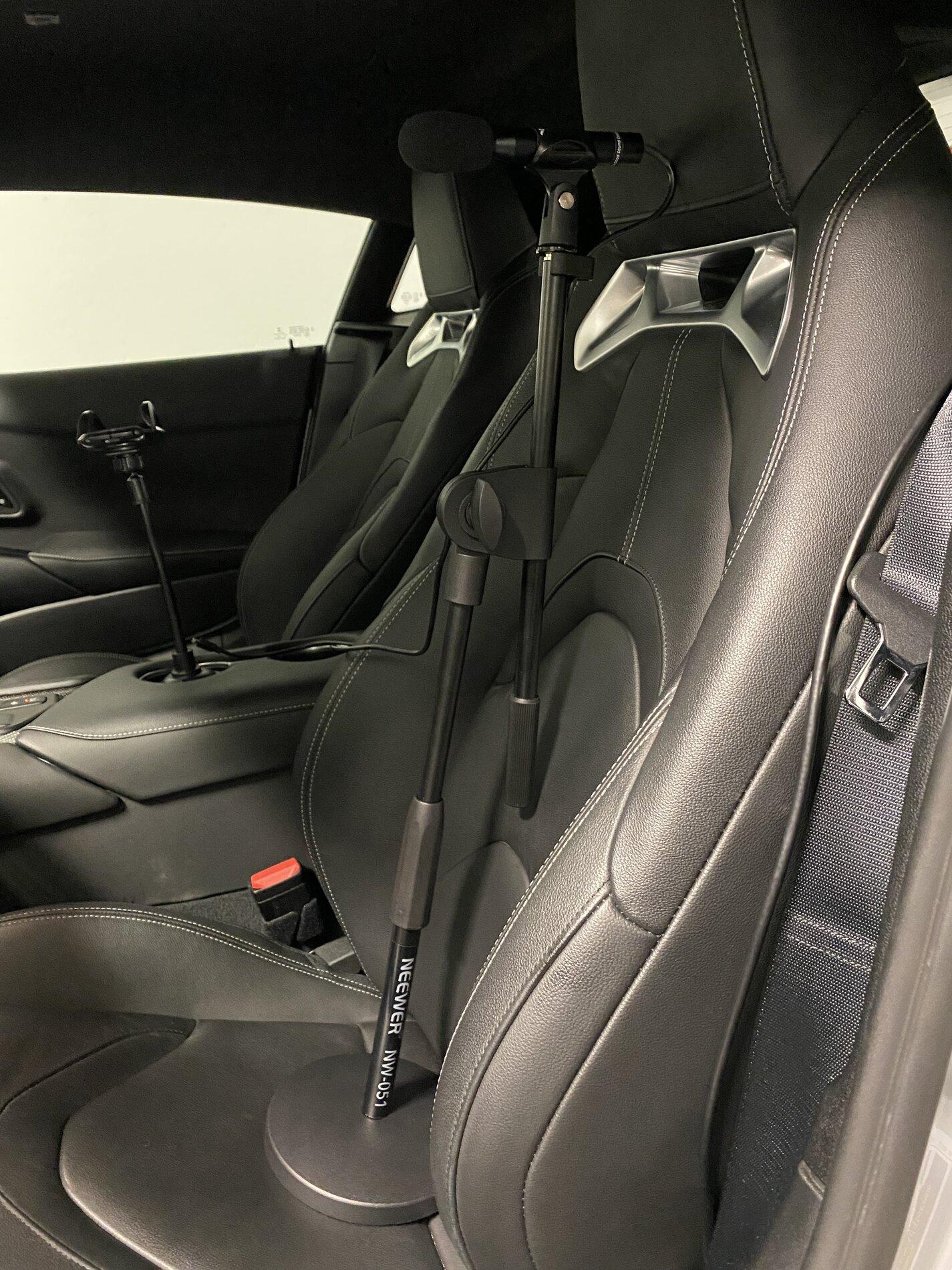

METAL
METAL
K2
May 26, 2020
689
390
Peoria, AZ
www.instagram.com
Had to return and find a better mic stand. I edited the post above to reflect the stand I got. Towards the back of the photo you can see a phone mount in the cup holder so I may easily read the data from the mic.
