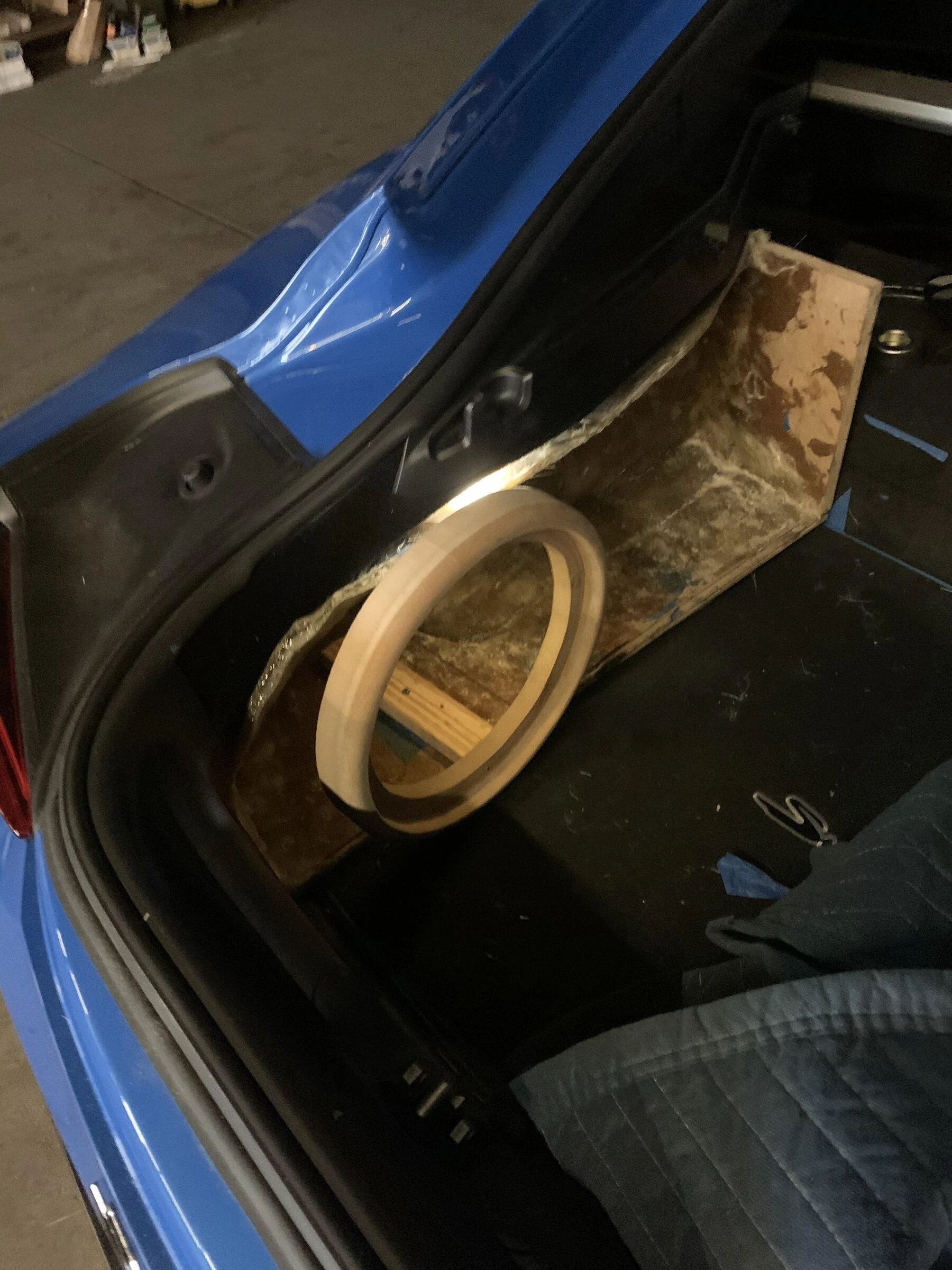

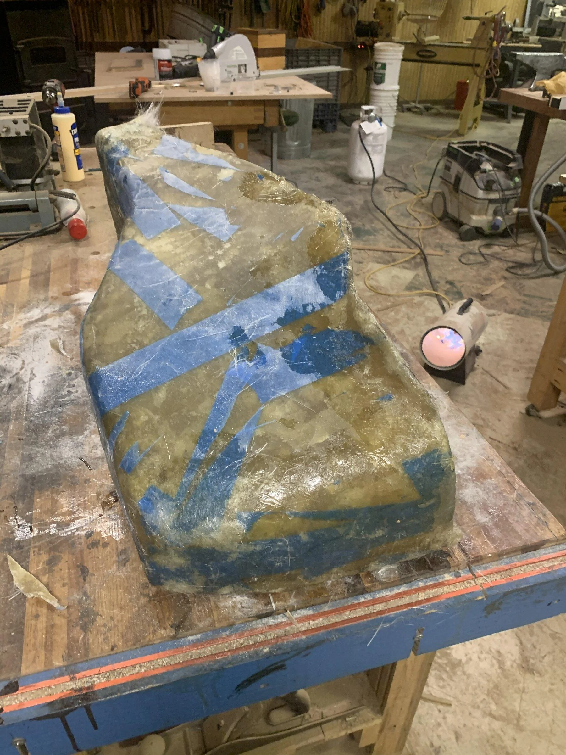

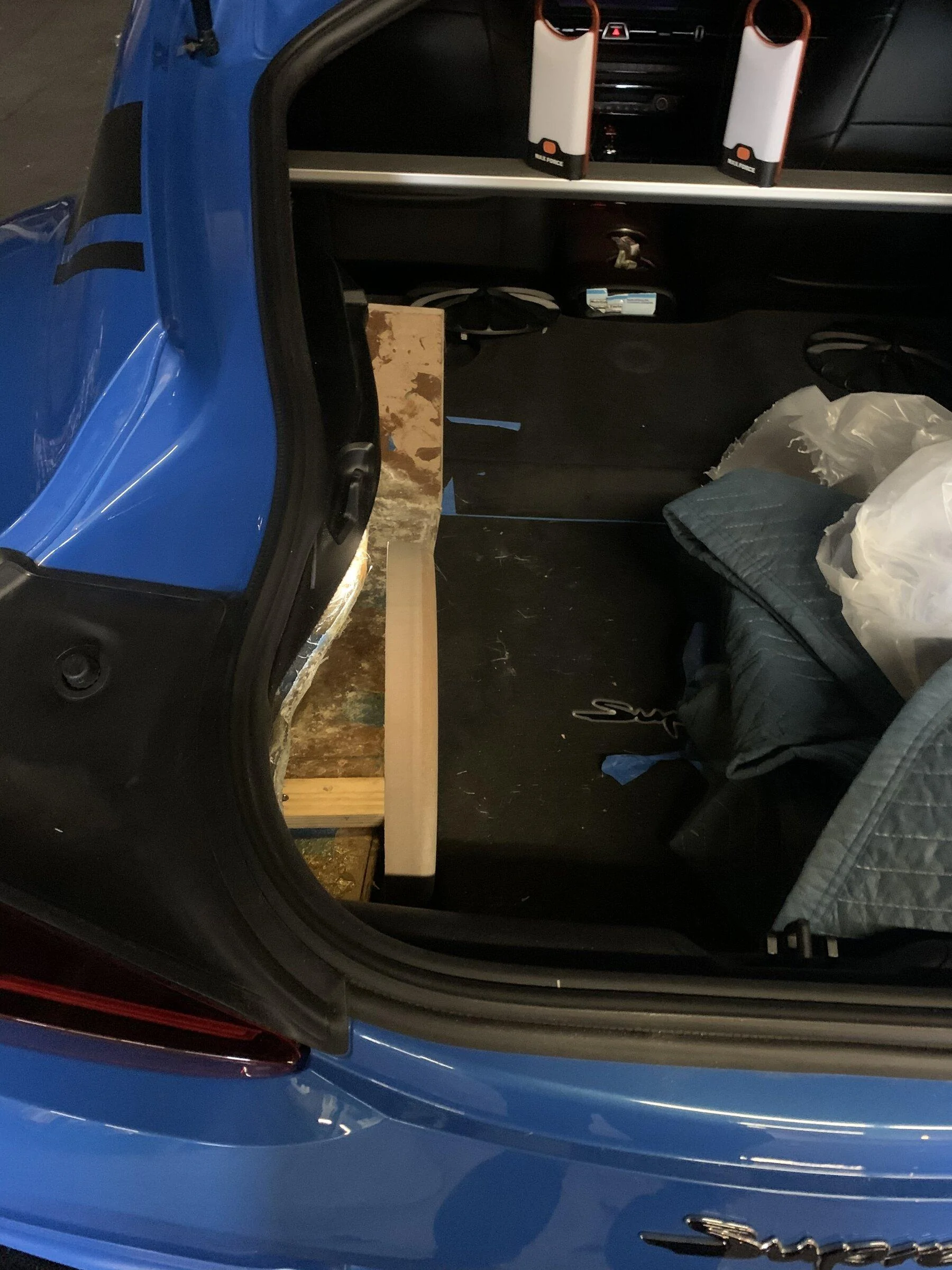

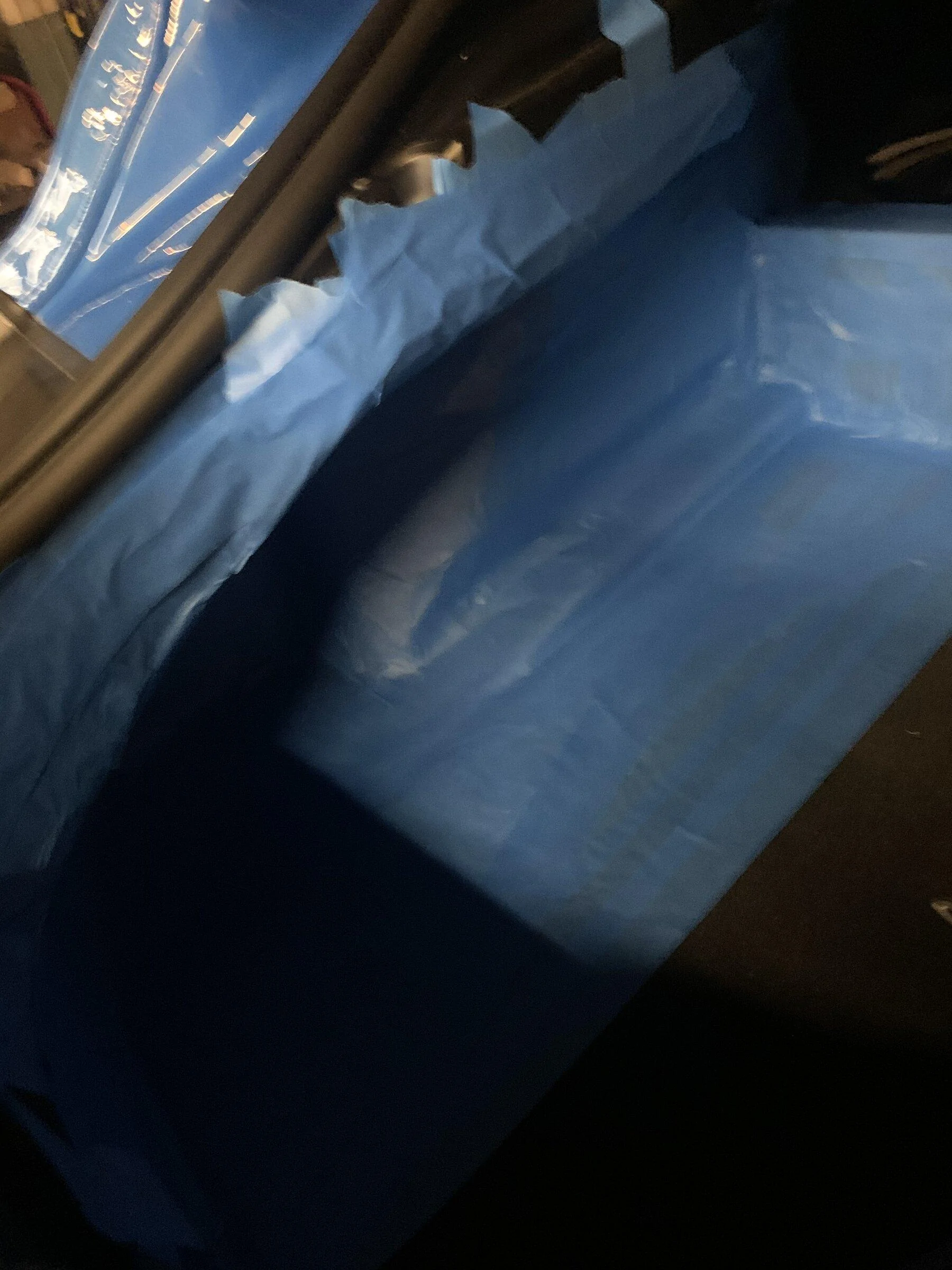

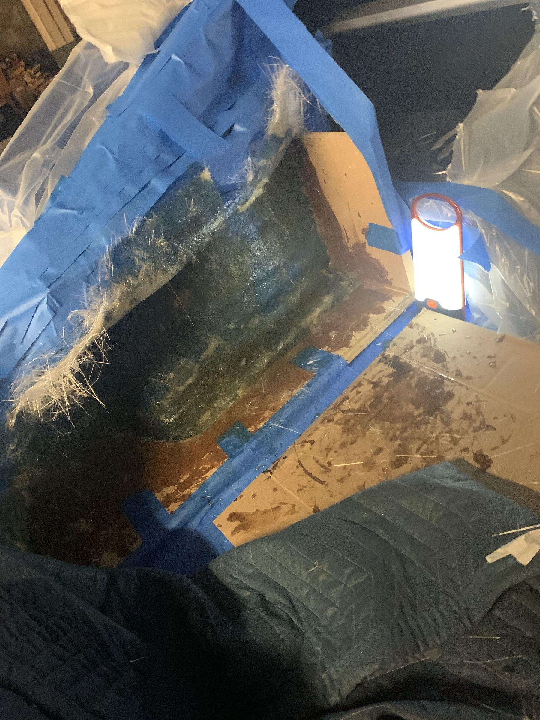

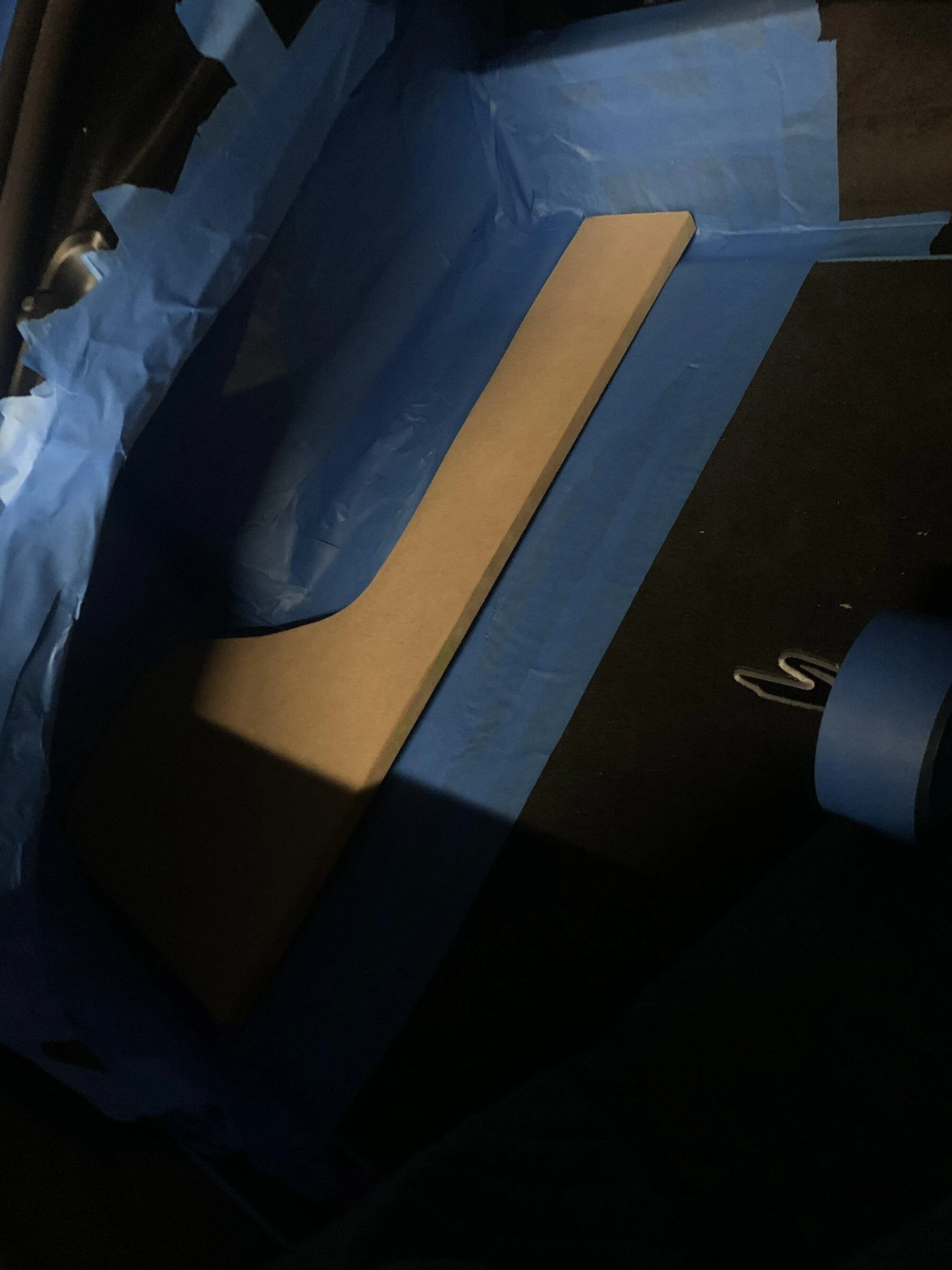

Got the first few layers of fiberglass laid down today. What a messy job that is. Seems to be a decent mold and will remove it this Wknd and start building layers in my shop

Fiberglass layering almost done. At days end tmrw I should have 7/16-1/2” thick of glass.

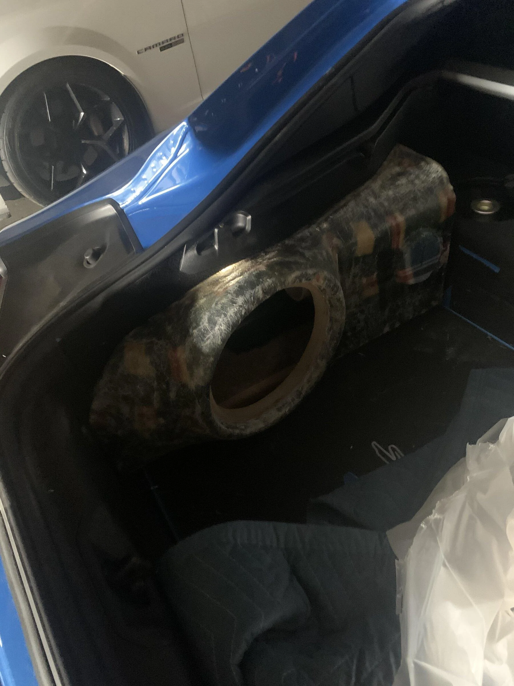

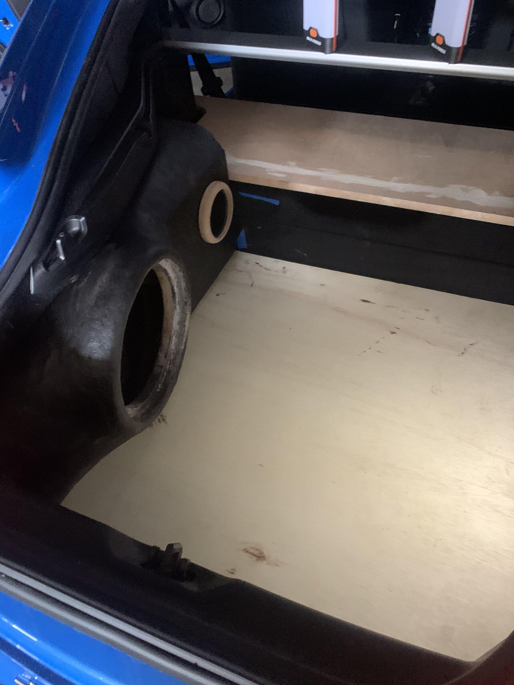

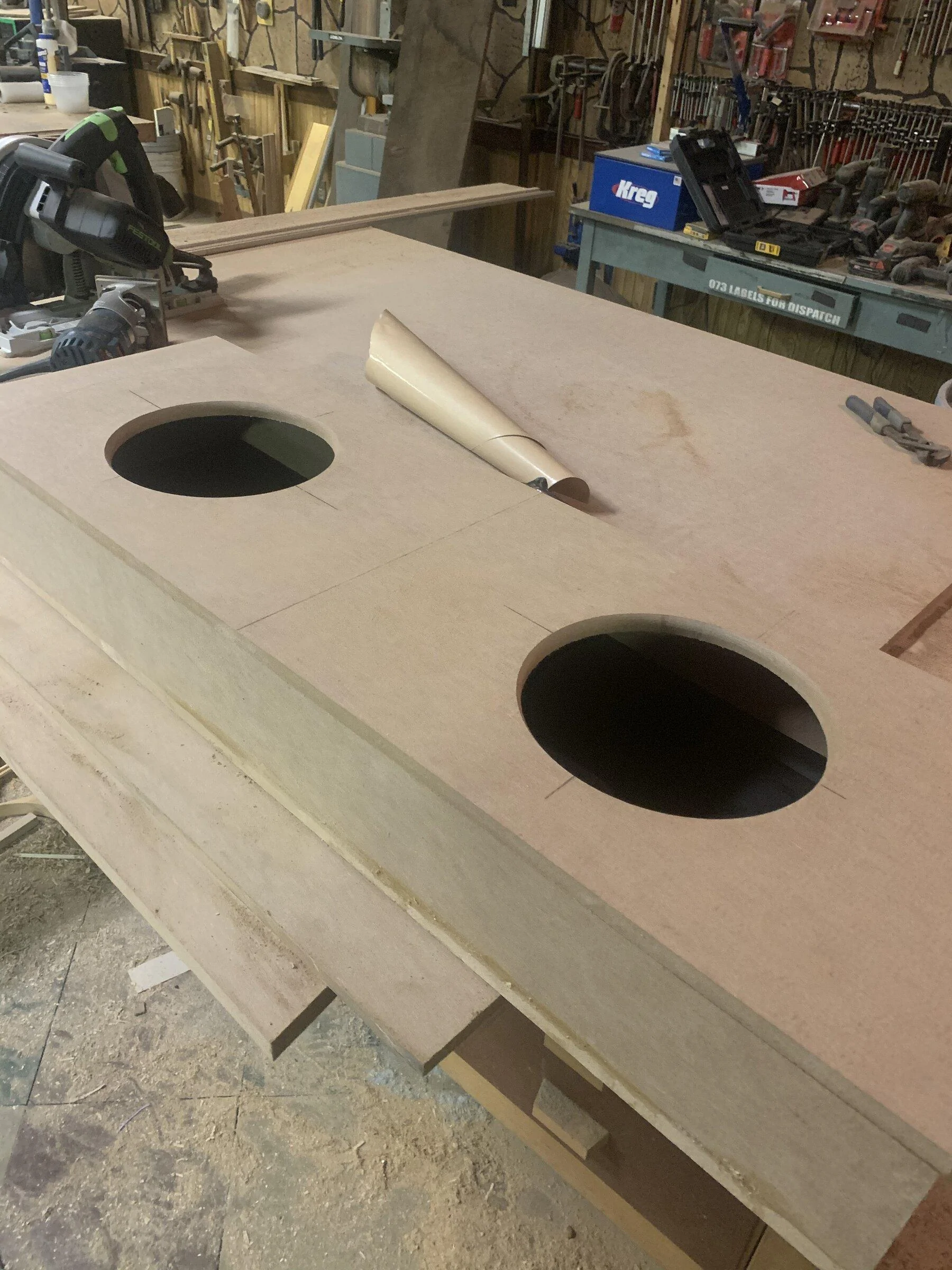

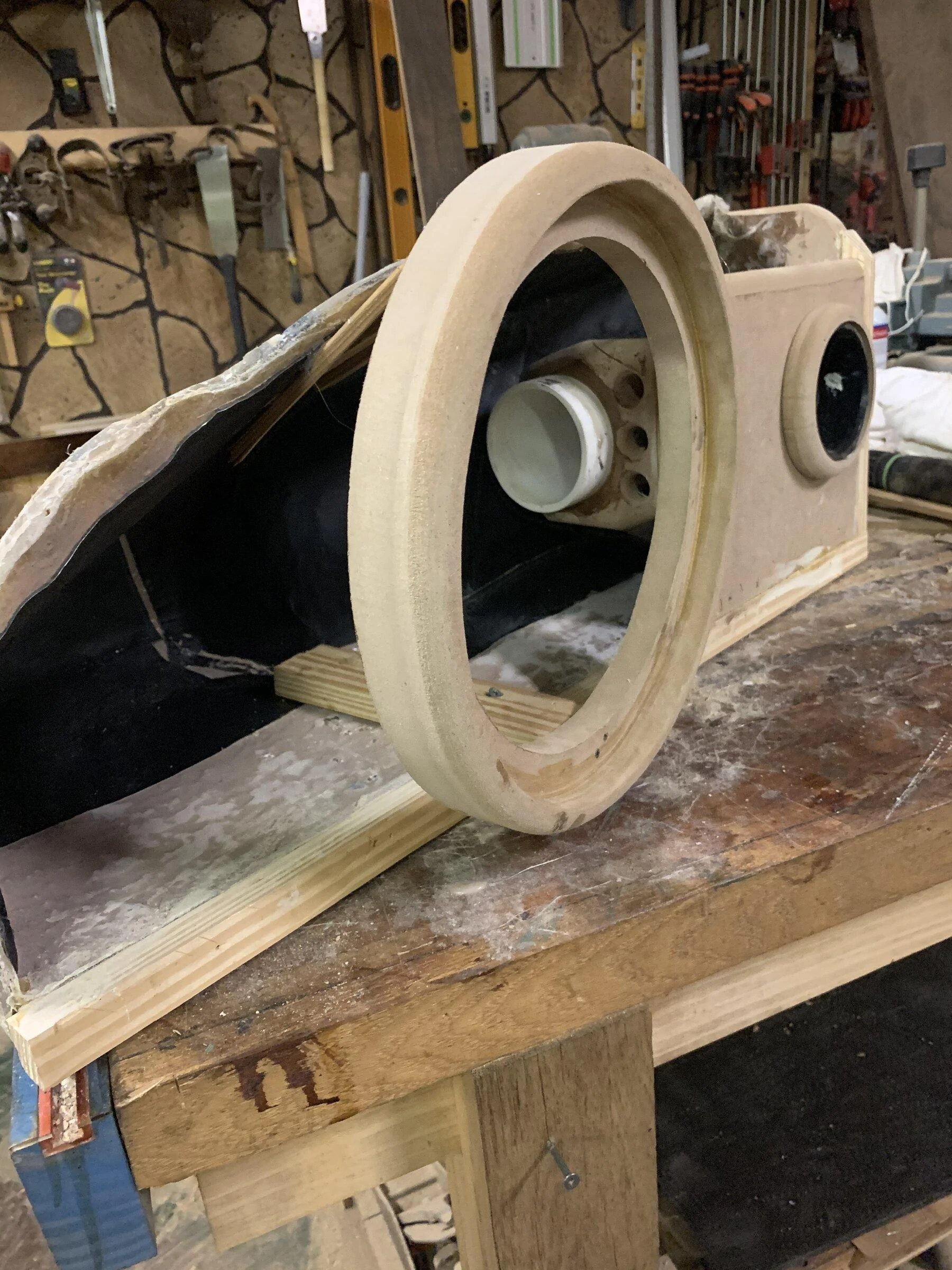

Here you can see I got the box to the correct cubic footage and ported it to be tuned at 32 hertz.
Will start building the front up now.

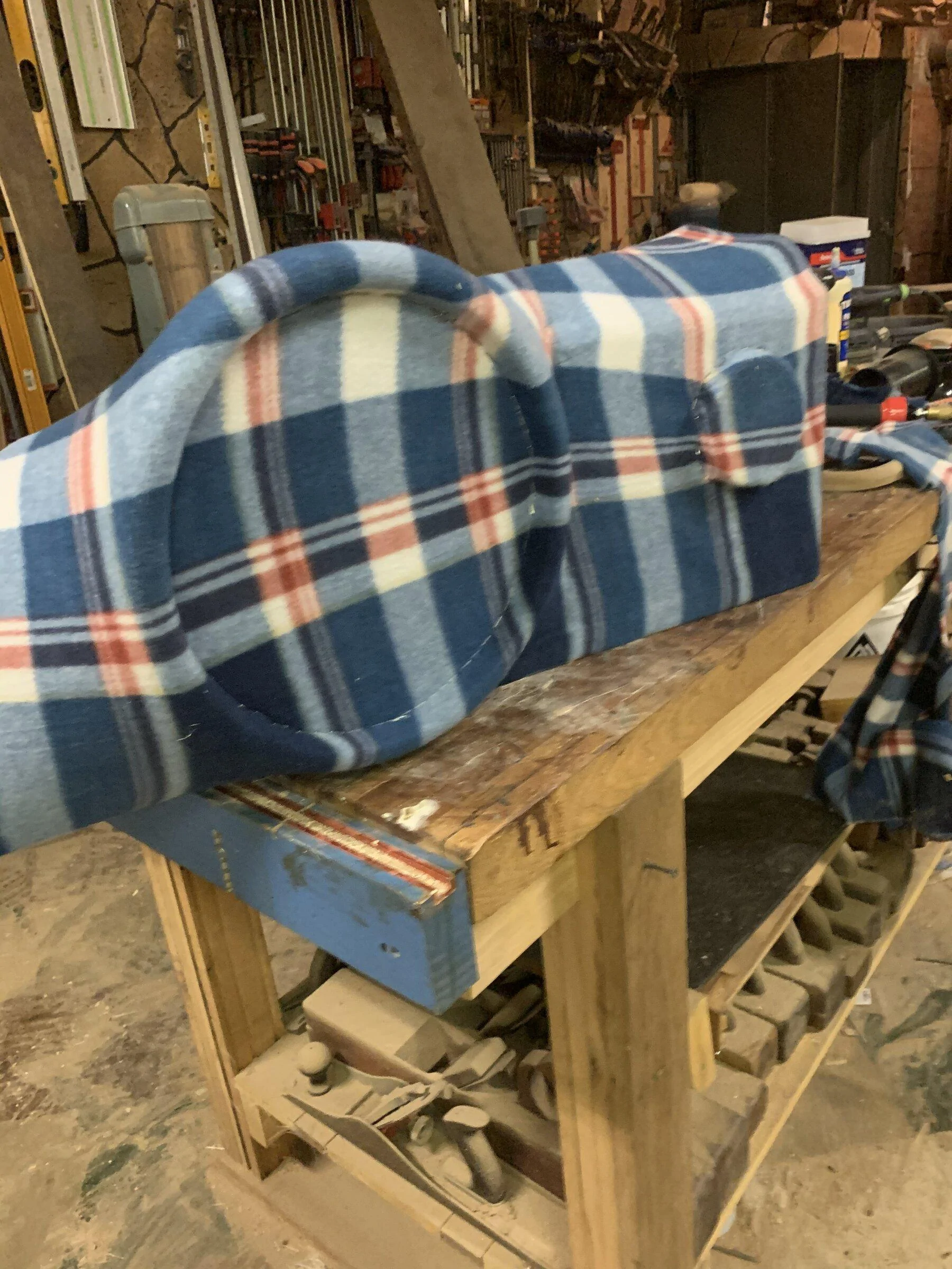

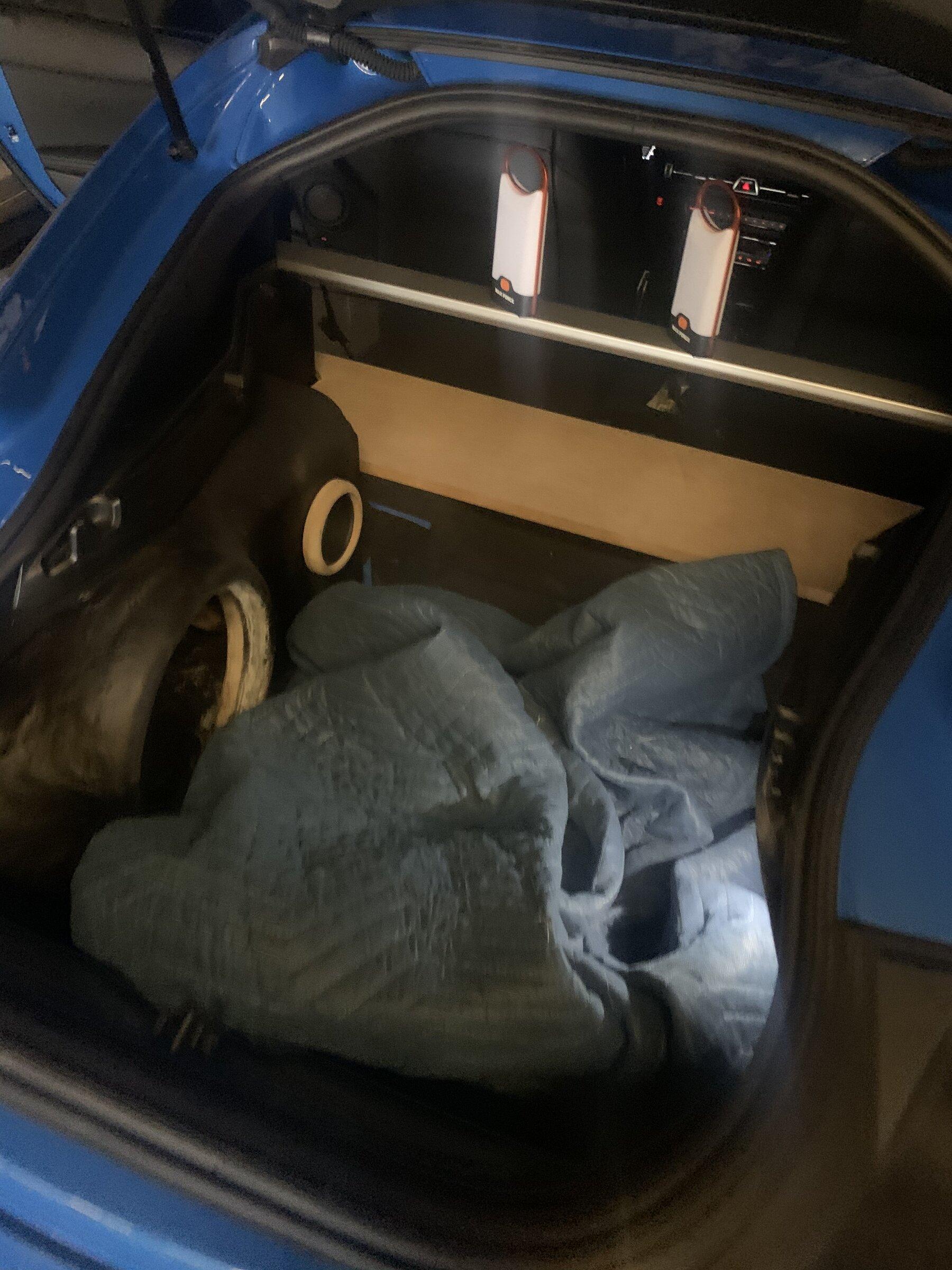

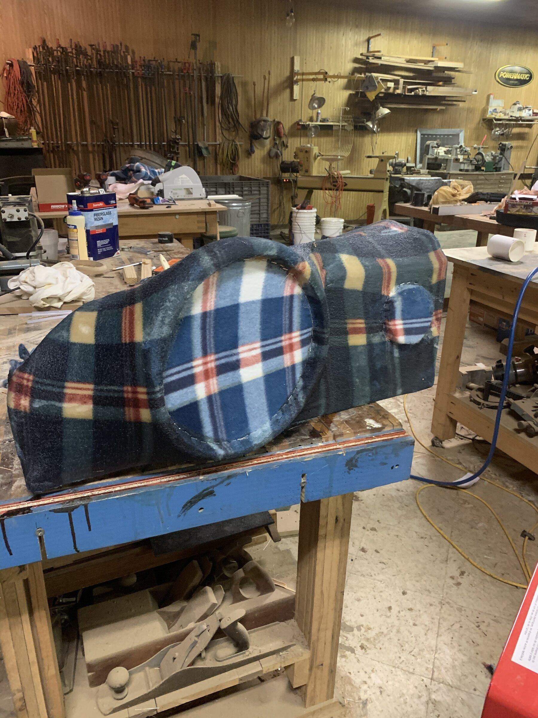

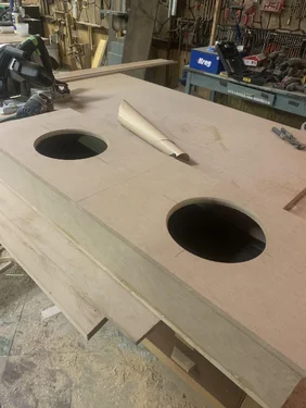

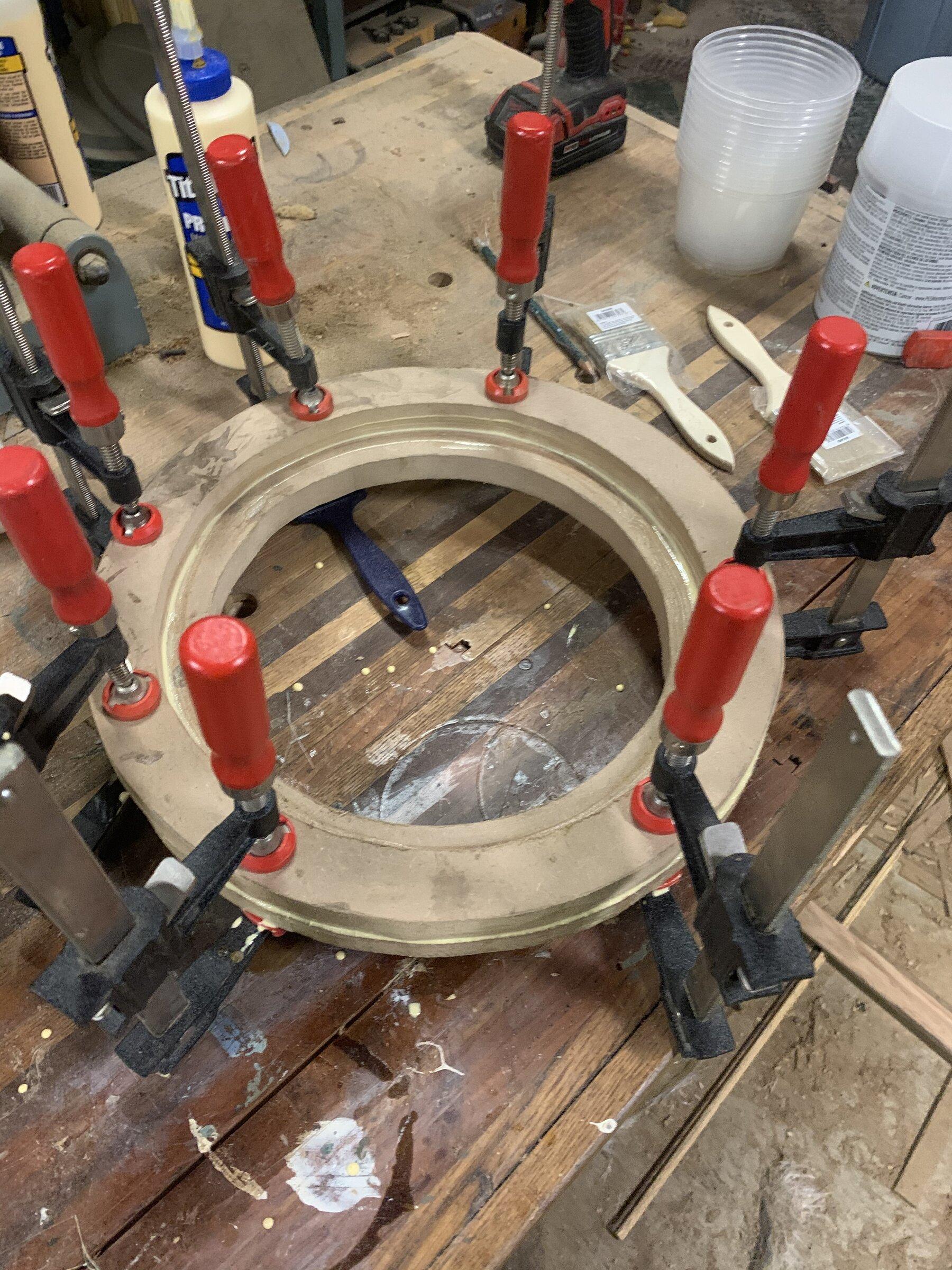

Next stage. Box all done minus carpet. Working on laying out 8” mid drivers on top of existing subs and amp rack construction next.

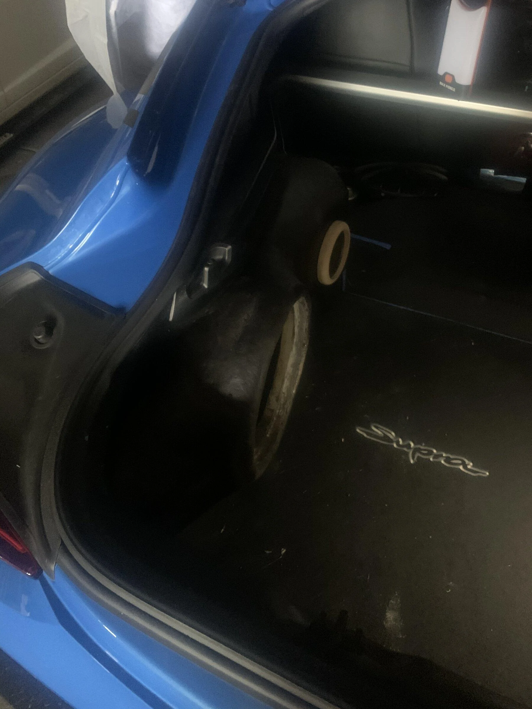

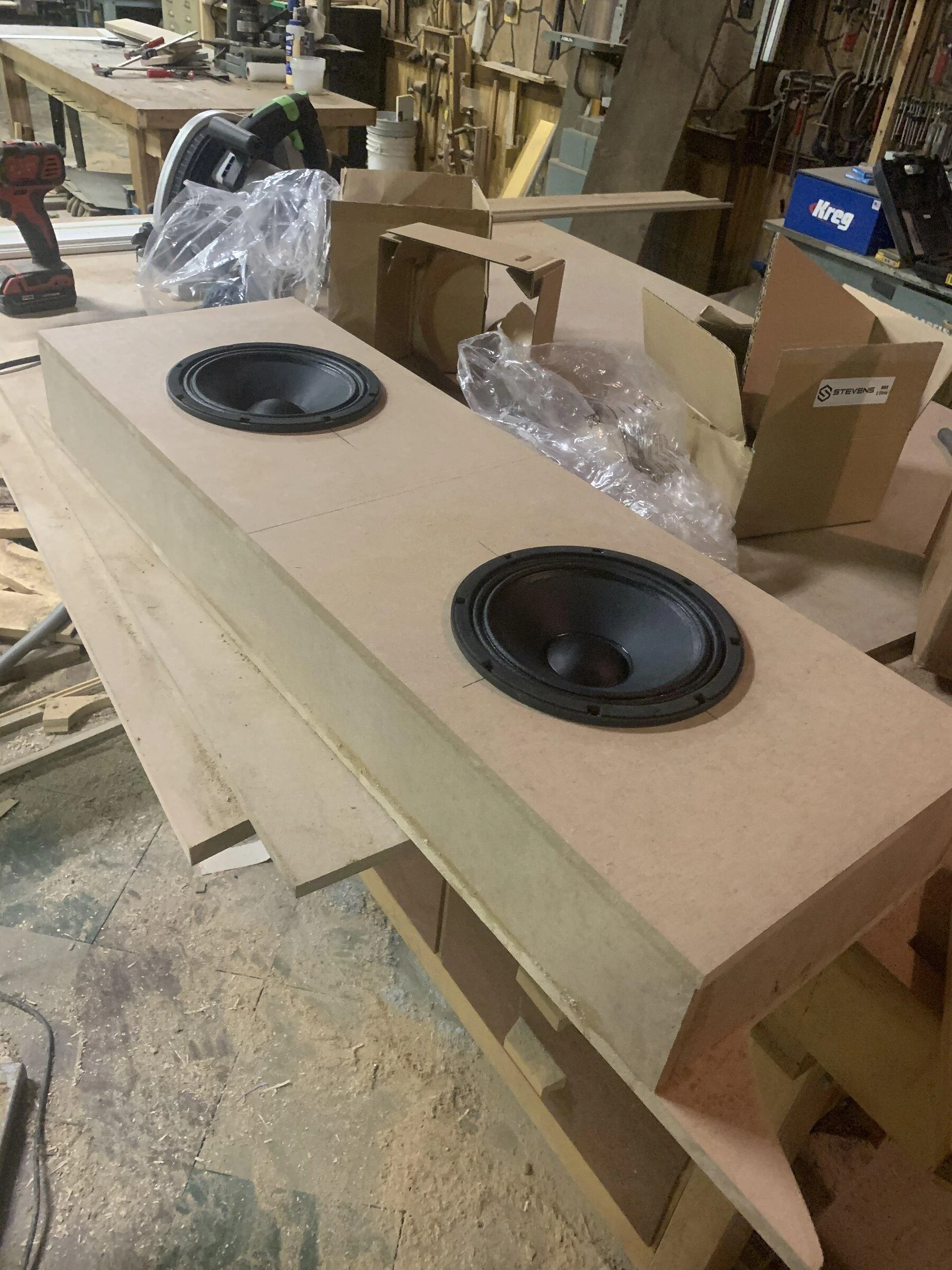

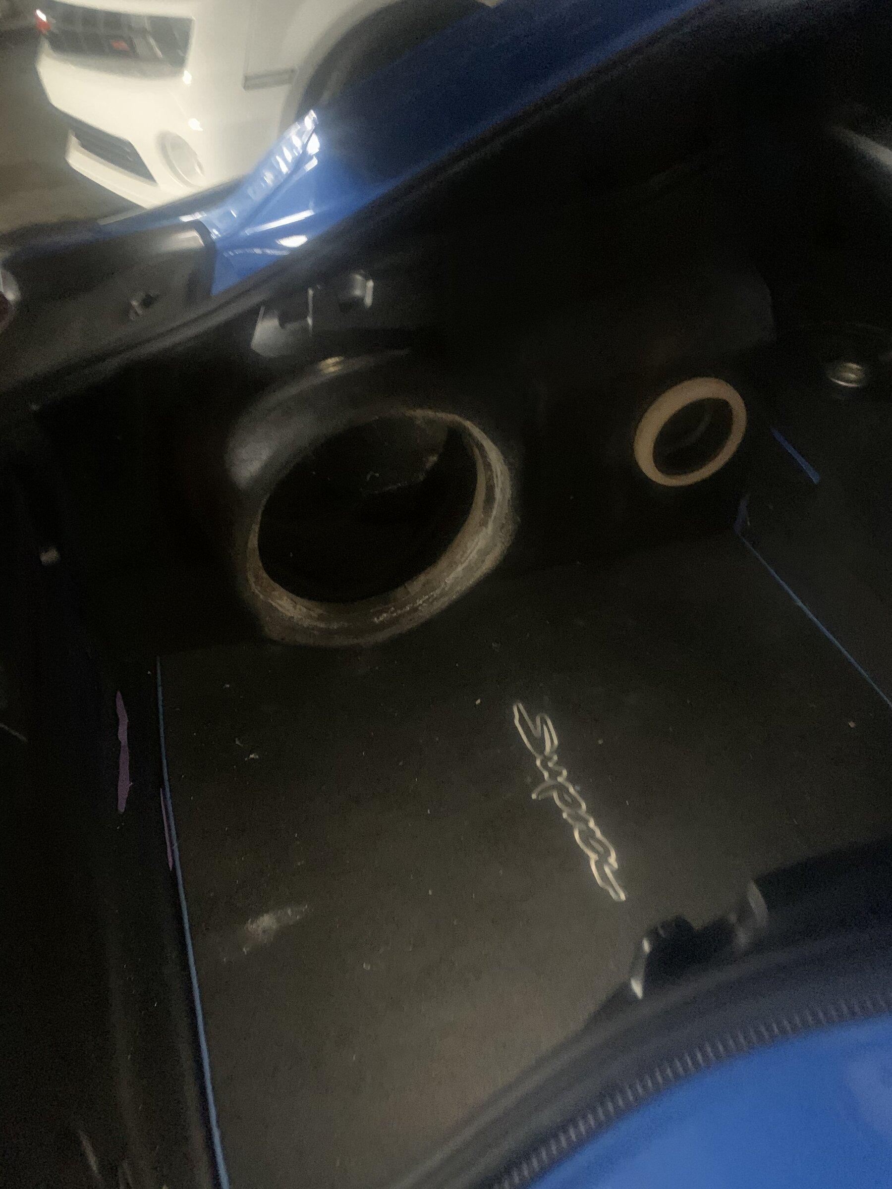

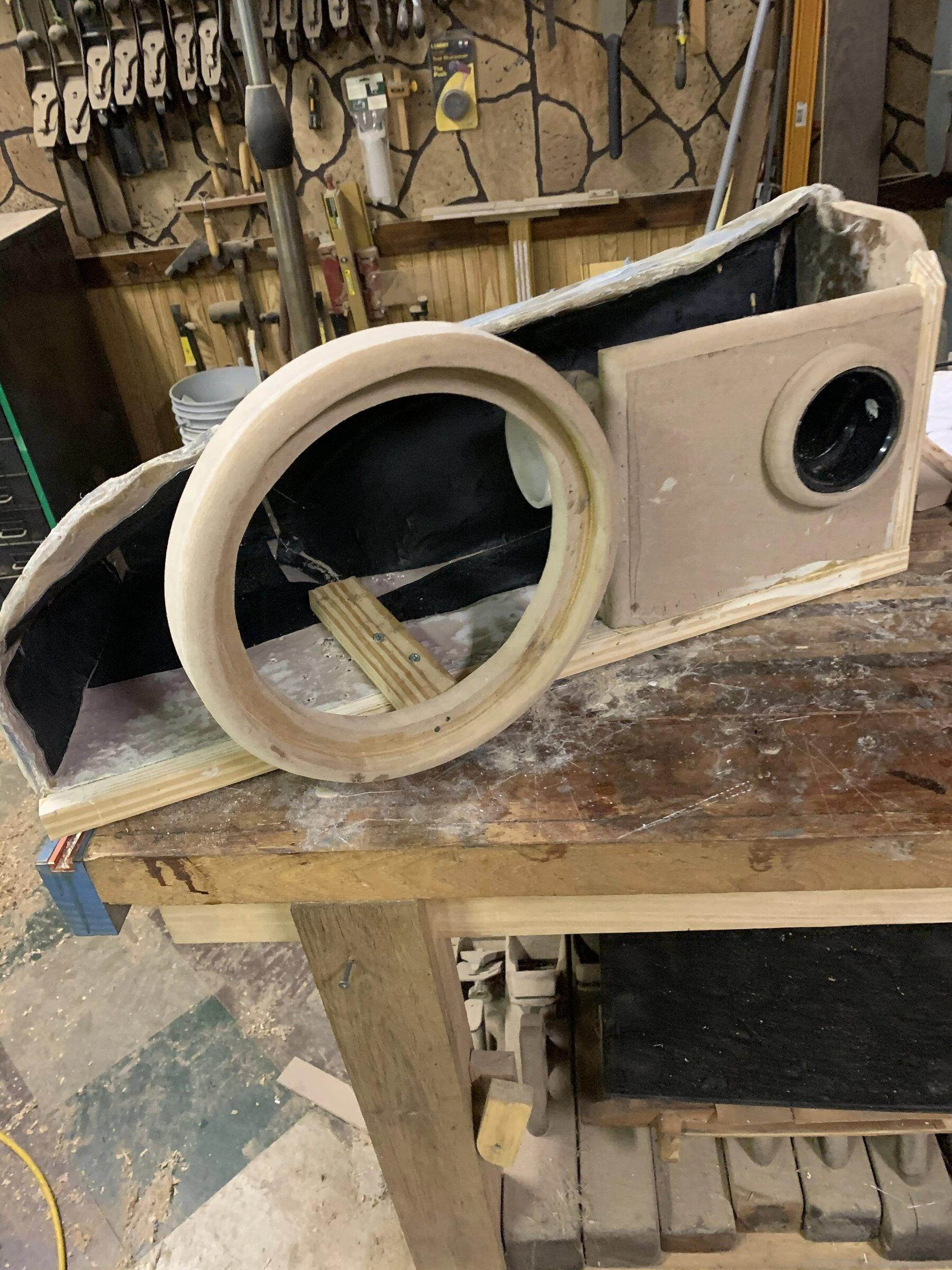

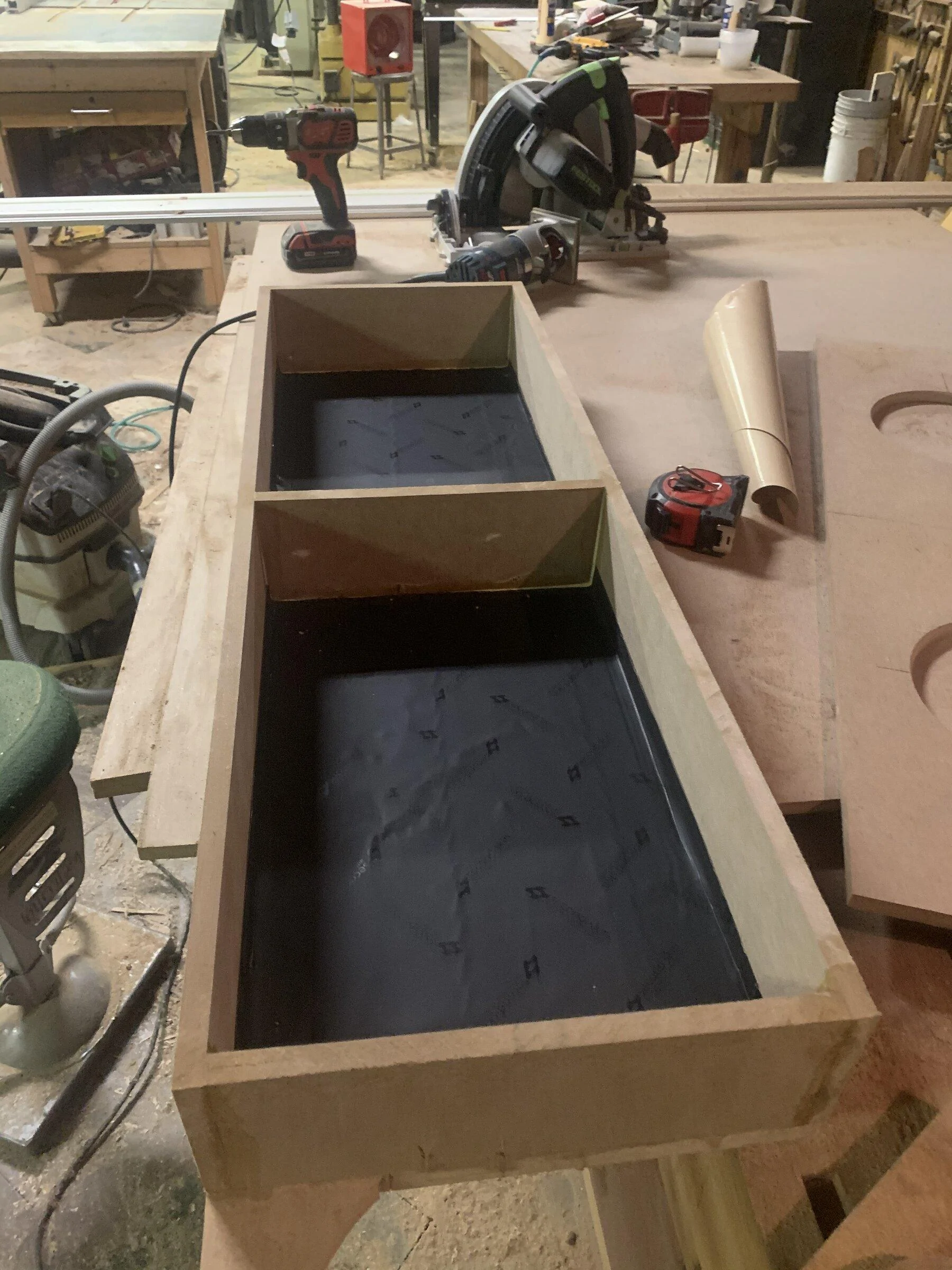

Replacement rear sub box. Will sit directly on top of stick box and be trimmed in.
Running 2- 8” mid bass @ 2ohm giving them 300 watts each in .55 cubic ft each.

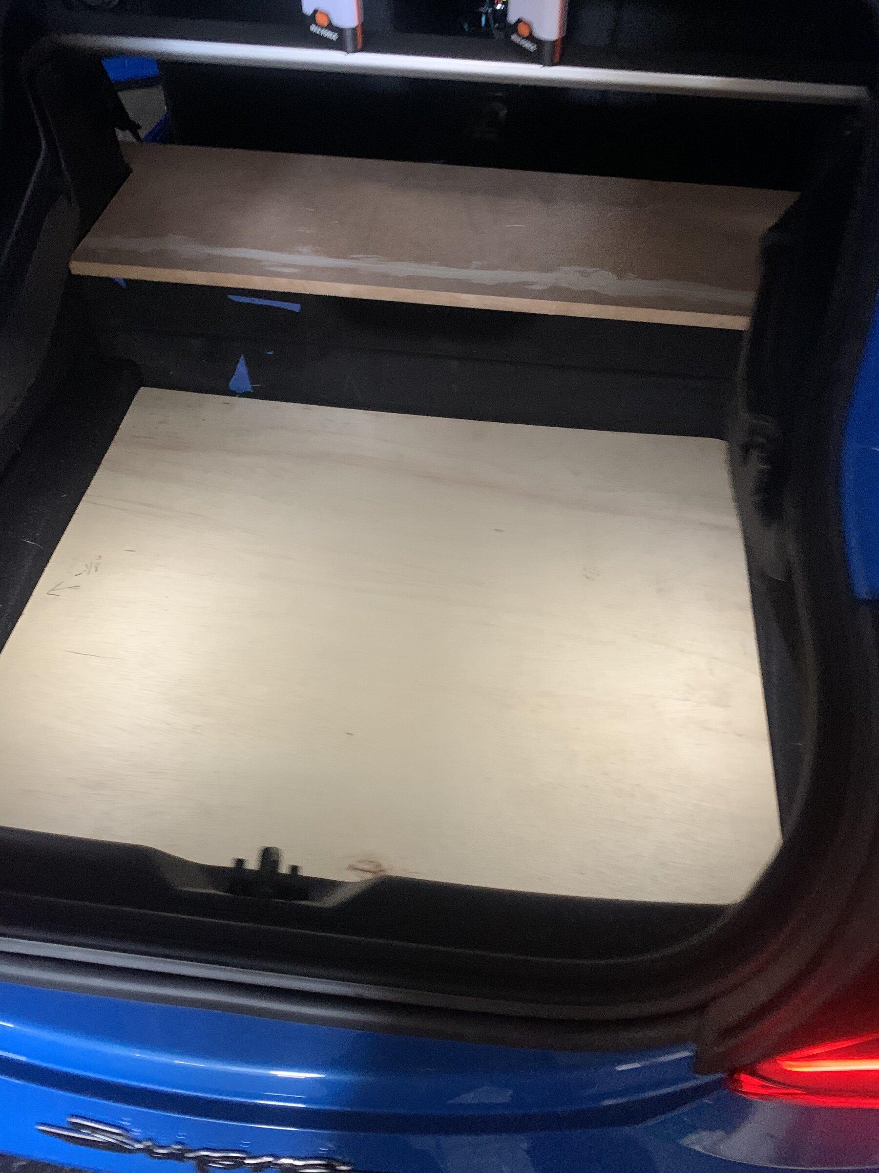

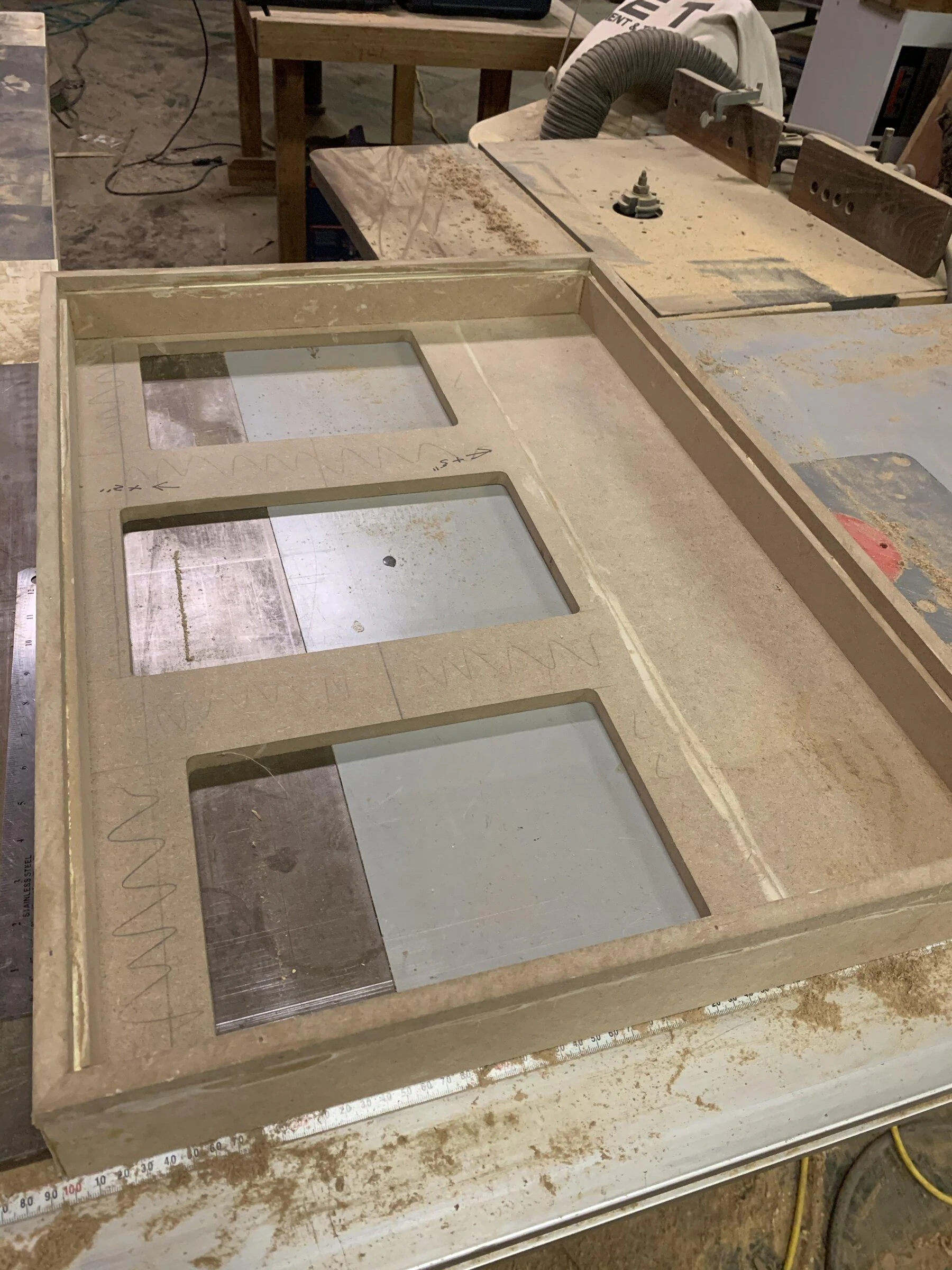

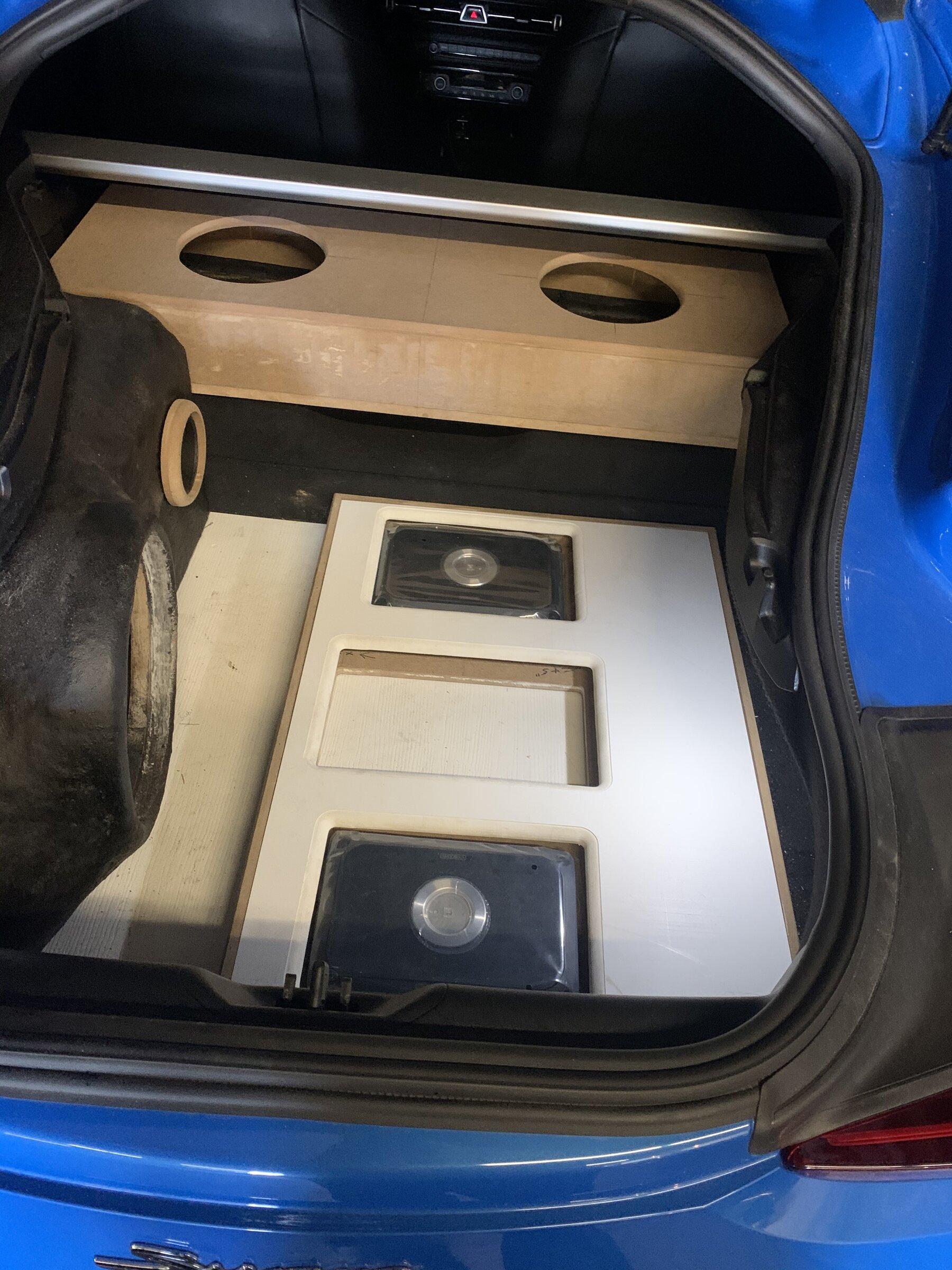

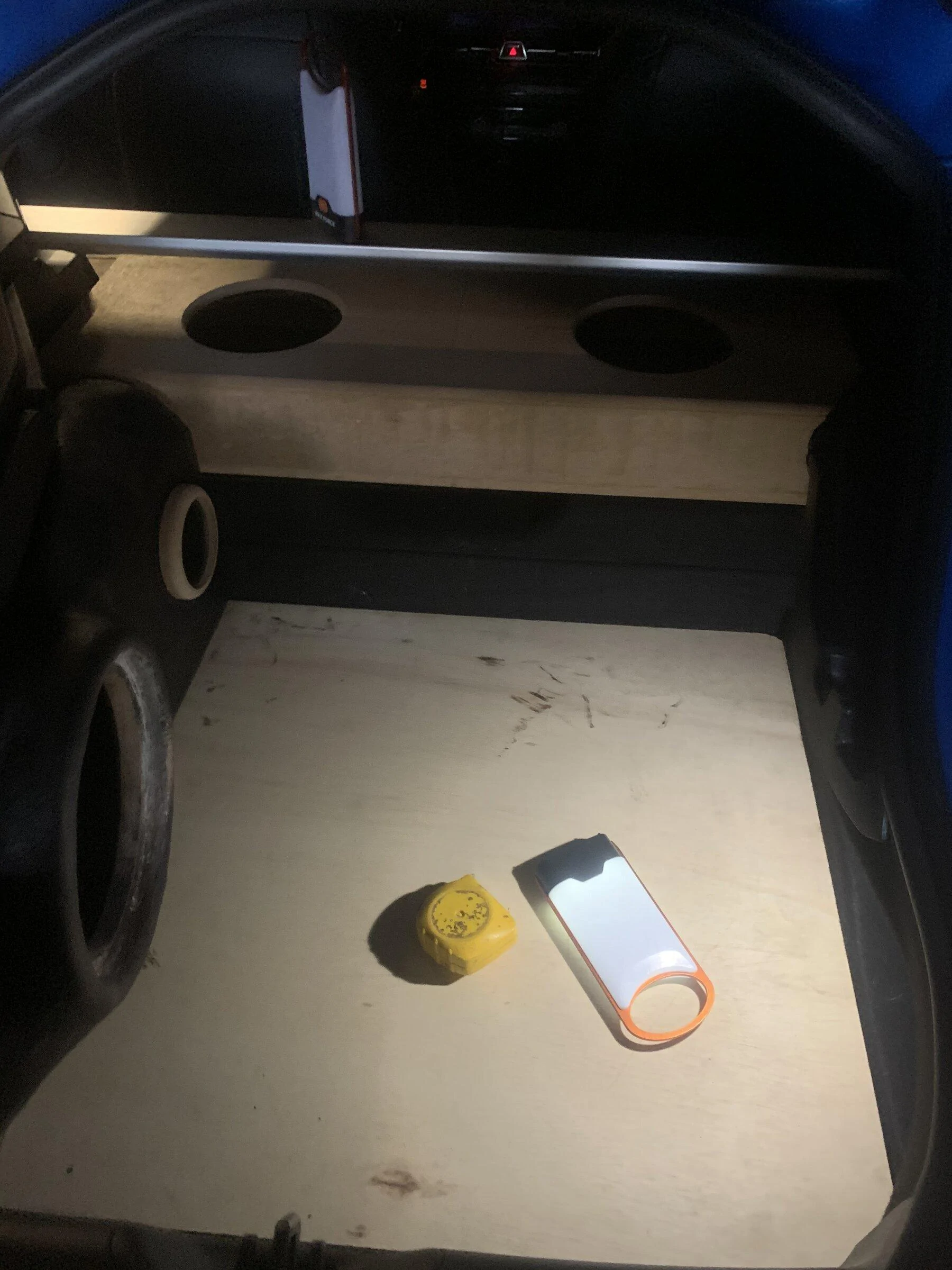

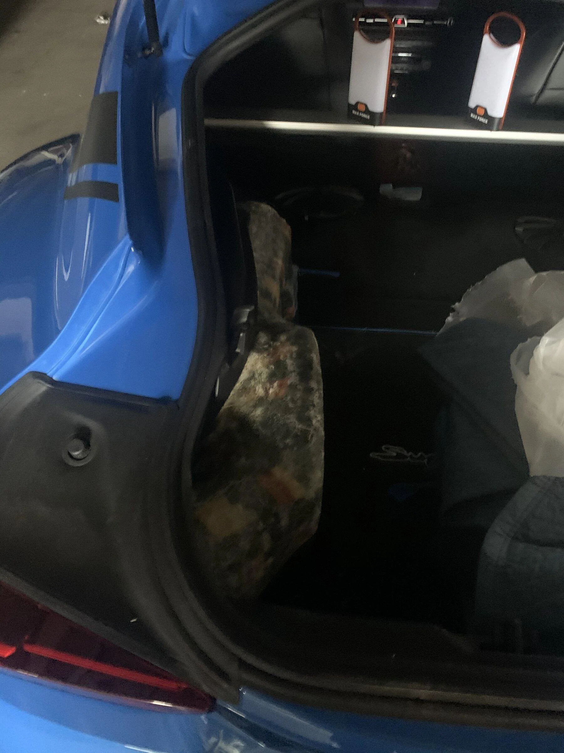

Some updates. Working on false floor and amp rack. Amp rack will hold 3 amps, large distribution block, and DSP hub
