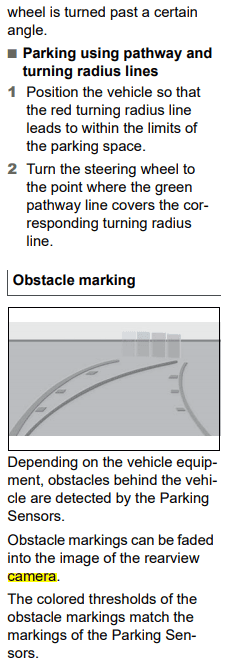

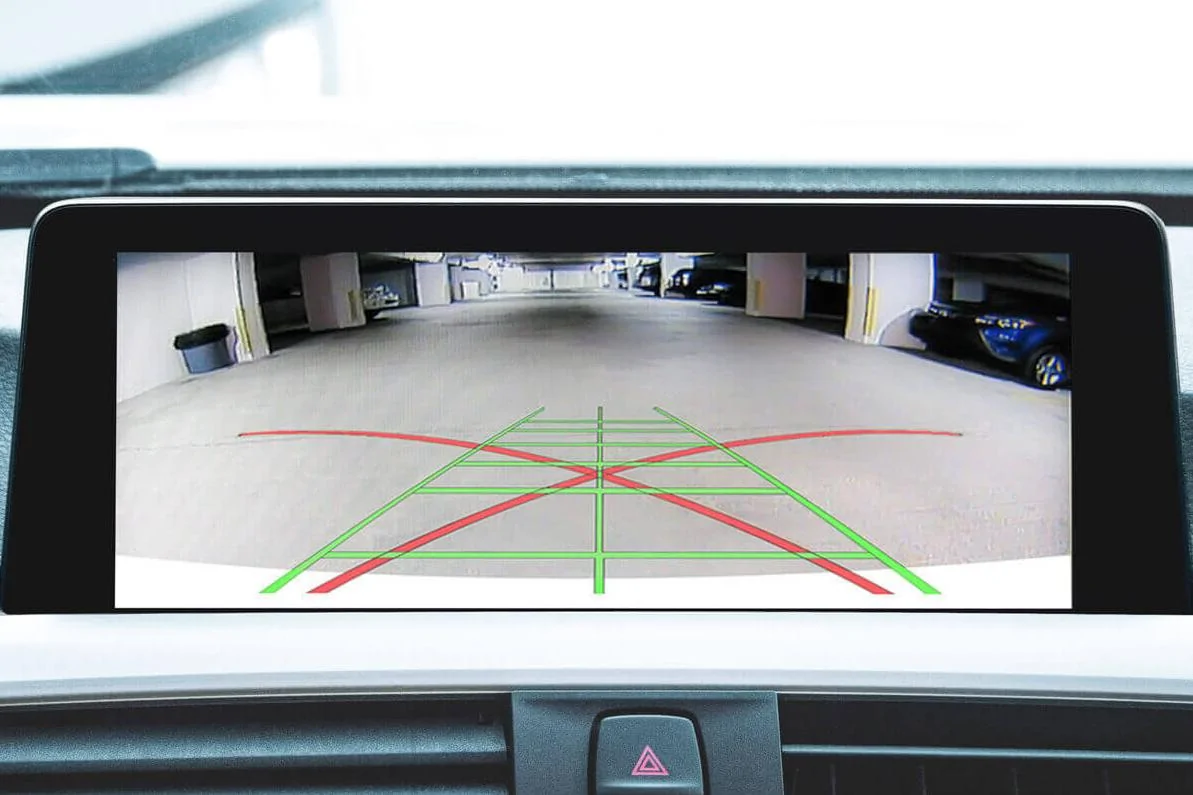

Can anyone help me interpret the back up camera. I dont understand the curved red lines. Im used to a straight red line on my highlander that i can tell how far from an object. And the supra puts itself in park when i try to open the door to look back… thanks in advance.

Interesting that yours looks different to mine. Maybe all 2.0 look like this? But to answer your question, the red lines are the max curve lines. You should have an option to increase the camera angle (so it looks more to the floor) and helps you get closer.

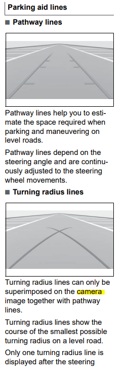

Yeah, Sorry for the confusion. I just pulled this off the internet, but is what my camera set up is like on the 2.0. I dont have parking sensors. But based on the excerpt from the manual, it looks like the horizontal green line where the red lines intersect is what to use to gauge distance for objects behind. Does that sound right?
